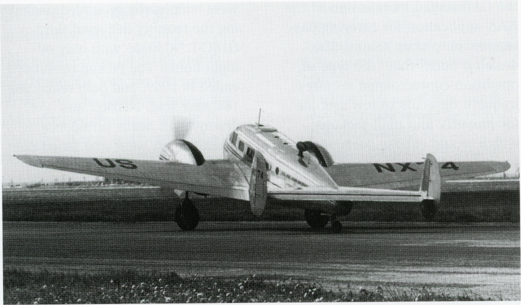

File comment: All American Aviation developed a crosswind landing gear that is shown here on C18S NX74 of the CAA. It was a demonstration flight at Idlewild Airport, NY in May 1948 and a close look will show that the landing gear is aligned with the runway although the C18S is not. (Wm. T. Larkins)
In 1947, [All American Aviation] developed and tested a castering crosswind landing gear on a CAA C18S NX74(2), under a research project contract with the CAA.[11.46] The assistant to the Administrator for General Aviation Development of the CAA, John H. Geise, had initiated and directed the investigation of the landing gear, resulting in the CAA/AAA contract. This research was done to determine the need for multidirectional crosswind runways. The gear was successfully demonstrated at Washington National Airport, D.C., on April 15, 1948.[11.47] One month later, a demonstration was given to the Aviation Writers Association in New York City.
The gear's purpose was aiding crosswind landings; the AAA tests were successful, demonstrating that multiple runways were unnecessary. A cost analysis proved that all aircraft then in service could be modified for crosswind operations at a fraction of the cost of building crosswind runways. This led to the CAA Administrator adopting a policy to restrict federal funding for construction of runways specifically for wind coverage. This saved millions in the Federal Airport Program, and Geisse was awarded the 1950 Department of Commerce Gold Medal for "outstanding contribution to the public service and the nation."[11.48]
On January 14, 1949, the crosswind gear was transferred to another CAA C18S, NX219, and six months later it was removed due to "defective clusters on the main spar."[11.49] After leaving government service, Geisse continued to work on crosswind landing gears and "invented and patented an entirely new type which was much simpler, less costly and lighter than any then available. The new type was manufactured under license by the Beech and Cessna airplane companies for both civil and military use."[11.50] The Geisse Safety Landing Gear was offered as an option on production Beechcraft E18S in 1956, and in kit form for use on earlier E18S and D18S aircraft.
[Emphasis added]
