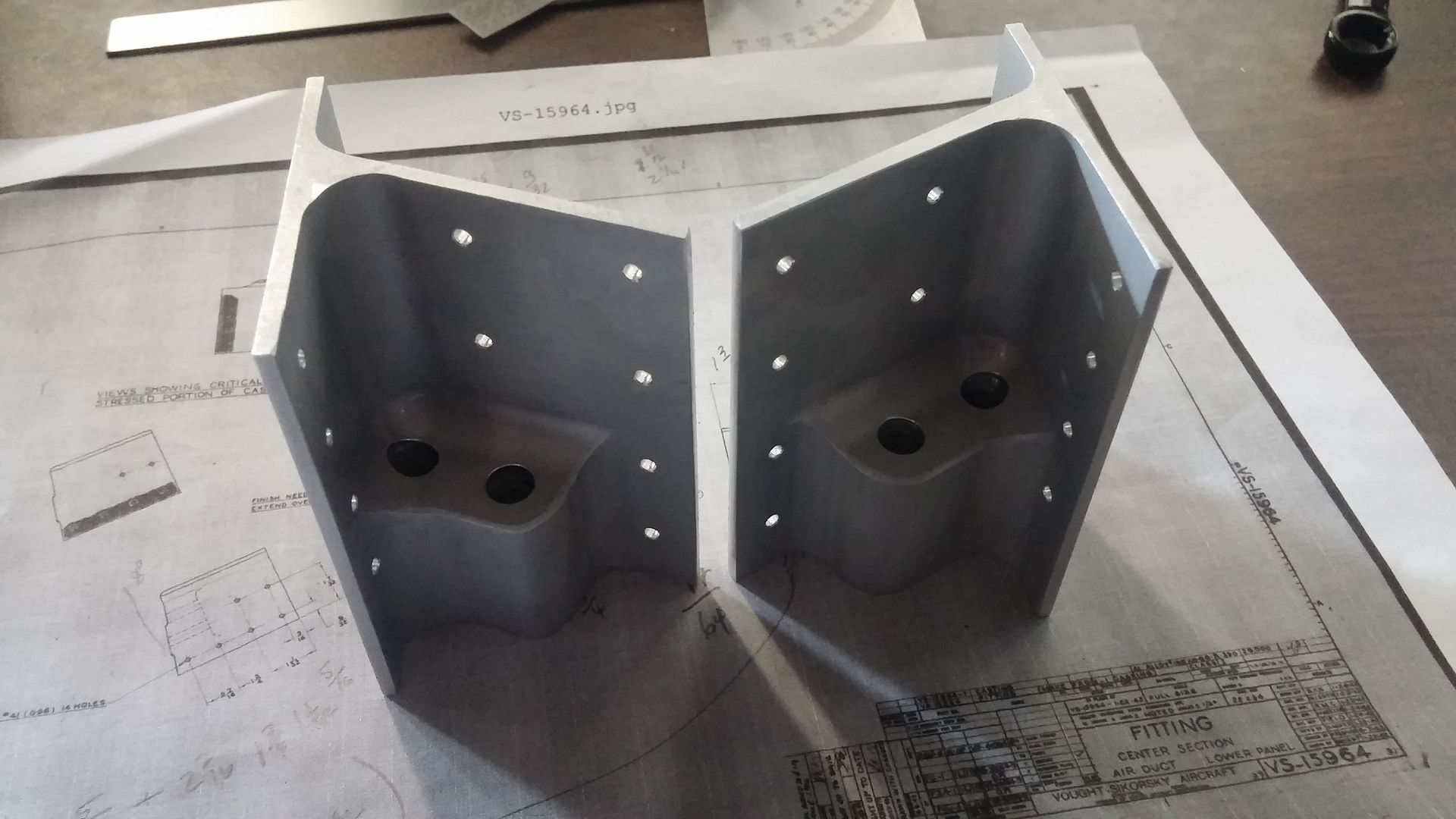

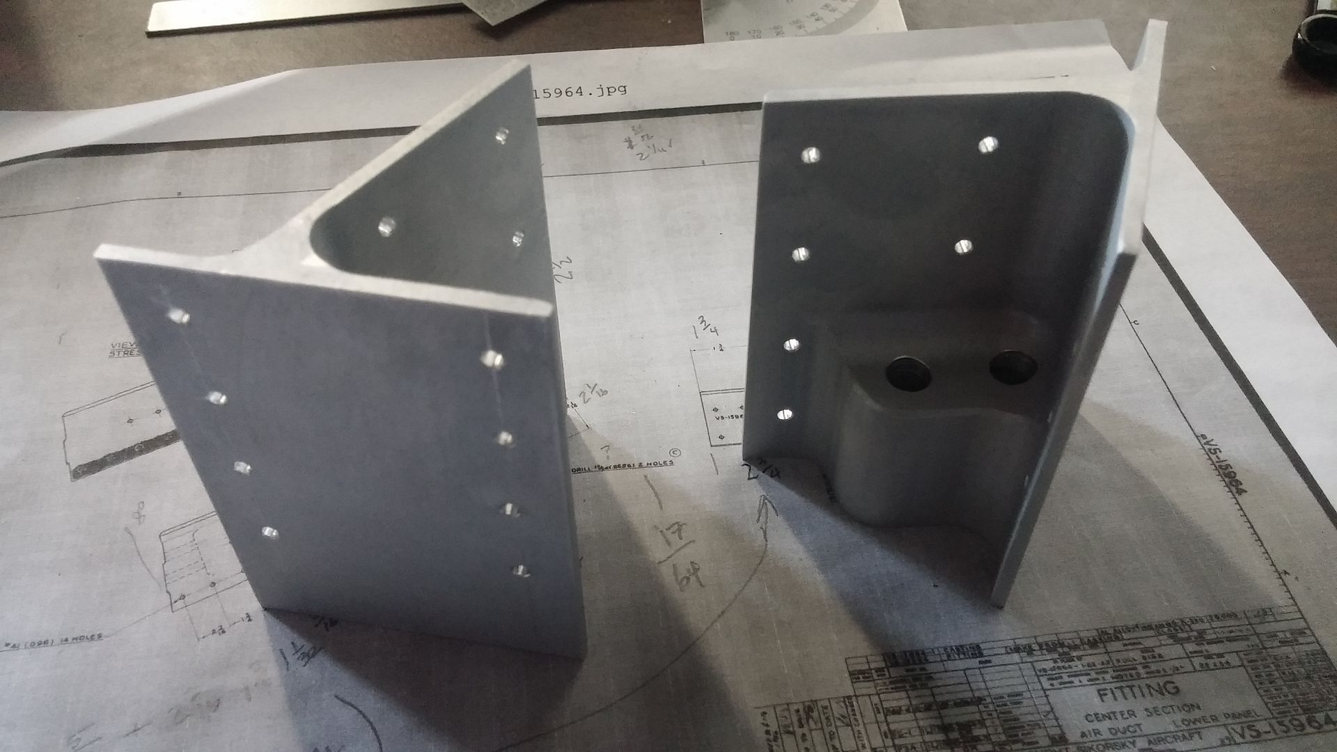

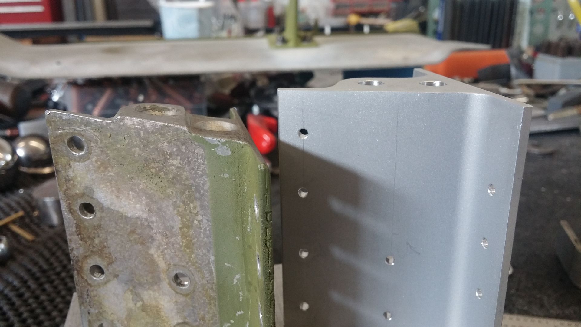

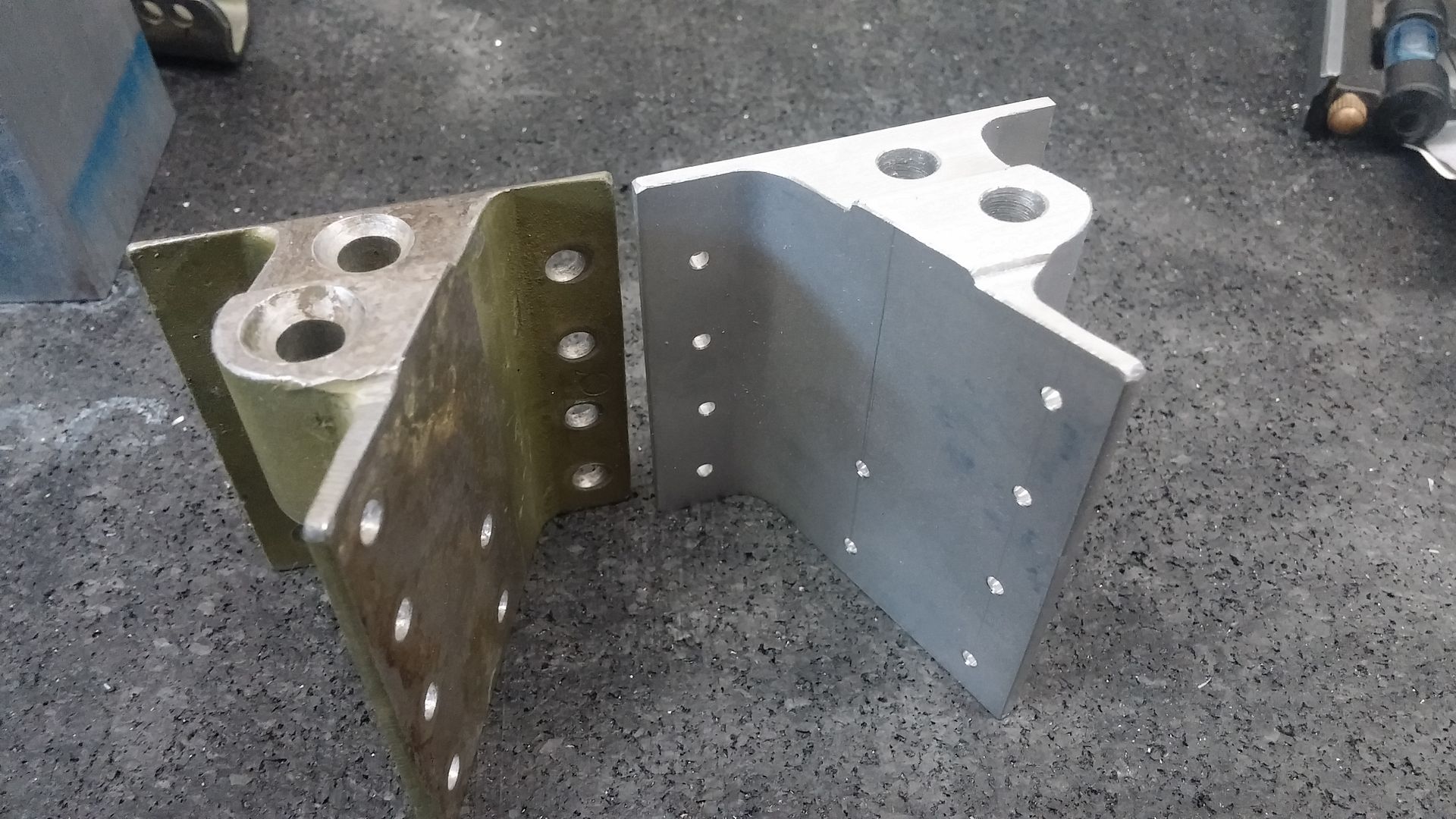

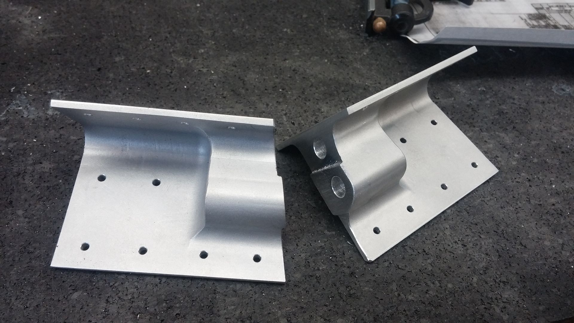

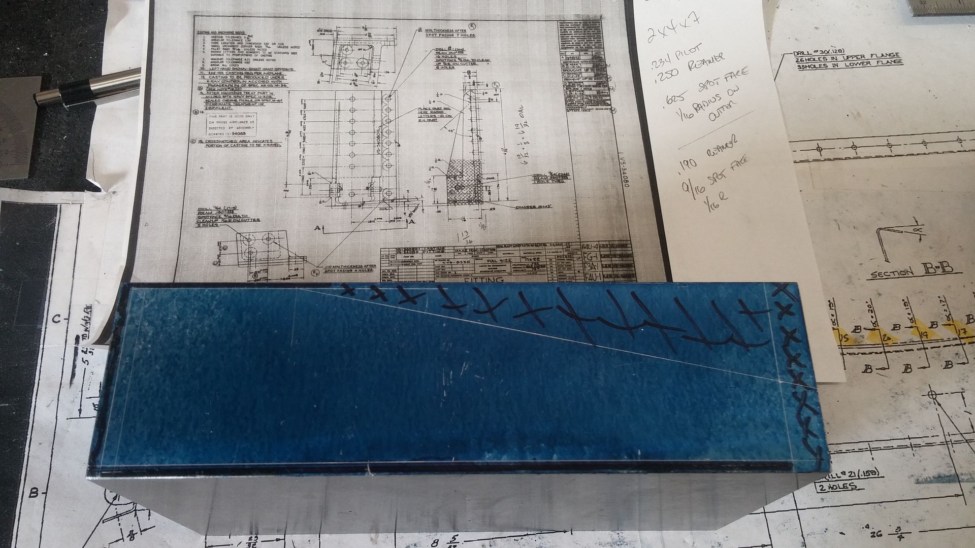

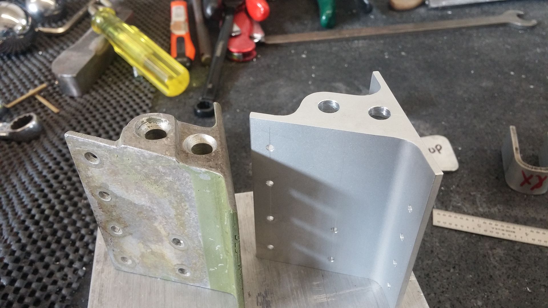

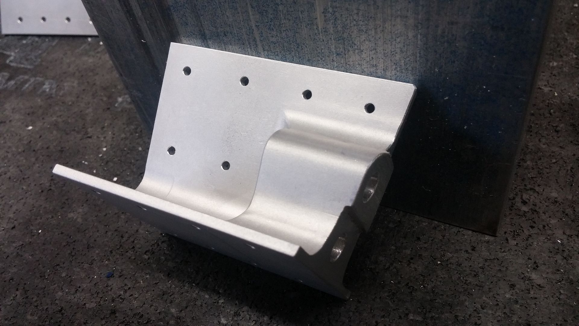

OK, enough already...Seems this chip making "career" is over with the exception of some 100 degree chamfers. Ironically, none of this detail was shown on the drawing other than as a sketch. Had I not had a part to compare to (needs to get riveted back in the donor wing section) I would have been pooched. Happy with the outcome though.
Without the sample, this detail was not available from the print and we would have been pooched.

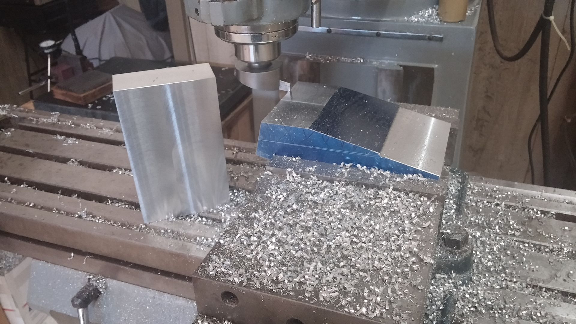

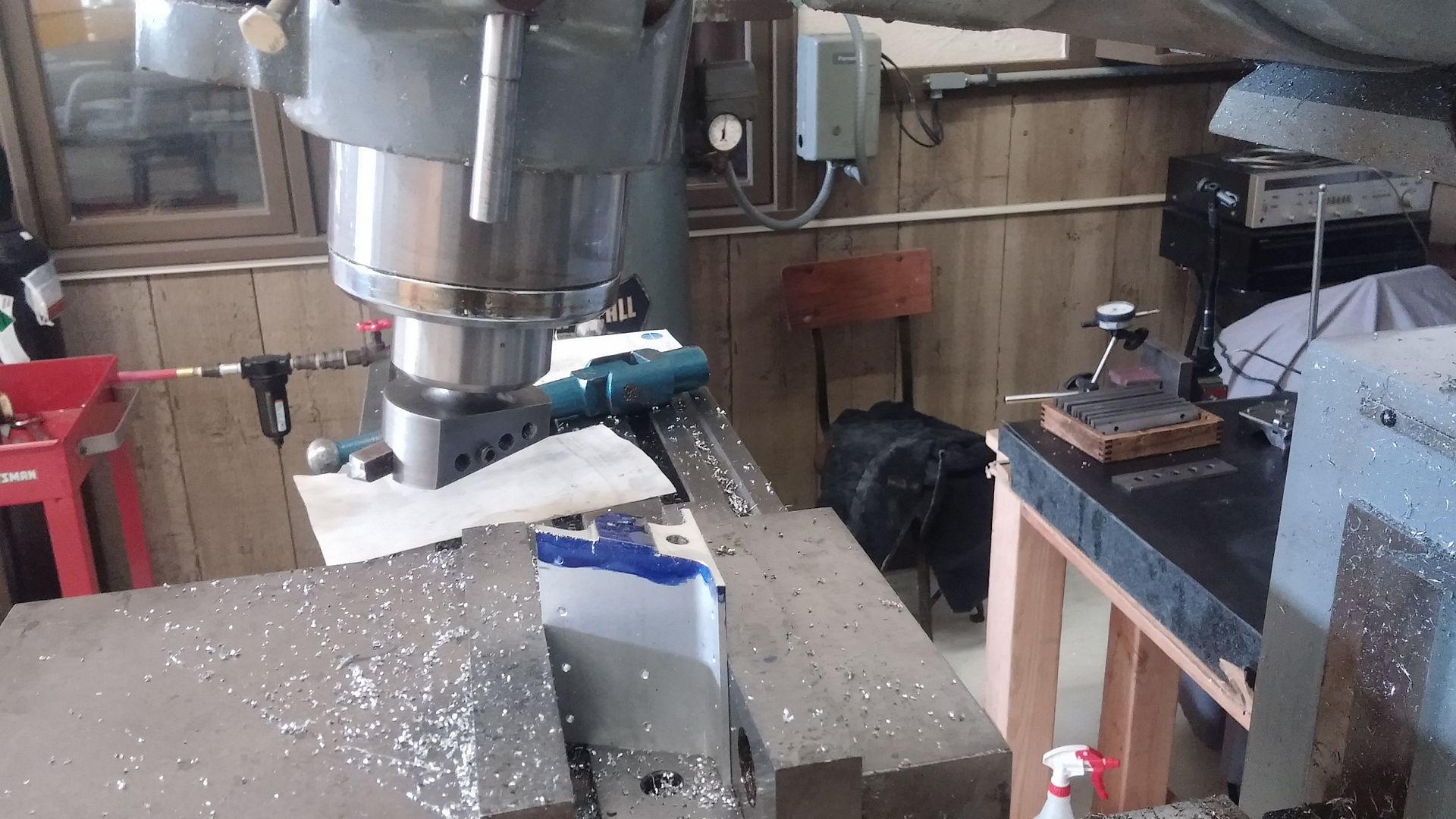

Kicked the head over 8 degrees and used a fly cutter

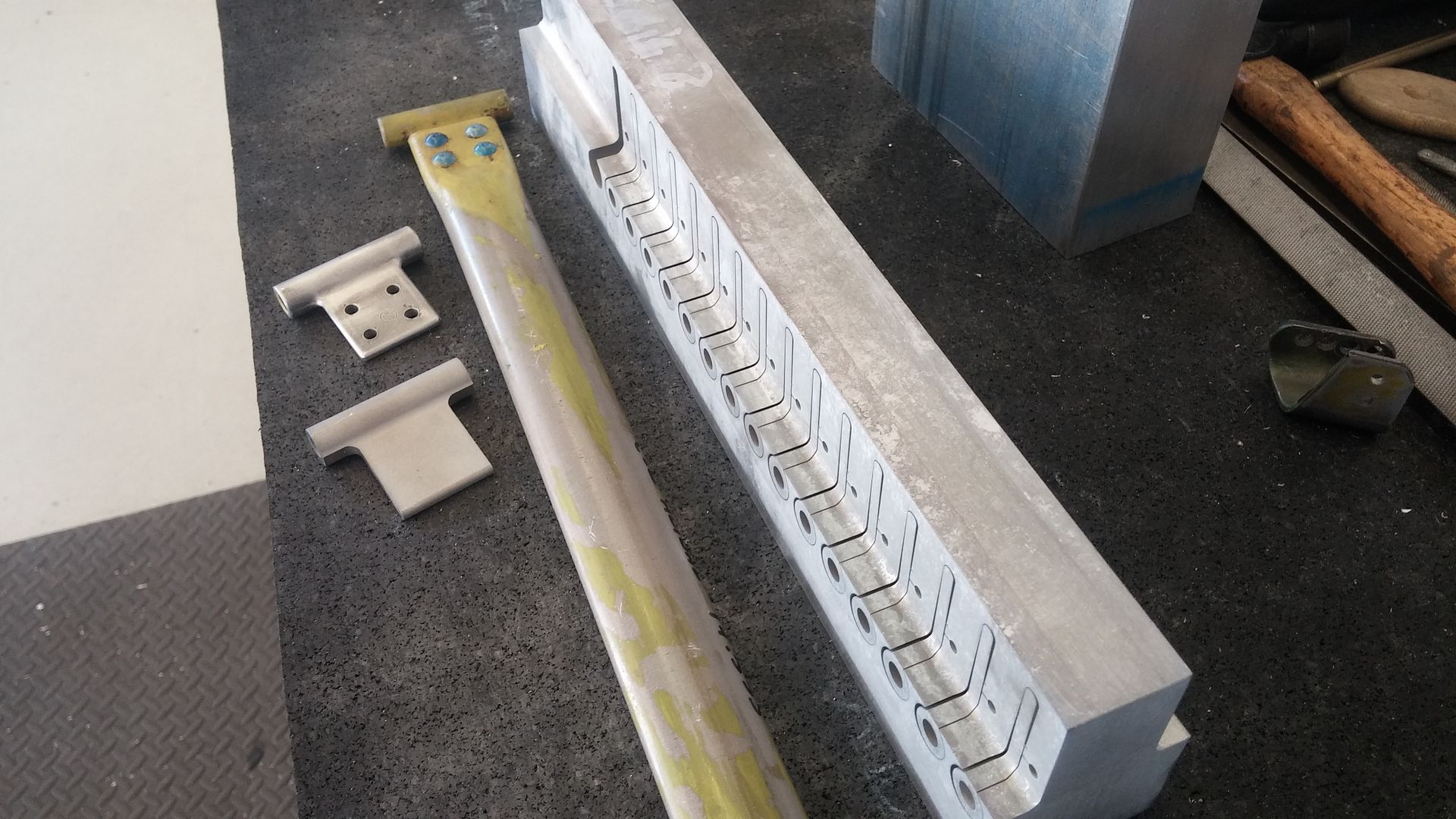

So, it pays to have friends with EDM capabilities. These are fittings for the elliptical tube struts that strengthen the center section airduct rib.
Then we need to deburr and fit to the actual tubing

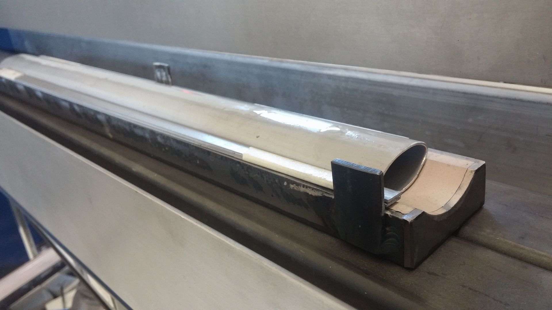

Also need to finish the elliptical tubes formed from furnace annealed round blanks
Die set in the press
No longer round
