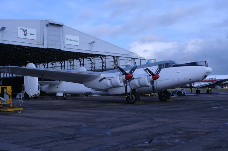

Well, we finally got lucky with the old Shackleton, being given some hangar time to get the painting done (more of which later) thanks to the kindness of Classic Flight at Coventry. They moved several of their collection out into the cold for a few nights including this funny looking US built thing:
Howard 500 N500LN...
Anyway... back to things with the proper number and arrangement of engines.
Wall to wall sunshine over the past few weeks let us make progress on the prep work for the paint, and not a moment too soon. All the team have been working from dawn to dusk every day they can - with some of the guys going to the airport in the evenings, going away from the aircraft exhausted but happy.
963 was made ready for moving (she has to shuffle over a bit soon anyway to make room for DC-6 G-SIXC to get past into its new position) the dates for the hangar being set at 24 - 27 March. We were to have a a four day paintathon, the intention being to only have roundels and stencils left to do afterward.
I thought I was prepared for it... I really wasn't. From the first e-mails last night saying 963 was in the hangar a day early, everything went nuts. I loaded up the car with as much painting materials as I could the following morning and set off for Coventry, eager to see what was going on there. I couldn't believe how busy the place was... it seemed as if everything was being worked on at once. Classic Flight/Airbase's second season is going to be a cracker.
The paintathon..
Arriving to find everything sunny and bright I made my way over to where the Shackleton now wasn't, to drop the paint supplies off. I'm sure this was where we left it?
Best go look inside then. There she is!! Asking around the place and a figure of 17 years was arrived at since she last saw the inside of a hangar.
Two of our guys were already hard at work starting to mask up the windows and cover the floor, as was requested of us. The team are all in good spirits, even when asked to unroll the plastic floor covering again (and again) for the camera.. :D
The ground handlers were superb, putting 963 in the hangar bang on the centre line with barely feet to spare on the wingtips. This is how close it was:
As you can see it's a snug fit.
Helping out with the masking, I had to take this shot, as it was too good to miss:
The DC3 was started up later in the afternoon outside, and made a really very pleasing amount of noise. :diablo:
Being at the west end of the hangar meant we got the sunshine for longer, which was rather nice. 963 looked that happy in there it was rather tempting to let the tires down so we don't have to move out, squat in the aircraft, or just paint a line on the floor that's Shackleton shaped with a "reserved" sign on it...
Saturday we worked long into the night, pausing only briefly for food and once in shock, when one of the female members of our painting team dropped into conversation that she was a pole dancing instructor... :eek: :D
Unfortunately we got beaten by time, WR963 wasn't finished. Various small leaks caused problems with contaminating paint.Then the paint we had for the roundels/fin flashes started reacting, so they were redone the following week. Luckily we noticed it after the first fin flash, so we didn't have to worry about any large areas. We overestimated the need for some colours, and underestimated others, but on the whole she's about 90% done.
These last two were taken right before we left.
WR963 was pushed out on 30th March, after 7 days indoors, and some of our gang were down there to see it happen. Still a bit more to do, but this picture was too good not to miss.
Two weeks later and other than the long standing issue of No 2's propeller, she looks smashing. I'm not going to post pictures for now, as we've decided to try and roll out the finished article for Airbase first day of business this year, so we promised to hold any photo's until then..
963 now wears the national markings, her squadron codes and emblems. The stenciling is getting done, and we'll have the most noticeable bits done by the time the public see her for the first time. Walkways, drain points, emergency markings... even in plain white and grey a Shackleton is a colourful beast up close.
The only pain with the paint is the underwings - despite best efforts, it's still slow going under there, so she won't be wearing the underwing serial numbers for a couple of weeks yet. The biggest reason being while we stopped things leaking into 963, there's still a few leaks out. We'll get to the bottom of them though.
In terms of crew numbers, we had around 20 people working on the Shackleton over the painting weekend, which is kind of a record for us. Even the elder members of the group can't remember seeing that many people working on her in the 12 years that she has been in their care. It's all good as the average on a normal day now is between 10 and 15 members, making large tasks that much easier. The ever growing "list" is now being fought to a standstill, and within a short time it's going to start getting smaller.
We've had two of the badly clouded cockpit quarter windows being replaced with newly manufactured ones. We still have a lot of the glazing to replace but it is getting done bit by bit! The gunners window and the astrodome are going to be a bit more of a headache, but they will get done.
We've had some new flooring going down inside the aircraft, it's not the original (does anybidy know a source of the proper stuff?) but it stops the inside of 963 being so much of a trip hazard than it was. When I say 'Trip hazards' that doesn't include the wing spars... everybody takes their own chances there!
As I mentioned earlier, all leaks and weeps are being investigated, one showstopping item being found in the engines priming lines - a couple of perished gaskets which would have produced a really nasty engine fire had they not been spotted. They have been changed and to get preventative, the same job is being done on the other three engines.
One of the fuel tank cocks on the port side is leaking, so that has been added to the list of tasks we have to sort out before running engines on that side. We have four tanks in each wing feeding into a five way manifold, so it should be fairly straight forward to figure out which one it is. We've already been in behind the engines once to fit new cut off solenoids on the priming lines, and fuel pressure senders, so we can be more accurate with priming and reduce the risk of fire.
Some other leaks are going to be more fun to sort out - a bomb bay ram has started weeping slightly which is going to need attention, but we're not sure if it's just misbehaving due to lack of use. The system is holding pressure well, the bomb doors being hand pumped shut the week before the hangar time, and so far the only thing that has happened is the port door has crept open a couple of inches.
The undercarraige oleo legs were to have been inflated but it appears we may have a leaks on the oleo legs themselves. This means an undercarraige leg swap if we can't get it fixed in situ.
None of this work worries us, for two reasons. We have a can-do attitude to the aircraft and if we can't find a way to do something we will find someone who can help... which is why we've been bugging anybody in the UK that has built Shackleton propellers recently!
The other reason is that in a small room off the hangar is every drawing that exists for the Shackleton, all the mod details, and God knows what else. It's a treasure trove. Apparently we hold the design rights to the aircraft now, having all the master copies of the drawings and prints. There is a phenomenal amount of information in there.
But, with all problems that crop up, she's an old aeroplane so we can forgive her.

7th May
A wet Saturday down at Coventry but a reasonable days work. Two of our guys are busy at work cleaning and repainting parts of the interior, a couple of us went leak chasing and the pneumatics should be back before long.
Leaks:
First up... the heavy rain has shown we have some more work to do. The prolonged dry spell has dried out more of the old mastic around the cockpit canopy frame and the beam lookout windows. We have water dribbles! The next fine day will see it sorted as we'll dig all the old stuff out and put new in.
More worrying was the fuel leak. When we shut down we found the priming overflow on the starboard side was still chucking raw fuel out - but with the pump off. Initial thoughts were that I had overprimed during the start, but not so. The supply line into the fuel priming pump was weeping fuel. We got it off the aircraft today and this is the state of it:
It caused a few sharp intakes of breath when we took it off. It must have cracked to the point of failing on this last run. Typically this pipe is hard to see hidden behind the air intake and outlets for the generator, so you could only feel it rather than see it until it was off. I'm not convinced its the original pipe, I think its a legacy from 10 - 15 years ago when Air Atlantique were using her as a test bed.
So, from now until we can get Pirtek to come visit, 963 will be a bit quieter than she has been for the past month! All being well she'll be fit and well by this time next week
The air bottles came back from testing today, with all the NDT, x-ray, ultrasound, and boroscope testing done. Four bottles passed, one bottle failed with the wall thickness down to less than 1.6mm and metal flakes seen on the x-ray! Luckily for us we only need four, but a good job we sent the spare too.
The props are currently across the other side of the airfield causing much head scratching at CFS, as the last ones they did were in the late 1990's for the AEW2 that went to the USA. I should have more news later if all goes well - but we have to admit things have slipped a little with getting this sorted out.
14th May
Windy again at Coventry, but dry!
Plenty to do on 963 though to get her even better and keep her in good condition for the coming season. Vic and Rich Marriott are making immense progress on the interior, I couldn't get photo's due to getting in their way. When I left Coventry at 4.30pm they were still hard at work, somewhere near the galley. Repairs to floor matting and the bunk area were happening last time I looked.
Pirtek when phoned arrived at the airport within the hour (the guy on the phone asking "Is it the old Shackleton again? No problem!") and when we gave them the old pipe we had a nice shiny new one produced inside 10 minutes. The old spec of the pipe isn't available any more so an equivalent was used.
Thinking about it; there's now enough non original parts on this aircraft to give the CAA and anyone else a field day if it had to be audited for flight. But as it's probably not going to happen we can use slightly better materials without getting it approved. Hopefully the work we're doing will keep the Shackleton 'live' for a good many years.
With the new priming line fitted, it was then just a case of switching the internal power on, selecting fuel tanks and master cocks for that side, and turning the priming switch to No 3. The pump hummed away with no nasty noises and no leaks... so 963 is good to run again.
Feeling happy with our success we moved on to what would have been last weeks task - the refitting of the air bottles in the pneumatics crate. Myself and Pete Curran took this job on, and braving spiky little bits of safety wire and stiff air hoses, we had the bottles in fairly quickly.
There was a little bit of head scratching to figure out where all the joints ran to avoid chafing and rubbing.
We than fed the bypass pipes fitted to the oxygen cylinders (as they have been used in the past for extra capacity) back into the crate and gently opened the taps.
Hissing noises were heard and then port and starboard pressure gauges started to climb! There is a small leak off the bottom pair of cylinders, and what little pressure we had bled away fairly quickly, so we'll test the whole system from top to bottom next week. Volunteers were called for and with one man standing next to each wheel, one down in the nose near the crate, and one in the pilots seat; the brakes were pressed. Port brakes took up and then vented nicely, starboard took a little more persuasion, finally coming on with a drawn out creak and then a puff of years old brake dust out the sides! There didn't seem to be any sudden great loss of air, so it appears the brake bags are still intact.
So... 963 now has her brakes back. We need one more propeller and then a mainwheel tyre change, then maybe we can show her the runway again...
The propeller - this is a long standing bugbear, however it is now in the workshop being built up. It appears we're missing an intershaft bearing and seal, so it might take a little while to find those. Other than that everything seems to be okay on that score.
Next we decided to have a crack at removing some of the stiffness from the throttle linkages. Well, that was the excuse. In reality all of us have been itching to get those front doors open and see what state she is in, in one of the places we haven't been for a while. Well we weren't disappointed.. in there we found graffiti from the radar fit, original 50's paint, a couple of birds nests and a lot of work!
You never realise just how big that bomb bay is until all the doors are open, the AEW uses roughly two thirds of it and it seems cavernous at that. We're still planning around the possibility of re-instating the full length doors. There is MUCH more left over from the MR2 than anybody would think, and the position of where the doors were cut makes it look to be a job that can be done over Autumn/Winter. We've promised Airbase that we won't start taking big chunks of Shackleton apart until after show season!
