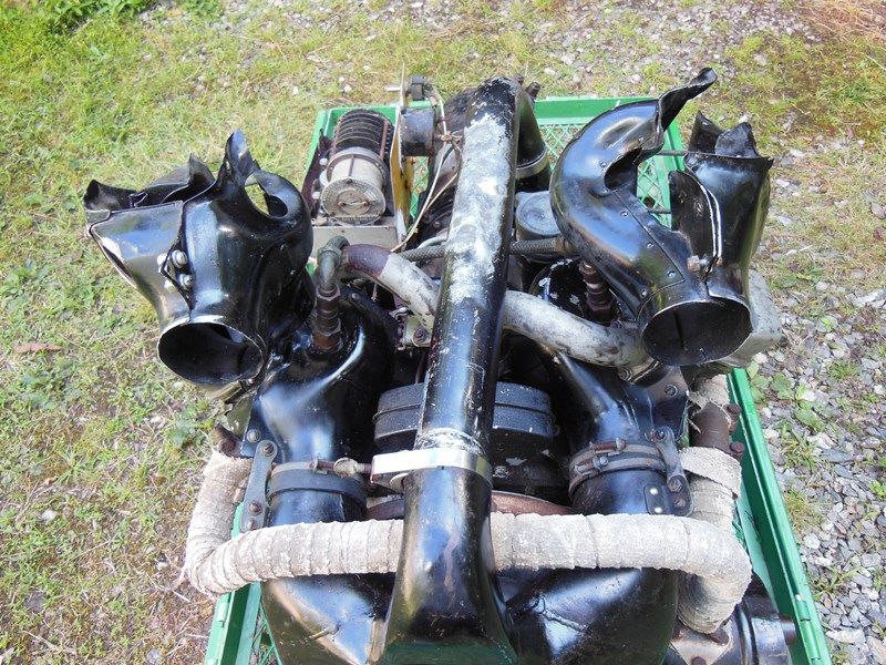

Trevor, fine report on the rebirth of the Andover system. I always got a lot of strange looks when I told folks I had experience rebuilding the Ranger Model V-32 powerplant, as it evokes mental images of something a little larger than life.
If you need some parts for your restoration project, I still have a couple of parts donors here that will probably yield some decent spares. I'd saved about a half-dozen dead ones from a junkyard years ago and have a few left. You're welcome to whatever you need to get both of them back in the game.
If and when you get into that pull-start system, be mindfull of how you take it apart and put it back together. There's a rather powerful and very long recoil spring assembly inside the cover there that's like something from a large and powerful lawn mower. I had one of those springs bitch slap me from one end of the shop to the other a time or two before I figured a way to properly coil, tighten, cage and set the spring in the clutch and housing. You'll swear it's a job for a three-handed man before you get it right.
Your "farm fresh" system looks pretty complete, right down to that pretty exhaust pipe wrapping. The experts say that's friable asbestos, but frankly, with my cholesterol numbers being what they are these days I try to stay away from fried stuff. Much better if it's lightly sauteed in a little butter, or fine weight of engine oil... but hey, that's just me.
Keep at it.
- Robert in PHX

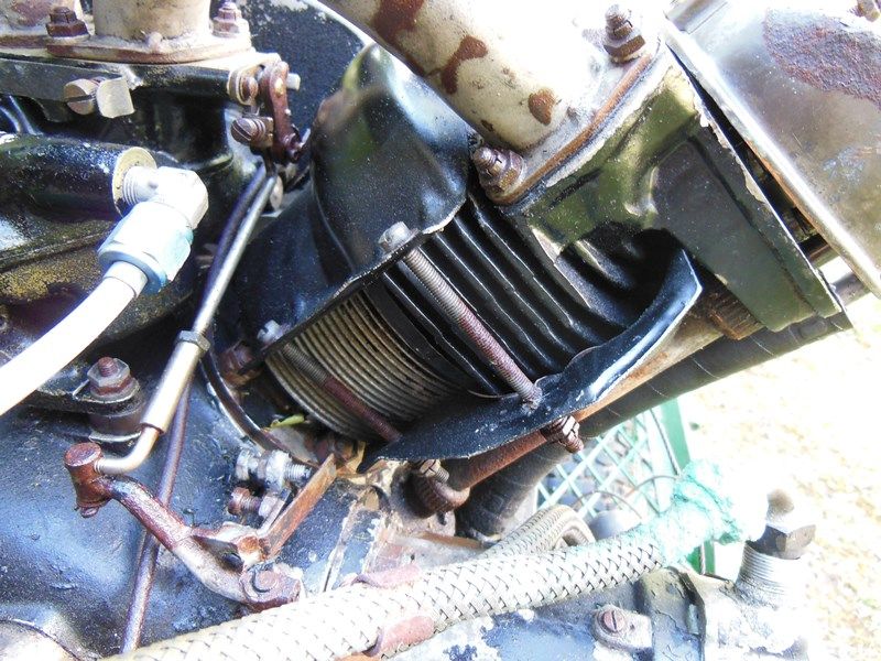

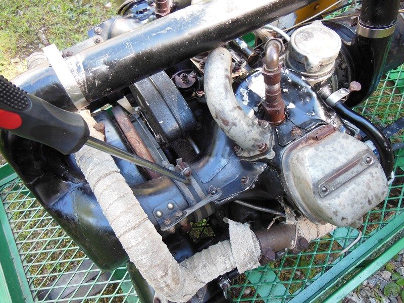

Hey brother, long time no talk! Is your e-mail addy still the same? I dropped you a line a few months back about some B-17 parts.
Yeah I'm not sure what I'm going to do about the pull starter yet, or if I'll even attempt to repair it. It's not something that really needs to be functional anymore, as I managed to rig up, after countless minutes of design engineering and analysis, a way to drill start the engine instead. Eventually I'll reinstall the generator and start it that way, but I remember your stories about fighting with those springs and I'm not sure that I want to subject myself to that same anguish....although, the overhaul manual does make it sound like a piece of cake, ha! :P
For everyone else, this is the spring we're talking about:

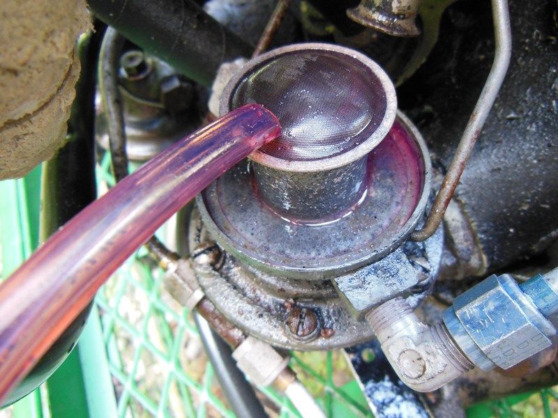

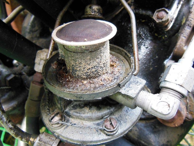

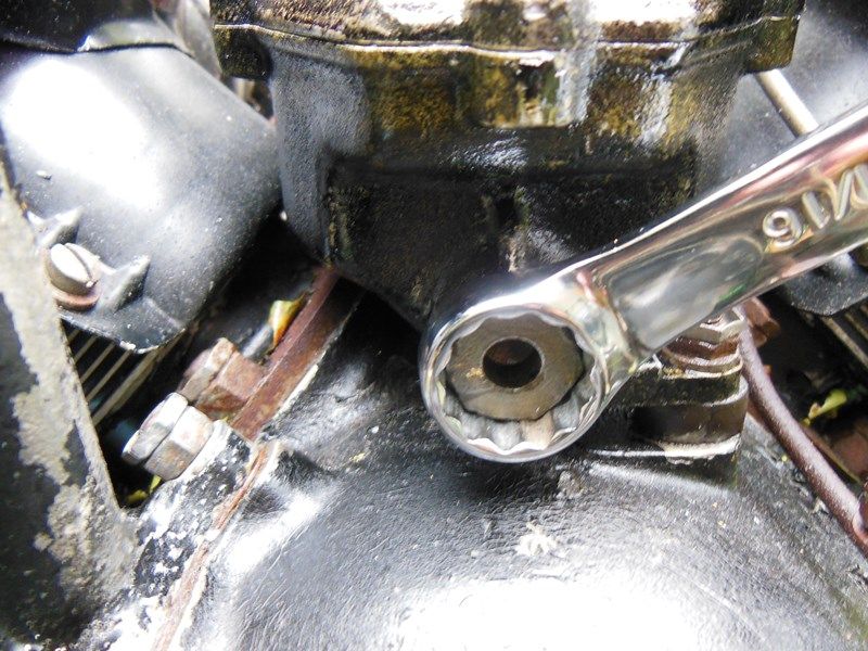

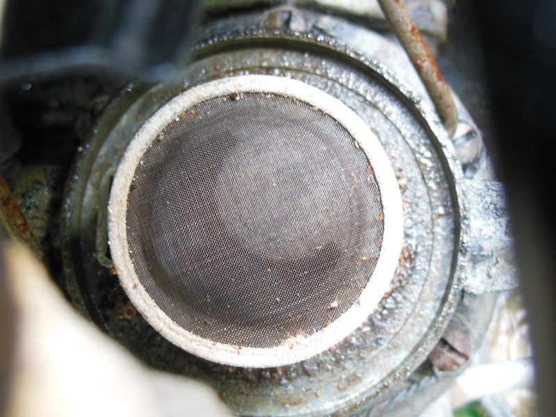

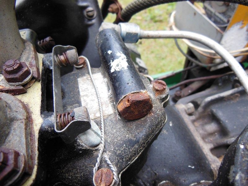

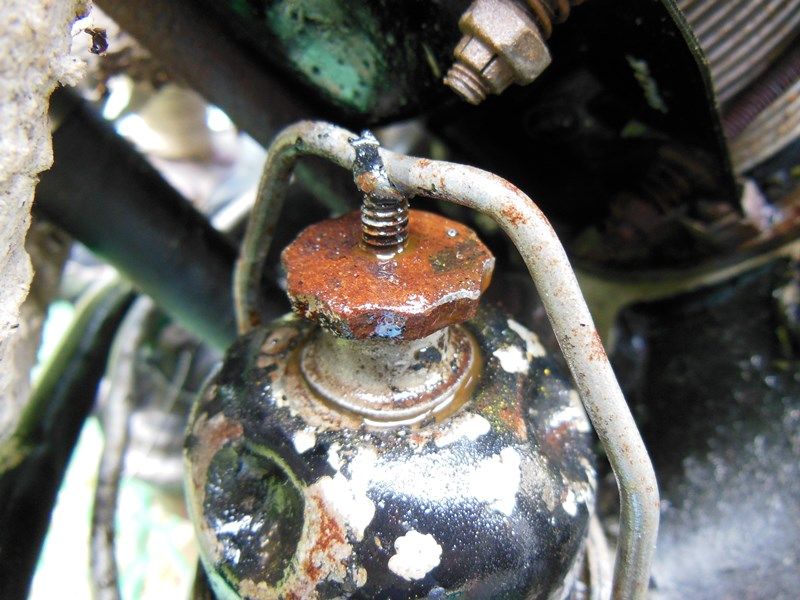

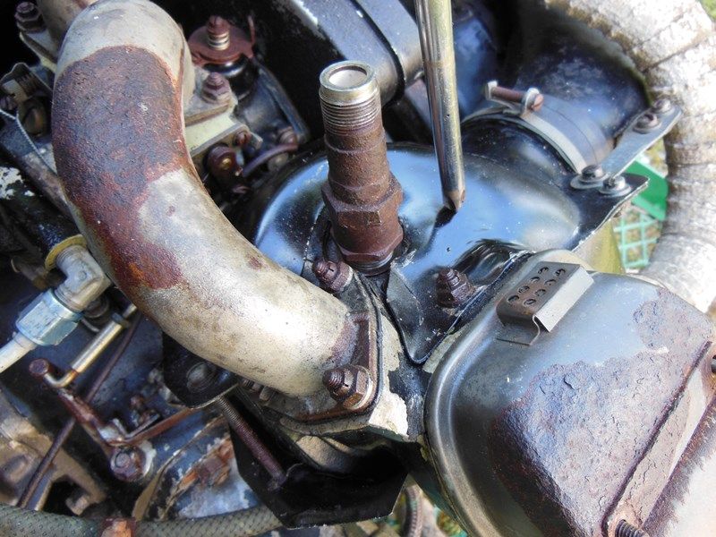

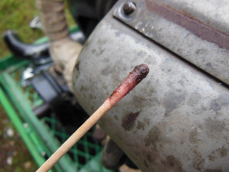

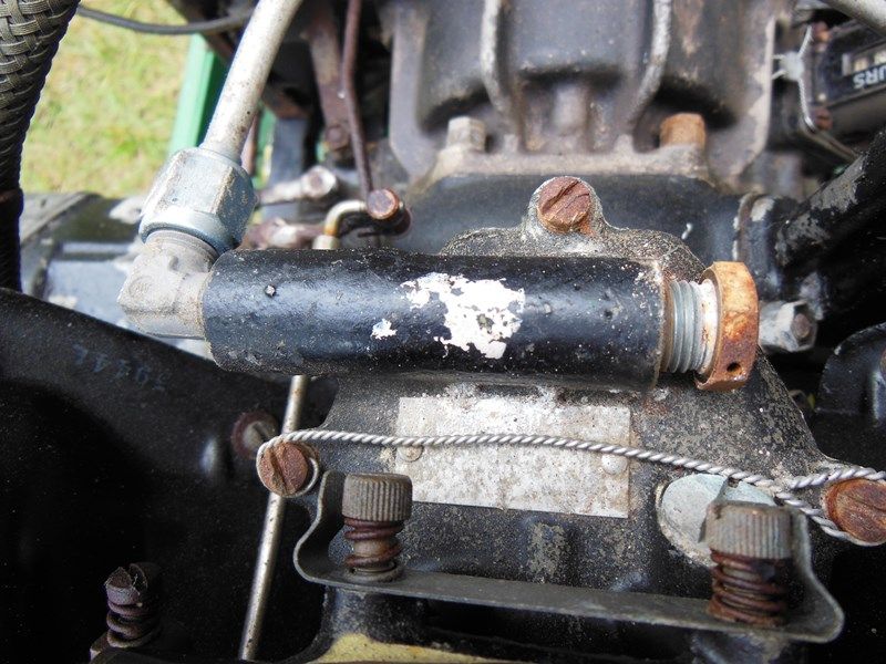

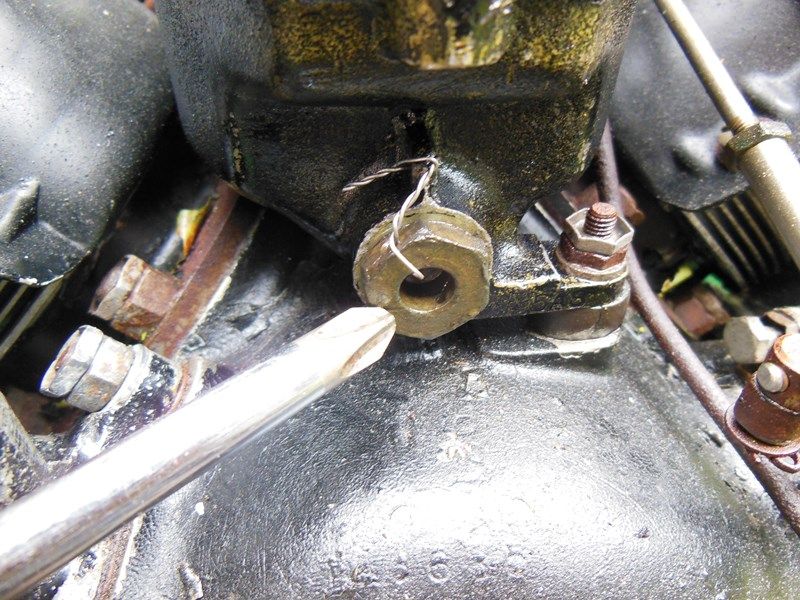

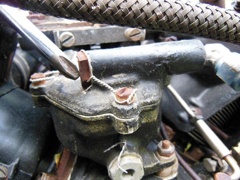

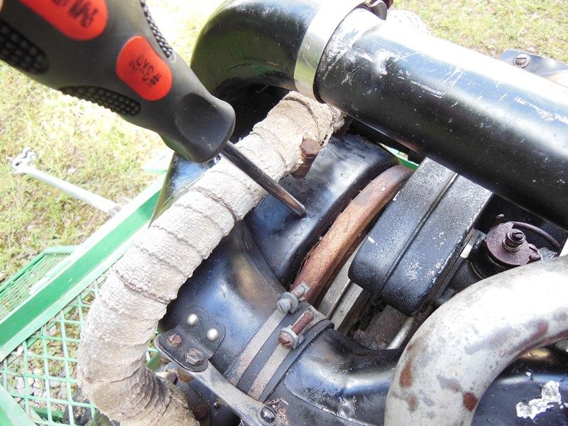

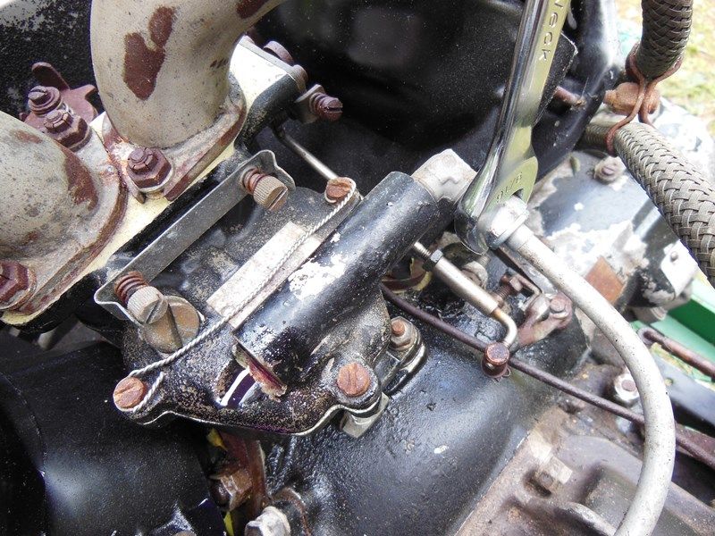

In this installment we're going to start doing some prep work on the engine's fuel system. Let us begin with the carburetor!

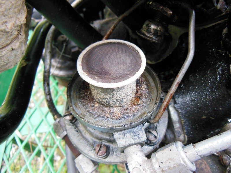

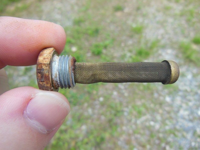

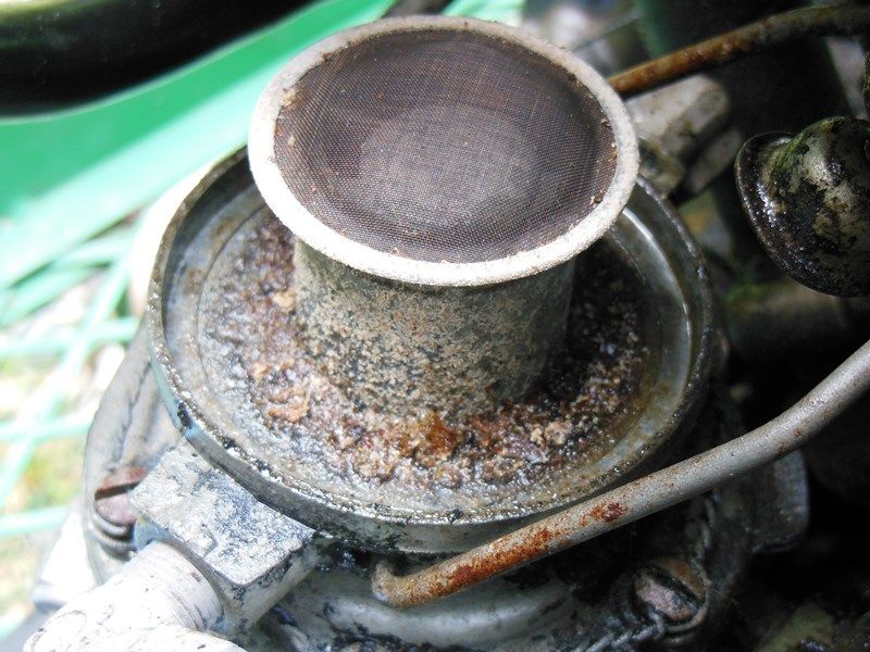

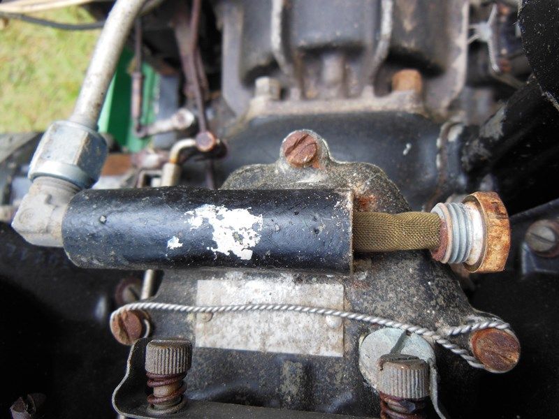

These engines use a simple two-barrel updraft carb, and the first thing we'll do is remove the fuel strainer and see what it looks like.
Safety wire removed, and it's time to start turning. Remember: lefty-loosey, righty-tighty...except in Australia, where everything is backwards! :P
Almost there.
Here it comes..
And the strainer is out! Aside from the rusty head, everything actually looks pretty good here.
With the strainer removed, we'll squirt a little MMO in there.

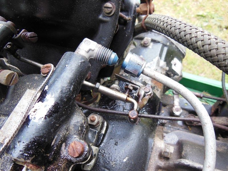

Next we'll disconnect the feed line.
This thing was being stubborn, so I had to give it a few "love taps" to persuade it to surrender :wink:
After 50 years--free at last!
Next we'll reinstall the fuel strainer (after I cleaned it--forgot to take pics of that). Then I'll take the hose on my squeeze bottle and, holding it tight against the fitting, start pumping MMO into the carb. What we want to do here is completely fill up the float chamber (aka fuel bowl) with MMO and allow it to work into the jets, etc. Our concern here is any fuel varnish that might be inside the float chamber. (Fuel varnish is the gummy residue old fuel leaves behind when it deteriorates--nasty stuff!) If the float chamber was not drained after the last time this engine ran, then all of that fuel will have left behind a nasty varnish that can clog up the jets and cause all kinds of problems. (I don't want to stray into the details of how a carburetor works, but this is a good primer if you'd like to know more: http://www.enginehistory.org/Accessories/HxFuelSys/FuelSysHx04.shtml.)

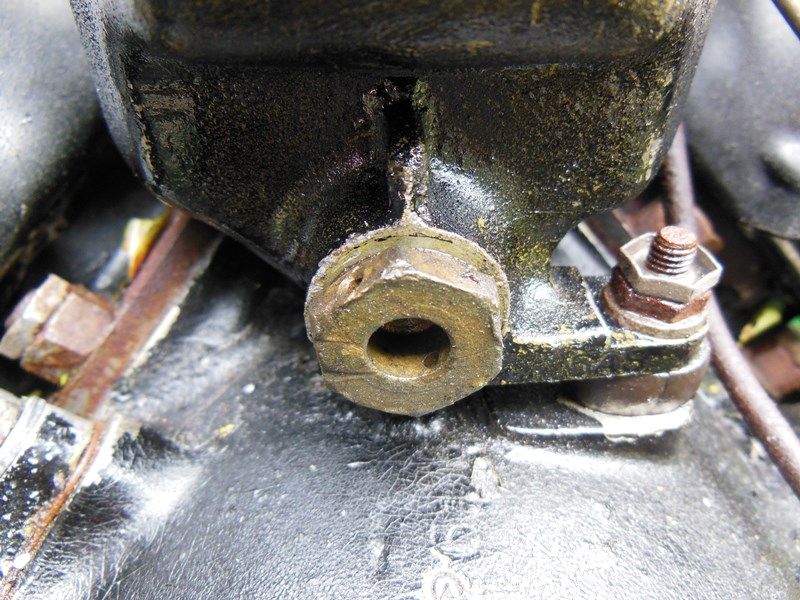

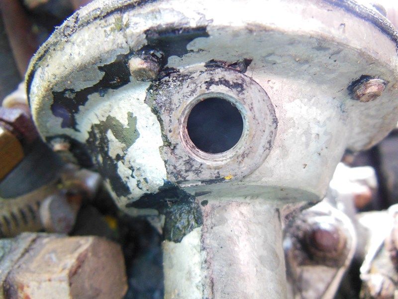

Inside the float chamber is a float, of course, and a needle valve that is opened and closed by the movement of the float. When the chamber is full of fuel (to the set level), the float rises and closes the needle valve. When the fuel level drops, so does the float, and this opens the needle valve and permits more fuel to enter and refill the chamber. By using the squeeze bottle, I can "feel" when the float chamber is full, and this tells me that both the float and the needle valve are working just as they should. On the other hand, if I was able to keep pumping MMO into the chamber, then that would tell me that either the needle valve is stuck open, or the float is not...floating!
Here you can see the drain plug for the float chamber. This is the lowest point of the chamber and removing the plug will tell you right away if you have any varnish to deal with. I elected to leave the plug in place for now and we'll come back in a few days and remove it after the MMO has soaked for a while.
BUT, since I've been under the weather lately and have fallen behind on the updates, we'll magically fast forward and pull the plug now! Safety wire removed...
Turn and burn.

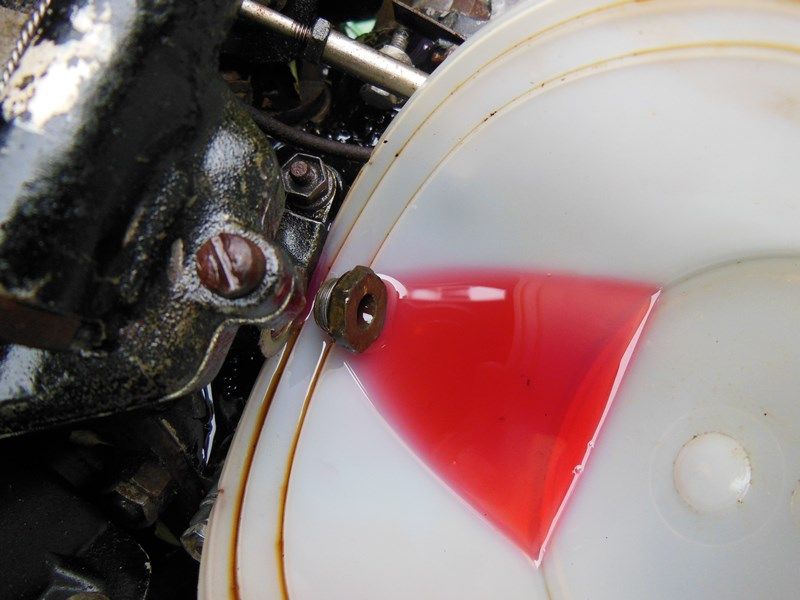

I struck "earl", as we pronounce it here in North GA. But half of it spilled over on the way out and now I have a mess to clean up!
Thankfully some help shows up, and just in the nick of time!
Aaaand they're gone. Ever notice how the help always seems to disappear when it comes to those dirty/oily jobs?? Hmm...

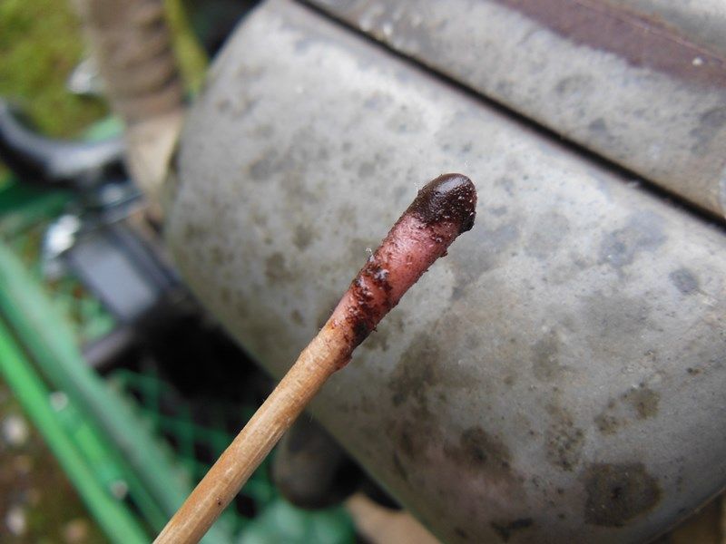

Here we can see the first signs of varnish in the float chamber.
So I swabbed around inside the bottom of the chamber and found even more. This tells me that there's also going to be varnish in the jets, and that means ya'll will get to see what the inside of this carburetor looks like, because now I have to take it apart and clean it! :P But for now, I'll reinstall the plug and fill the chamber up with MMO again and let it soak some more.
And of course, now that the dirty work is over, a few helpers magically appear again. Ever feel like you're being watched??

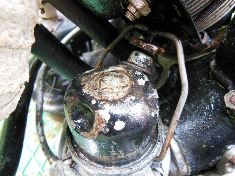

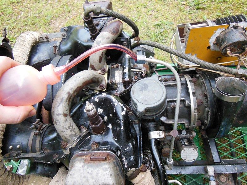

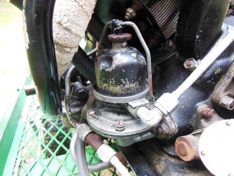

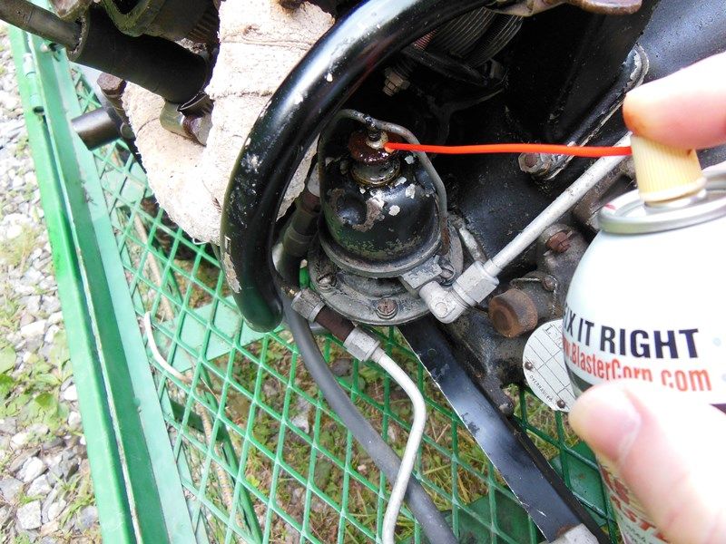

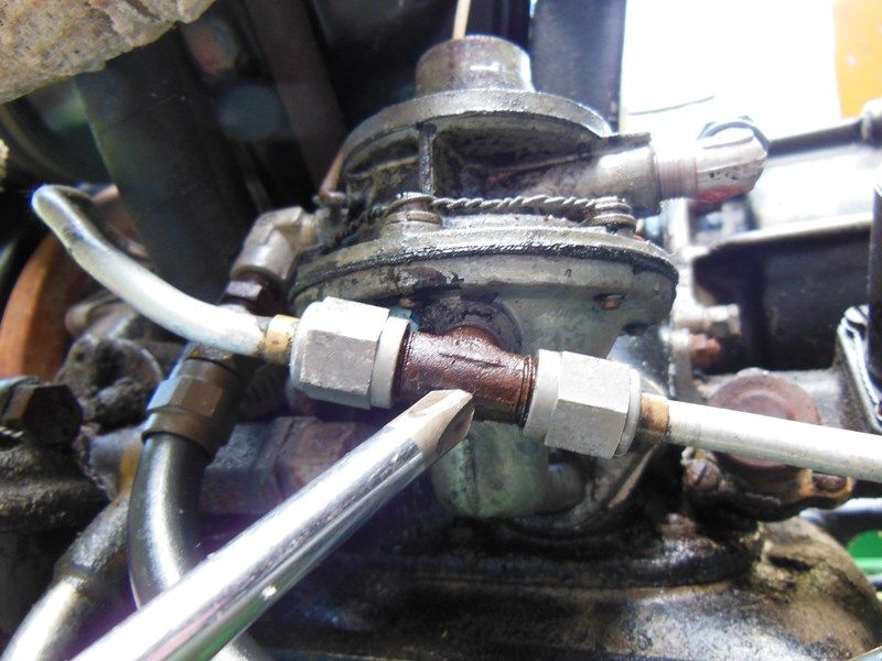

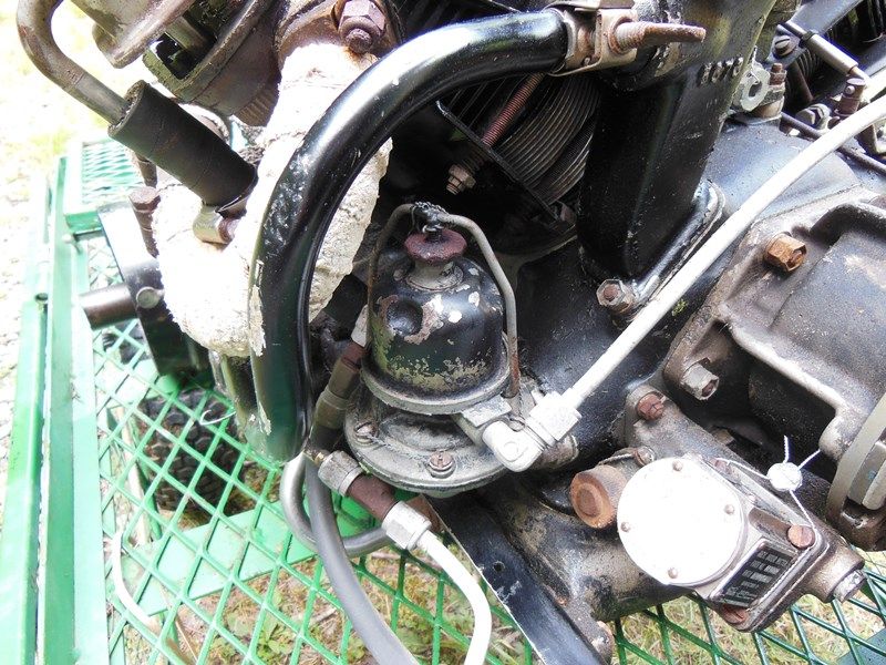

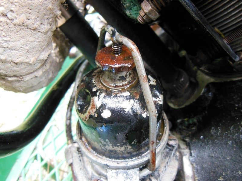

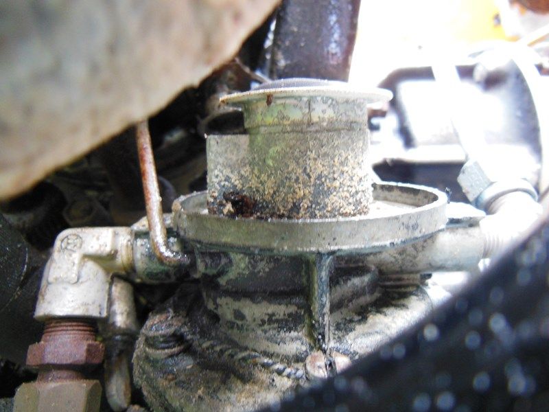

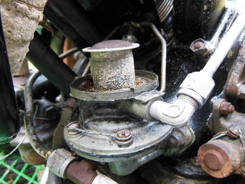

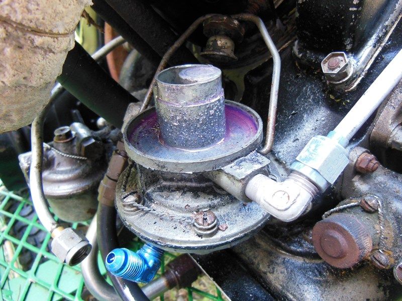

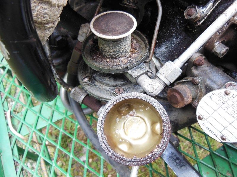

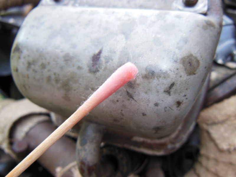

Now let's turn our attention to everyone's favorite component on these engines: the fuel pump! These are simple diaphragm pumps and as far as I can tell, they are practically identical to the fuel pumps used on WWII Jeeps. Now I'm no expert on Jeeps, but looking at the part numbers, I believe the only major differences are the rocker arm, diaphragm spring and the lack of a priming lever? Otherwise, as best as I can tell, the two pumps share the exact same parts.
The first thing we'll do is squirt a bunch of MMO into the carb feed line and let it work down into the pump (more on that later).

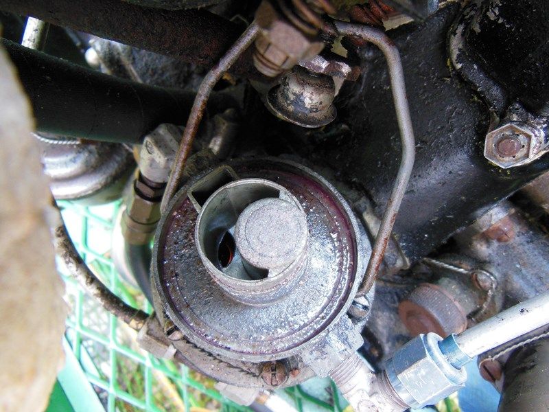

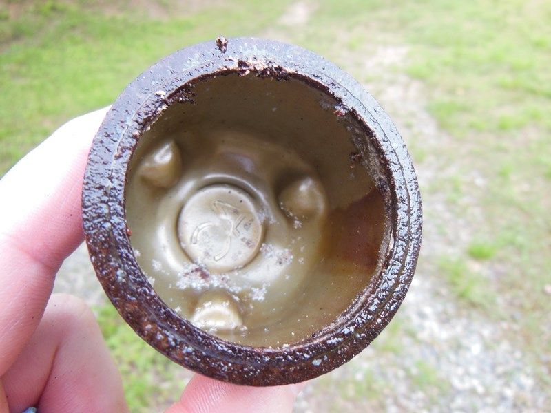

Next we'll remove the bowl and see if there's any fuel varnish we need to clean up. To remove the bowl, first we need to loosen the retaining knob on the bail. After removing the safety wire, I tried to loosen the knob, but it wasn't budging! We'll give it a few shots of PB Blaster and let it soak for a spell.
Coming back a few minutes later, the knob was still refusing to budge, so I hit it with some more PB Blaster and waited a few minutes. Well, that didn't work either! So I hit it again with the PB, and then I took a mallet and a flat tip screwdriver and slowly started tapping the knob loose. After a few minutes of slow going, the bail was finally free. These pumps were made by AC Spark Plug, hence the "AC" stamped into the bowl.
Let's open it up and see what we got!
Here's looking inside the bowl. Aside from some gunk and a little corrosion, it doesn't look too bad. But what about the rest of the pump, you say?

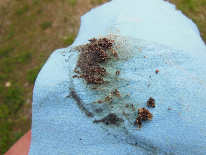

Oh dear. There's all kinds of nasty goin' on right there!
Here's some of "the nasty" that came out of it. This is a mixture of varnish, grime and who knows what else. There's also going to be more varnish down inside the pump that we cant see yet.
We'll come back and do some more cleaning on the fuel pump later, but for now, you guessed it: more MMO!
Now this has never happened to me before, but I actually ran out of MMO after that last picture! The Engine Gods will not be pleased! Part II of the prep work on the fuel pump will be coming soon, just as soon as I can get some more of my "magic juice"...and MMO! :P
~Trevor McIntyre
http://www.TrevorMcIntyre.com
PostPosted: Tue Jun 24, 2014 10:01 am
Posts: 3282
Location: Nelson City, Texas
Very good info,................only thing I would do different is try AeroKroil instead of PB Blaster.
PostPosted: Wed Jun 25, 2014 9:55 pm
Posts: 2097
Location: Meriden,Ct.
I think I will invest in Marvel Mystery Oil.... :wink:
Good job,
Phil
PostPosted: Thu Jun 26, 2014 1:58 am
Posts: 393
Location: North Georgia

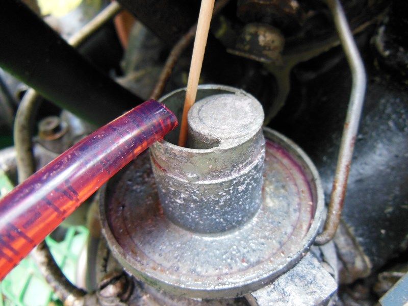

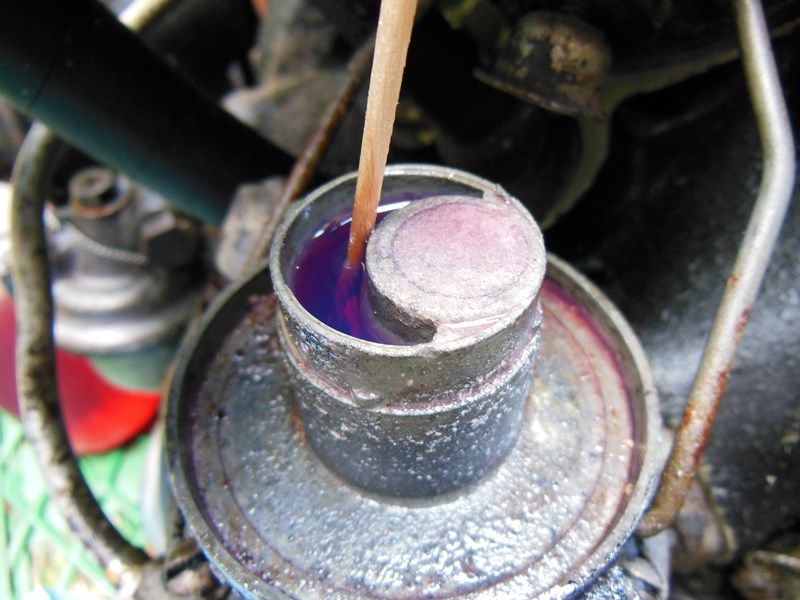

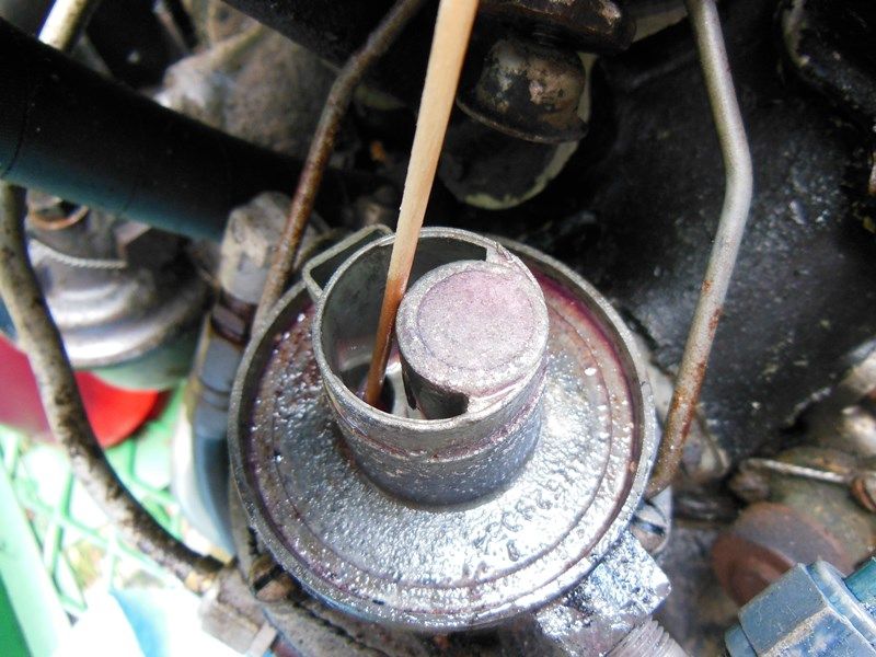

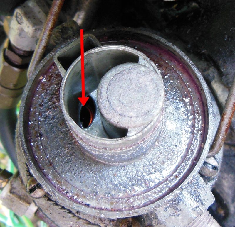

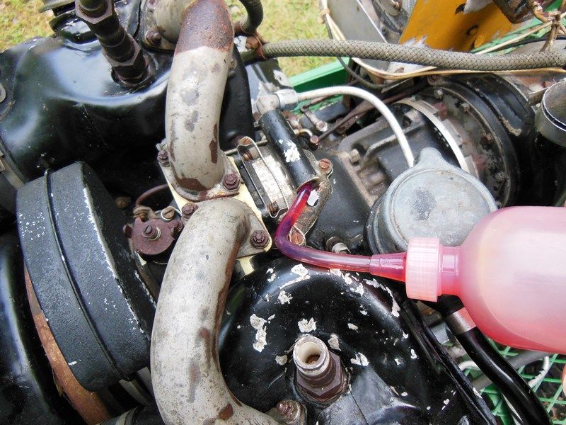

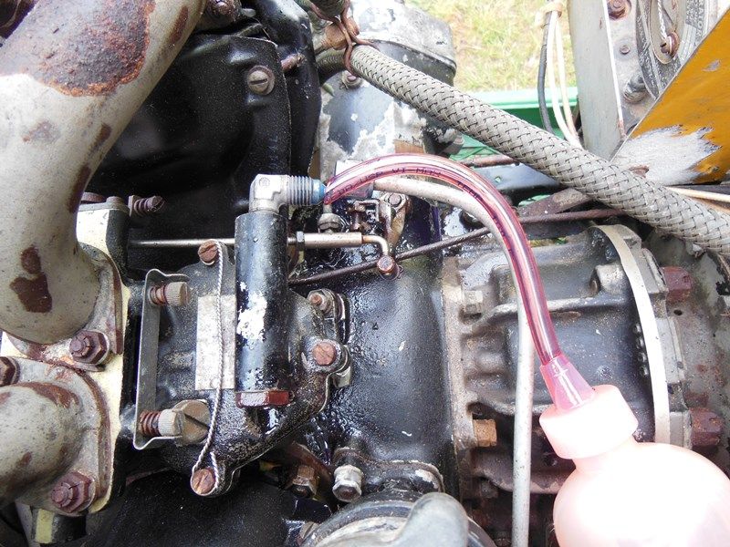

Alrighty, now that I have a fresh supply of MMO and the Engine Gods are happy once again, let's pick up where we left off with the fuel pump!
What we're going to do now is start soaking the internals of the pump with MMO. Down inside the pump body are two one-way valves that serve as a fuel inlet and outlet above the diaphragm. The way this pump works, very simply put, is the diaphragm is pulled down by a pull rod (via a rocker arm that rides on a camshaft lobe), which draws fuel in from the inlet valve, and then the diaphragm is pushed back up by a spring, which forces the fuel out through the outlet valve. (That spring also determines the fuel pressure--heavier spring, higher fuel pressure.) This flexing motion of the diaphragm is what accomplishes the "pumping" of the fuel to the carb, but we'll get into all of that in greater detail in a later post!
By adding the MMO here we want to fill up the chamber above the inlet valve, and the MMO we added earlier to the carb feed line will run down and fill up the chamber above the outlet valve. The screen removed:
Looking down into the pump.
Here's an extreme close up. Note the inlet valve.
I swabbed around the inlet valve and everything looks clean--no varnish!
Next we'll fill up the chamber with MMO.
And then I'm going to gently push open the valve and allow the MMO to flow down onto the diaphragm. (I found it flows faster by "tapping" on the valve instead of just holding it open.) I'll keep adding more MMO as needed until the diaphragm chamber is completely full. These diaphragms can dry out with age and will easily tear if you try to use the pump, which is what happened on the Kee Bird and led to the rigged up fuel can in place of the pump. Now I don't know what the condition of this diaphragm is, but before we even think about trying to rotate the crankshaft on this engine, which will also put the diaphragm into motion, we want to really soak that diaphragm good and get it pliable again. It might already be too far gone to save, but we wont know for sure until later. For now: fill 'er up!
Here you can see all the MMO has flowed down into the diaphragm chamber. We'll keep adding more until we're sure the chamber is full.

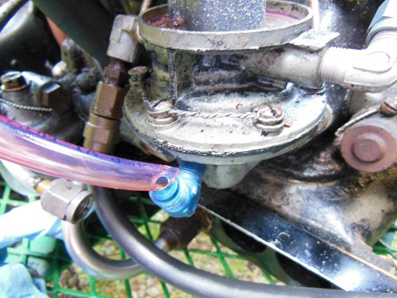

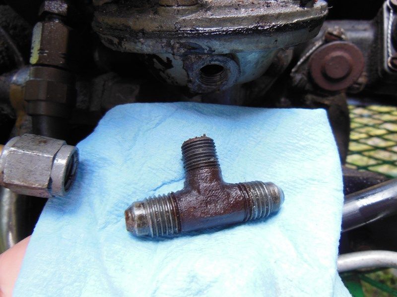

The next thing we're going to do is full up the chamber beneath the diaphragm with MMO as well. To gain access to it, we'll remove the drain lines and T-fitting on the bottom of the pump.

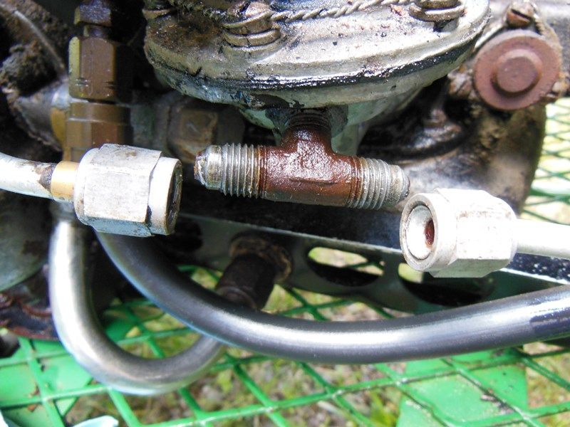

Drain lines disconnected.
T-fitting removed.
Looks like we have some varnish to clean up in the bottom of the pump!
I'm not able to get a picture of it, but if you were to look inside there, you would see the bottom side of the diaphragm, as well as the diaphragm spring, etc. A quick swab inside there also revealed varnish.
What we'll do now is screw in a new fitting...
Aaaand then we'll start pumping MMO into the chamber until it's completely full.

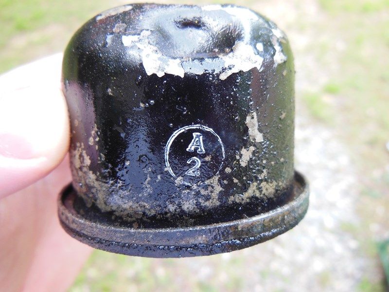

So now we have filled all the internal chambers of the fuel pump with MMO and both sides of the diaphragm are soaking. One thing I should mention here is that there were a couple different types of diaphragms used in these pumps over the years, and I can tell from the outside that this pump has the later (post-war) diaphragm that is more durable than the WWII variety, so hopefully after a good soaking in MMO, it might still be usable. We'll take a closer look at this and our options if the diaphragm has to be replaced in a later post. You can actually still buy brand new replacement diaphragms and rebuild kits for these pumps, so worse case scenario, we have that option available if needed!

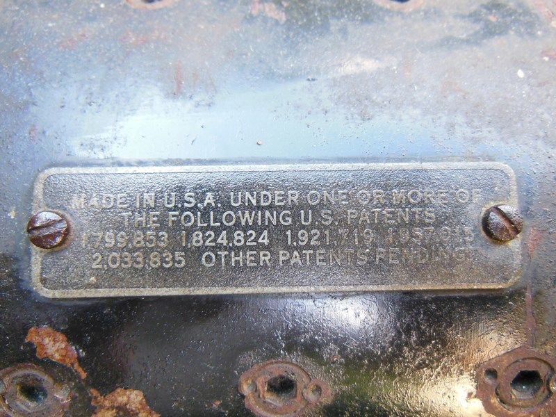

Oh, and here's some shots of the inspection stamps and such on the bowl for the die hard modelers :wink:
So to sum up today's adventure: the carb will need to be removed and cleaned, and the fuel pump needs further soaking/cleaning and inspection to determine serviceability. Will we be able to bring the fuel pump back to life again after all these years, or will it end up burning my garage down? Stay tuned! :wink:

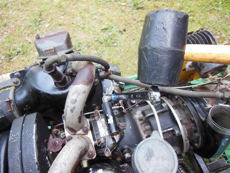

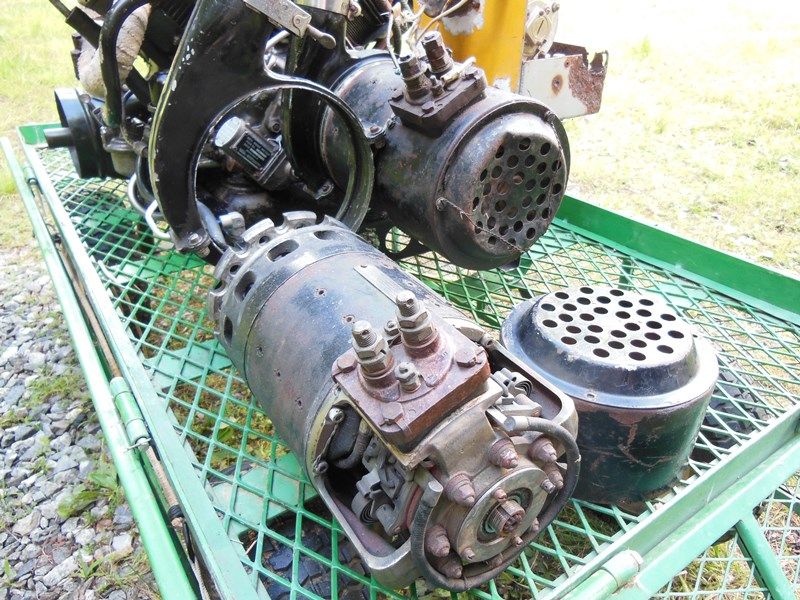

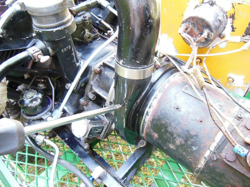

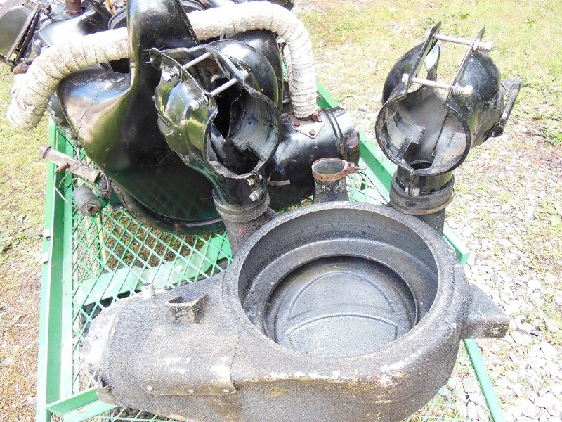

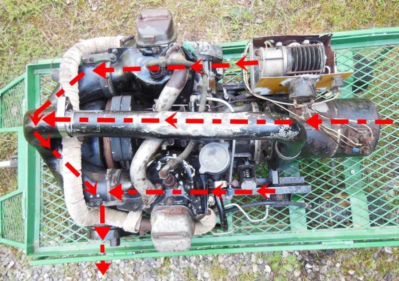

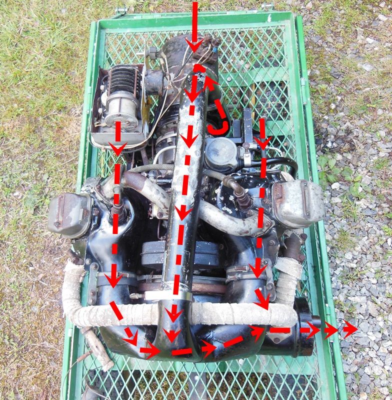

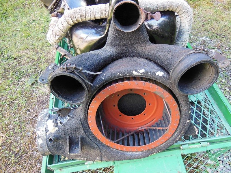

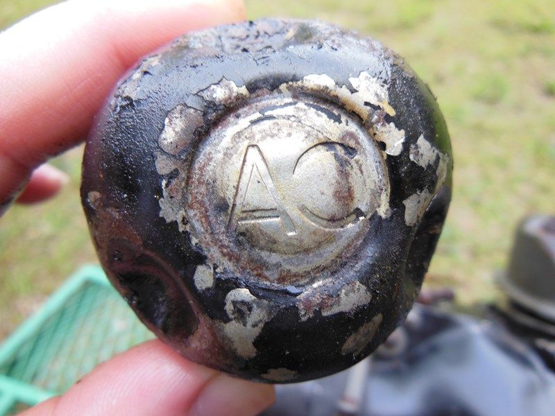

So before we go any further here and start tearing parts off this APU, I thought this would be a good time to explain how the cooling system on these engines work.
If you watched my "farm fresh walkaround" video of this APU, https://www.youtube.com/watch?v=M-QV1vC-4kk, then you may recall that I pointed out the squirrel cage fan that's contained within the scroll. That fan is what cools the cylinders and generator, but while it would be logical to assume that it simply blows air on these components, that's actually not how it works. Instead of a blast system, these engines use a suction cooling system, whereby air is pulled through the generator and cooling fins of the cylinders.
To make this easier to visualize, I had the graphics department put together some highly detailed "flow charts" of the cooling system for me. OK, I don't really have a graphics department, but this will give you a good idea of the airflow!

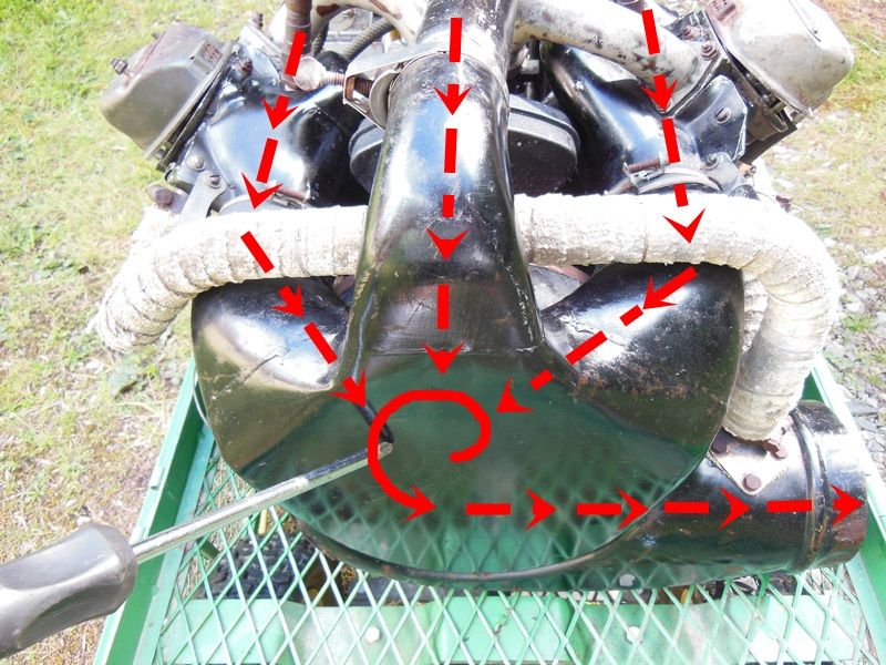

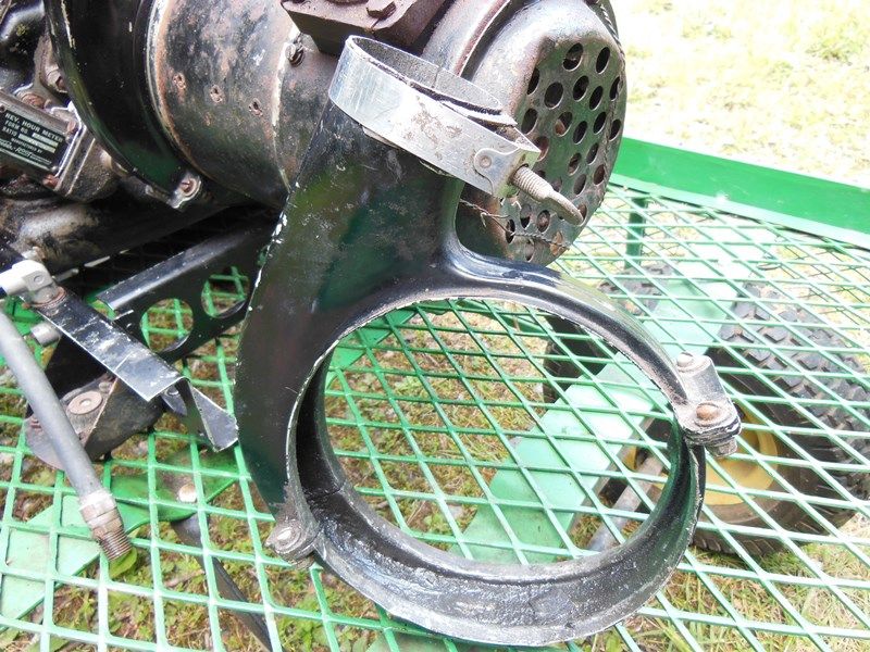

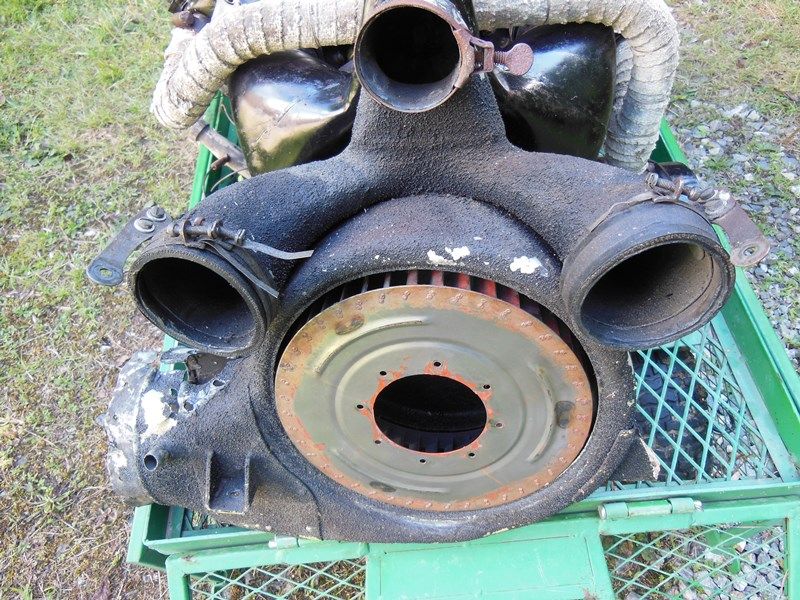

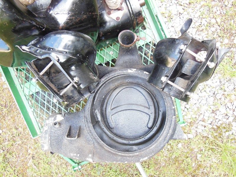

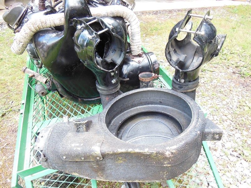

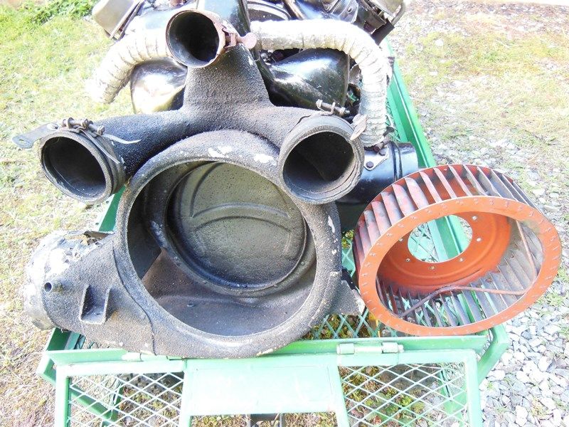

Now let's take a closer look at how this cooling system works. First we'll start with the most prominent part, which is the large scroll that contains the squirrel cage fan (which is attached to the flywheel).

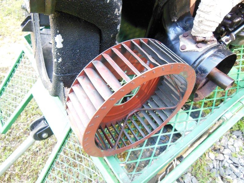

Here's an inside view of another scroll and fan.
This view shows how the fan is contained within the scroll...
But to make it easier to see, I turned the fan around in this view. As the fan rotates, it draws in air from both the cowlings around the cylinders, and another scroll that's mounted around the generator. This air is then expelled, along with the engine exhaust, outside the aircraft.

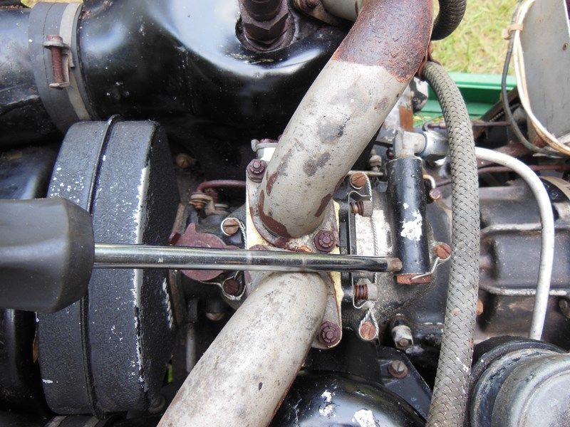

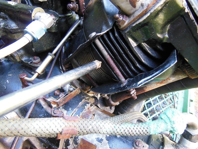

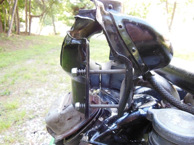

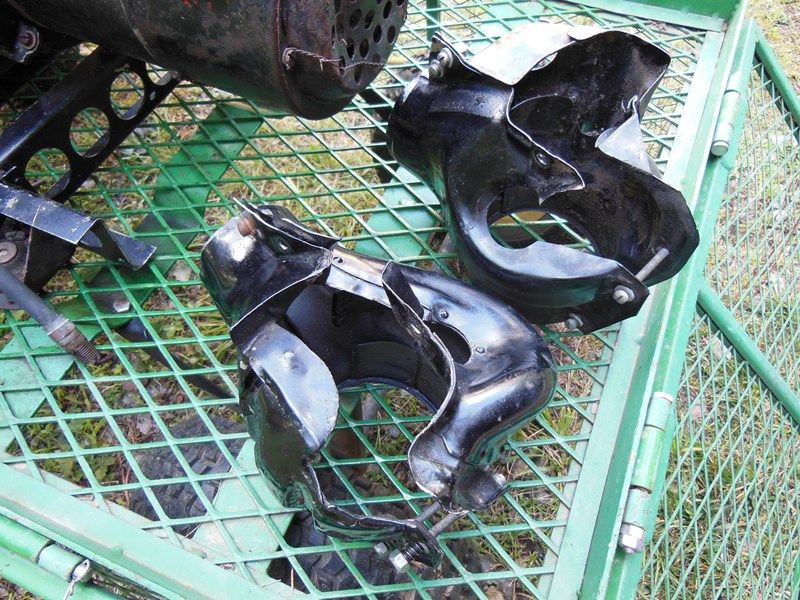

Now let's take a look at the cylinder cowling. Each cylinder has two little cowls that bolt together around the cylinder, and at one end there is an opening that permits air to enter, while the other end is connected to the scroll.
Here you can see the cowl air intake.
And here you can see where the cowling is connected to the scroll.
In these pictures you can see what the cowling itself looks like.
And the cowling mounted to the scroll (note the "A" for "Andover" stamped into the scroll).

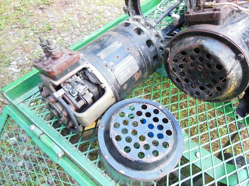

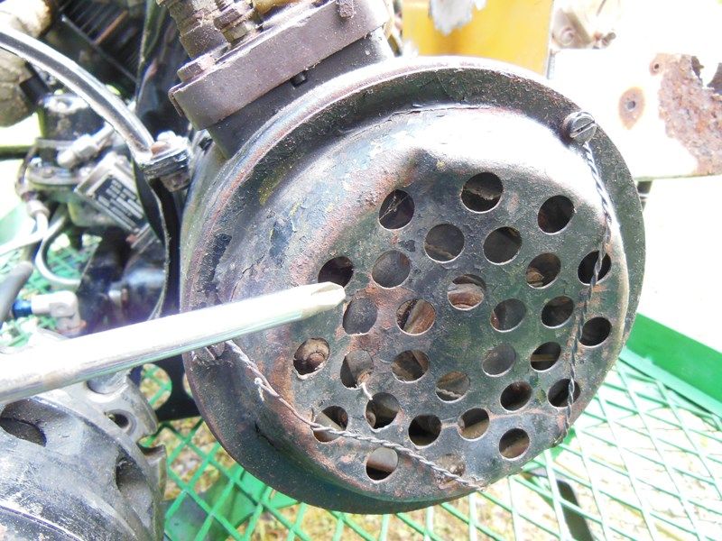

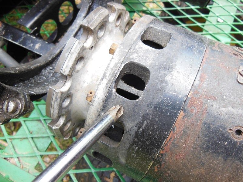

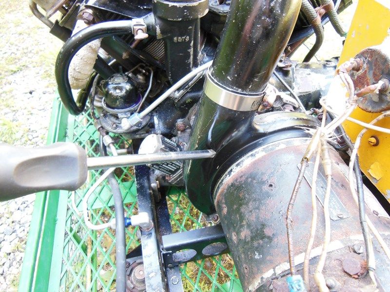

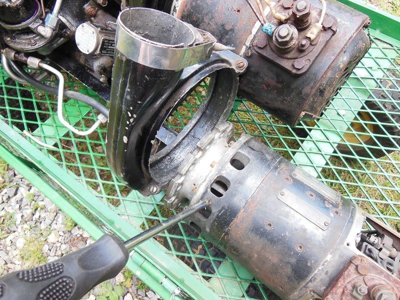

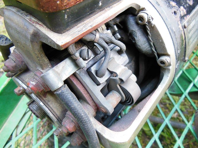

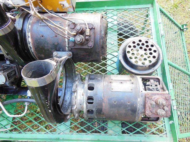

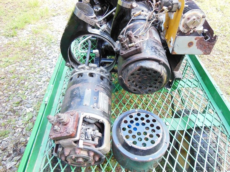

Now lets take a look at how the generator is cooled. Here you can see the scroll that wraps around the generator.
The end cap of the generator is perforated, which allows air to be drawn into the generator and flow back to the scroll.
Here's some shots of another Eclipse P-2 generator with the end cap removed.
While we're here, here's a shot of one of the brush assy's...

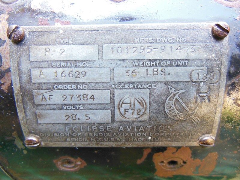

Aaaaand the generator data plate, for those die hard modelers--and yes, these generators really do weigh 36 pounds! :wink:
In the next post we'll talk about crankcase ventilation and how those rocker box cover vents work. Stand by!
