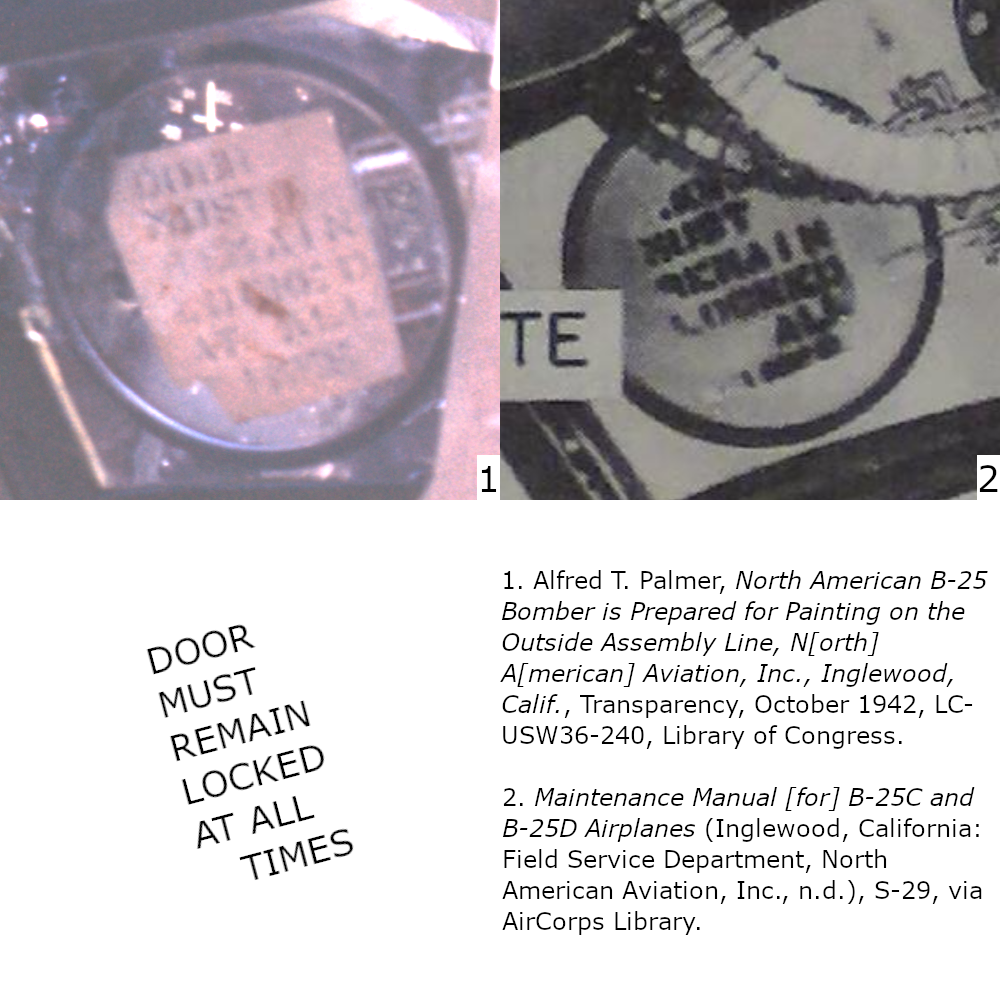

The recent discussion of ball turret modifications brought to mind a series of "things on bombers" (e.g. ejector chutes on PB-1W nose turrets, venturi tube fume extractors on B-25s,gun turret stabilizing fins) and from there something I had been meaning to post about for a while now: the Bombardier's Nose Access Window. (The name of the opening comes from a captioned image on page N-24 of the Maintenance Manual [for] B-25C and B-25D Airplanes. It is also called the "Nose Compartment Access Door" on page 108 of T.O. 1B-25(T)J-4.)
About two years ago, I queried Dan Desko of the B-25 History Project about it. At the time, I had been told that it was intended to allow the bombardier to clean the plexiglass in front of the Norden bombsight in flight, but I was a bit skeptical of that explanation. As it turned out, that was indeed correct, but some of the research I did in the process to determine the answer turned up some interesting information. For example, it was stenciled with instructions that the "DOOR MUST REMAIN LOCKED AT ALL TIMES IN FLIGHT":
(Sources: Library of Congress and AirCorps Library)
This initially sent me on the wrong track, as how could a bombardier open the window if it was meant to remain locked at all times? Furthermore, the B-25 could be equipped with a windshield wiper and anti-icer spray tube anyway. On the other hand, I knew that certain aircraft had a small "knockout window" on the lower left side of the windscreen. The B-25 even had a small removable copilot window, which apparently existed for this purpose.
However, my working theory at the time was that it may have been intended as a way to pass instructions to the bombardier shortly before takeoff. I know that certain modern aircraft, such as the ATR-75, have a small door on the side of the cockpit for this purpose. Although originally designed for mail, the hamburger door on a C-47 could conceivably be used for the same thing.
Considering it includes extensive detail about interesting equipment on early B-25s that I was not even aware of, the approximately 1,300 page Maintenance Manual [for] B-25C and B-25D Airplanes, I was surprised to learn that it does not mention the window. The pilot's manuals were similarly unhelpful as they are quite obviously for the pilot. I also skimmed through the Bombardier's Information File, but didn't see anything there either.
However, it was their combat historian Mike Laney who set me straight by pointing out that it is described as "Door For Cleaning Bomb Sight Window" captioned image looking forward and to the right in the nose compartment on page 65 of T.O. 01-60GB-1:
