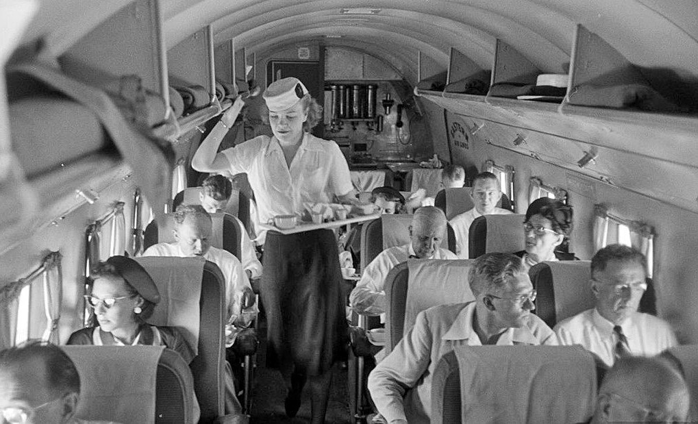

The DC-3 was an enlarged DC-2 with 7 rows of 3 seats vs 7 rows of 2 seats.
Other "visual aides" to distinguishing between the DC-2 and DC-3:
The DC-2 has the pitot masts located further forward under the nose.
The DC-2 cabin windows have rounded corners.
The DC-2 exhaust manifold is hidden under the skin of the nacelle.
