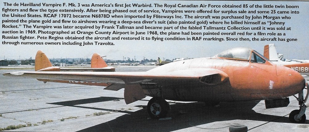

This is from an old Warbirds International article called "Before Warbirds"........
pop2
remember the Oogahonk!
PostPosted: Wed Aug 23, 2023 12:45 am
Posts: 863
Location: Lincoln, California
That this airplane was used by Johnny Rocket is often stated but not supported by anything verifiable that I could find. I think it is an oft repeated account that has bee assumed to be true. From what I wrote in the originally linked post:
The Vampire was sold to International Management Consultants of Corton-on-Hudson, New York, on July 24, 1958. No information has come to light about what it was used for or where it was based. As indicated below, some sources presume that N6878D was owned or operated by airshow performer Johnny Skyrocket, but there is nothing in the FAA registration file that indicates any association with any company or individual that John Morgan (a.k.a Johnny Skyrocket) of New Martinsville, West Virginia, was associated with at any time in the Vampires civil utilization. This Vampire has been confused, apparently, with N6876D as it had a similar (but not identical) paint scheme.

John Morgan, referenced in The Warbirds International piece about the key had an interesting proposal on what to do with surplus Vampires (and perhaps its various cousins with a similar configuration).
He designed a new forward fuselage seating 4-6 to turn the aircraft into a single engine bizjet.
I recall seeing drawings back in the day, it vaguely looked like a scaled down front half of a Jet Commander ahead of the wing.
Although they said the airframe would be a Vampure, I have a hard time believing the Vampires Goblin (3500 lbs of thrust) jet could take the weight, then too, I would suspect CG issues.
So perhaps the plan was to fit updated engines or use a Venom airframe.
At any rate, perhaps a few airframes found new homes in anticipation of future conversion.
