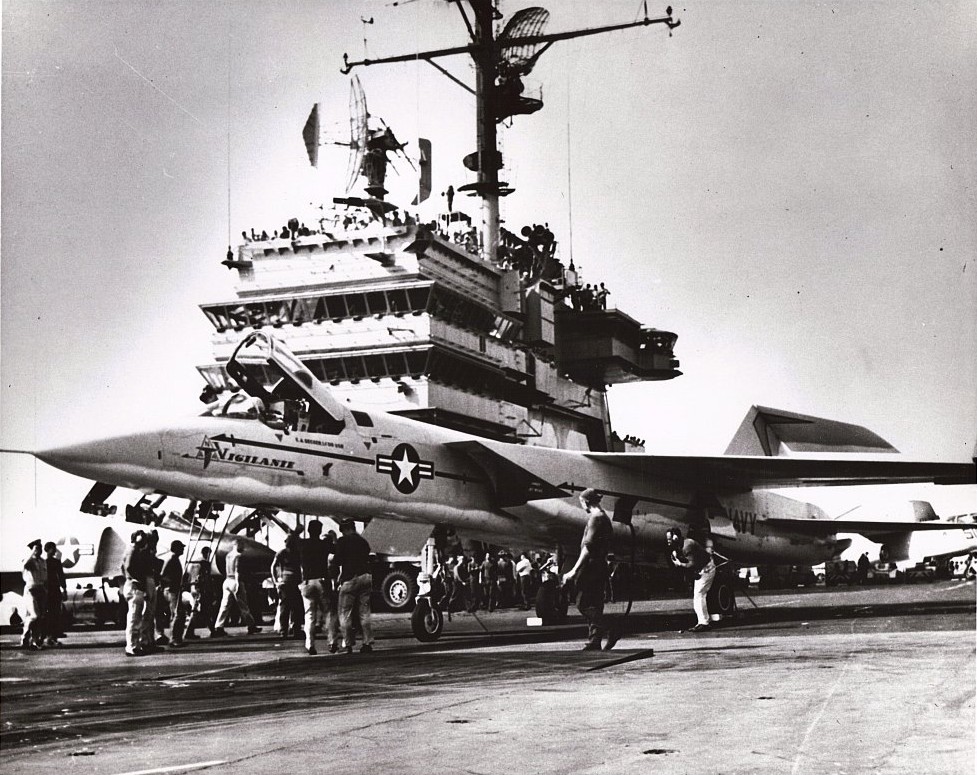

The North American A3J / RA5C Vigilante had a folding vertical fin.
North_American_A3J-1_Vigilante_during_trials_aboard_USS_Saratoga_(CVA-60),_in_July_1960.jpg
North_American_A3J-1_Vigilante_during_trials_aboard_USS_Saratoga_(CVA-60),_in_July_1960.jpg [ 229.25 KiB | Viewed 3573 times ]
C2j
