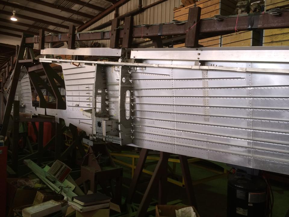

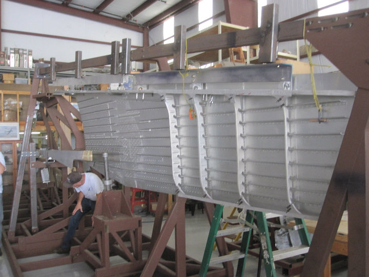

Here are few photos that illustrate the level of new material that was fabricated back in the 2000's. Original wing skins were used to set up the wing jig.
