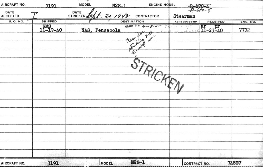

Format 1 (4-4198)
Format 2 (N. Aer. 3244)
Format 3 (N. Aer. 3244)
Format 4 (DIEBOLD ?)
Format 5 (ACME 30736-8P)
Format 6 (NAVAER-1925)
(Source: Photobucket via Warbird Information Exchange)
Format 7 (OPNAV-50-157)
(Source: TBM Avengers & Forest Protection Limited)
Format 8 (OPNAV FORM-5442-1)
(Source: Warbird Information Exchange)
Consider the above numbers potentially provisional because: a) the order may not be exactly correct, and b) there may be examples missing (e.g. OPNAV-50-150).

To Jordan Deters:
You never got back to me, but here's your AHC for BuNo 3190! Doesn't make any sense to me, what with the disparate dates, except that perhaps it did get stricken, then they changed thier minds and sent it to NATTC at Memphis?
