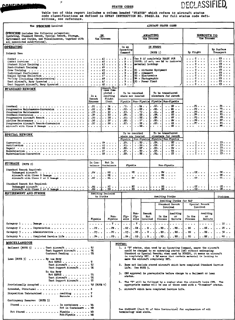

Okay, so it looks like the document you're looking for may actually be OPNAV 5442. The earliest I have been able to find a copy of so far dates to 6 July 1992.
I did come across a report from 31 August 1963 that includes a table of status codes, but it seems like it might be different format:
(Source: Naval History and Heritage Command)

Okay, so I realized I've made a mistake and forgot that there was apparently difference between "status codes" and "strike codes".
However, I have found out that the digitized document at the beginning of this thread that included the chart of strike codes is titled "Aviation Maintenance Administrationman 3 & 2" and is designated "NAVEDTRA 10391-C2". The chart matches one on page 3-26 of the 1980 edition. My best guess is that the answer to what employment codes 2 and 3 represent are in an earlier version of this manual. Unfortunately, while Hathi Trust has copies of the 1969 edition of "1 & C", at the moment I haven't been able to find "3 & 2" from this time period.
Might the library at the museum there have a pre-1980 copy of it? If you do find anything, I would love to know what you come up with!

A contact of mine on another forum has a lot of expertise in US Navy History Cards - I alerted him to this post and he replied as follows
"Thanks for drawing my attention to that question. I'm not a member of
that forum but can tell you that the second '3' is from an old (1950)
table of codes and translates as "Parked ashore or moored in water
(Category 3 strike)".

I have an answer
"2 as a second letter signifies parked ashore or moored in water-category
2 strike. As to G as a third letter, I have never seen that so perhaps
you could ask him which particular aircraft he is concerned with.
It's a long time ago now but I think the information came in
correspondence with the former Naval Air Systems Command Historian,
William J. Armstrong."
So same Bill Armstrong.. and maybe G never used ?? Unless you can find an example of it being used?
