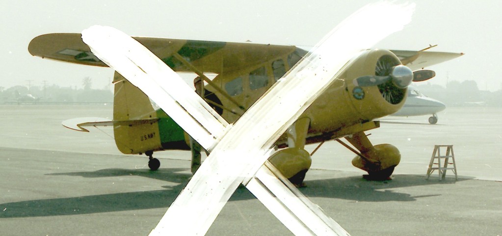

I found the negative for this shot in the trash at an estate sale many years ago; from the rest of the stuff I found it was taken in southern California, probably in the late '60s. Anyone recognize it?
ETA: Found a shot that seems to match; N5553N/msn 978:
http://www.flugzeuginfo.net/acimages/ho ... ying12.jpg

And, Baldeagle, I've also dug up what I could on the FAA N-number registry, but is it possible to dig deeper to see if there is anything beyond Don Ness owning it? Did the airframe have other owners before being exported to Canada?
And Chris Brame, thank you for the colour photo of the NH-1. It's quite the striking paint scheme.
