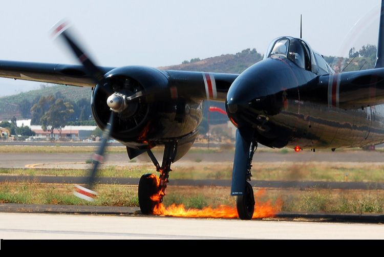

PostPosted: Wed Sep 30, 2020 8:14 pm
Posts: 2309
pppfffbbfftt...
PostPosted: Thu Oct 01, 2020 8:48 am
Posts: 449
Pretty typical example of a too-rich mixture burning off in the exhaust. Once the excess is out of the cylinders, the engine fires and blows out the fire.
The Tigercat is a tricky situation. A lot of radials manage to leak fuel during starting or dump any excess overboard after a starting attempt. If this then ignites you end up with something that you cannot sort out from the cockpit. I've seen this happen on a B-25 as well.
