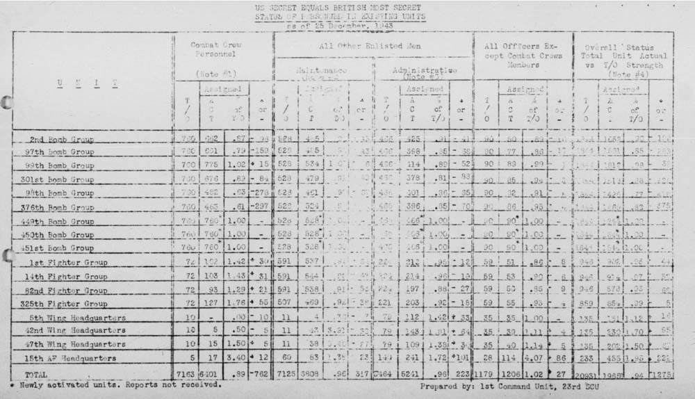

What was the count of ground bugs to pilot?
Ruff question I know.
So let's say a fighter squadron.
What was the ration of:
- Operational AC
- Active pilots
- Active mechanics on duty
Sincerely not knowing the answer.

A rough estimate of ground crew members to flight crew was 8-10 to 1. Depending on location and organization of course. That includes mechanics, armorers, supply, communications, meteorology and all of the rest of support.

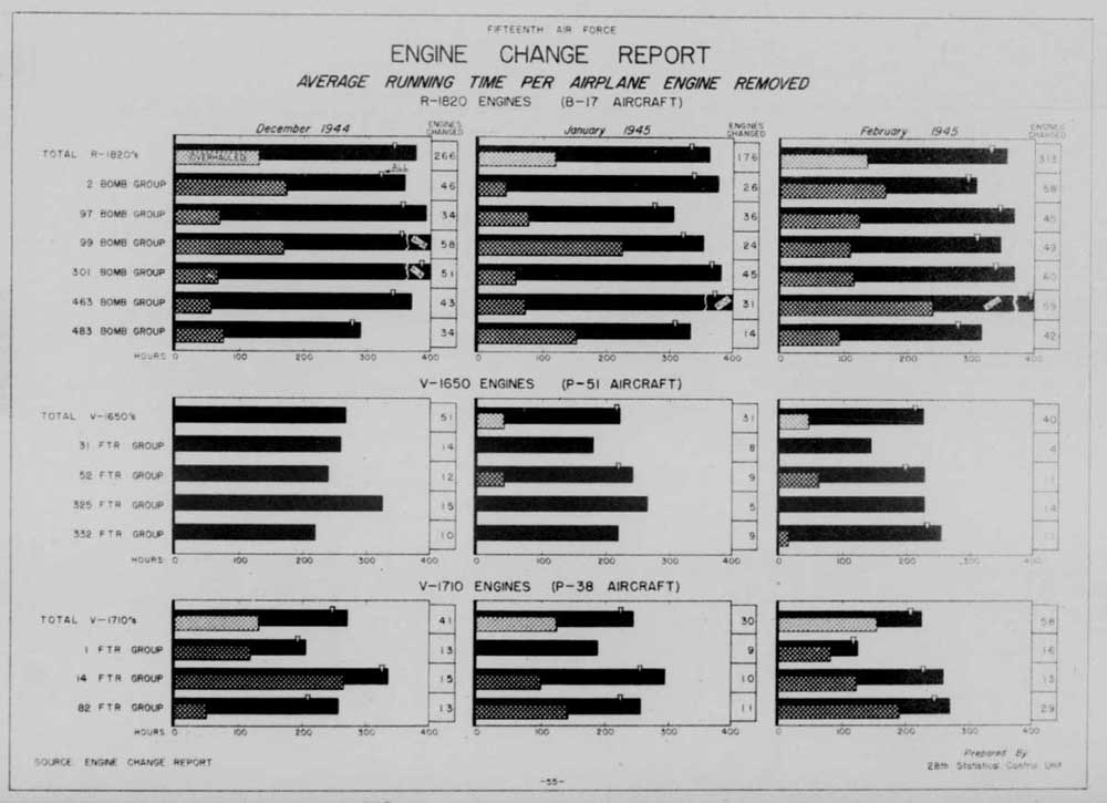

For those interested - the 15th AF stats on engine change times
PostPosted: Tue Mar 10, 2020 10:40 am
Posts: 556
Those charts are very interesting! I did not know engine changes occurred with such frequency.
PostPosted: Tue Mar 10, 2020 10:53 am
Great info! I'm sure the fighter engines were run a lot harder than the bombers too.

for those interested in number of Mechanics / staff vs flight crews (T/O = Tech order) (ACT=Actual)- 15th AF stats December 1943 might help

PostPosted: Wed Mar 11, 2020 5:37 pm
Posts: 2397
Great info!
Tks shrike for the answer.
