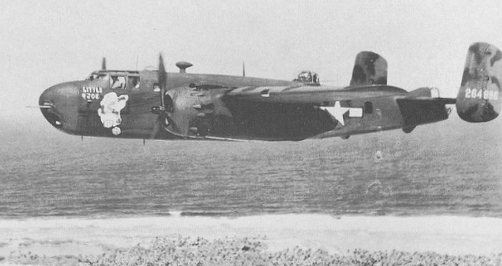

It was not uncommon that majority of the F-10's were modified with tail guns (NAA designed), as well as a some of the late B-25D's & G & PBJ-1D were also modified before being sent overseas
PostPosted: Wed Mar 11, 2020 1:12 pm
Posts: 4738
Those last two shots are of the plane that's now dressed up as 40-2344 at the NMUSAF. First time I've seen 'em - thanks for posting!
