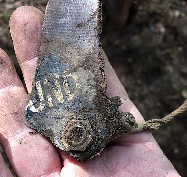

Can anyone help to confirm that this is the headset jack socket from the jackbox on the right hand side of the cockpit ? We can't find a picture of it anywhere.
The lettering appears to be the last three letters of the word 'SOUND' or 'GROUND' or something else.
Thanks for your help.

Looks like a receptacle to electrically ground the aircraft on the ramp.
PostPosted: Fri Sep 20, 2019 2:37 am
Posts: 1488
Location: North Texas
The piece of wire gives the answer. Static ground point. The only things that uses 2 or 3 wires wrapped around a core of wire, are static grounds. Notable other places to find them are on control surfaces and hinged doors and panels.
That's great, and it makes much more sense. Thanks. Any idea where we could find a picture ?

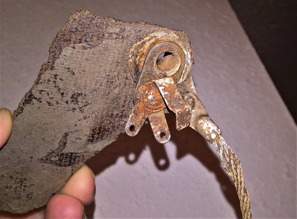

Here is a picture of the back of the connector. Does this confirm the static gounding point and give a clue as to it's location on the aircraft ?

Wash off all the dirt and you can verify that all three of the small eyelet terminals have continuity with the flex tab and the body. The only thing that uses this type configuration is a static ground point. The labeling on the other side would be consistent with a ground point too.
The pilot's headset would have plugged into a J-22A jack box on the right side of the cockpit. The J-22A would give the pilot a mix of all 5 receivers installed in the aircraft.

Definitely a static grounding receptacle. I have the same units all over the F7U.

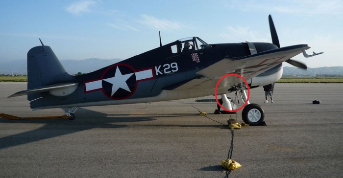

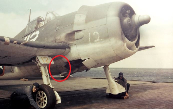

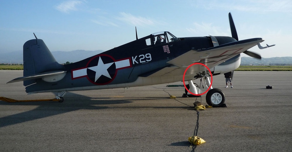

Maybe somewhere here ? Behind this cover ?
PostPosted: Mon Sep 23, 2019 4:45 am
Posts: 449
Generally, a grounding point would be installed near a fuel filling cap so that you can easily connect the grounding wire before commencing fuelling. I have no idea about the Hellcat's location for that though.
