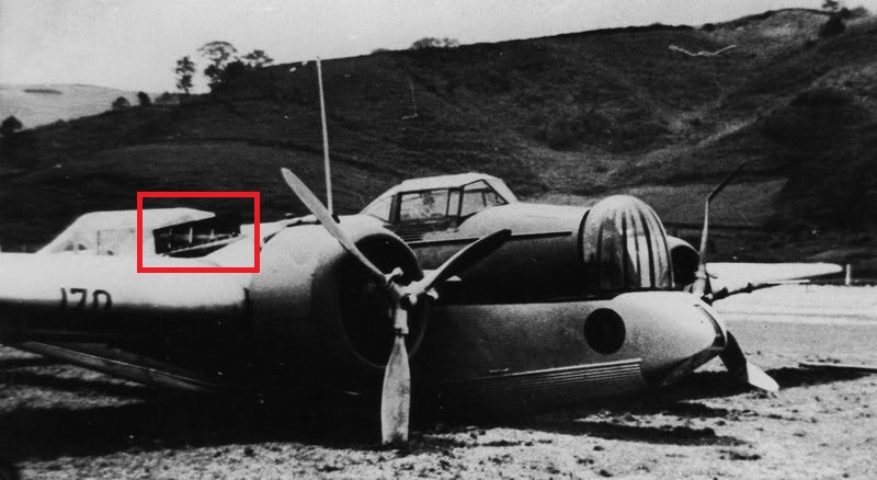

Similarly, what were the fins on the top of the rear of the engine nacelle on the B-10 for?

I assume they were to keep the any flames coming out of the exhaust from blinding the pilot, but I'm not sure.
