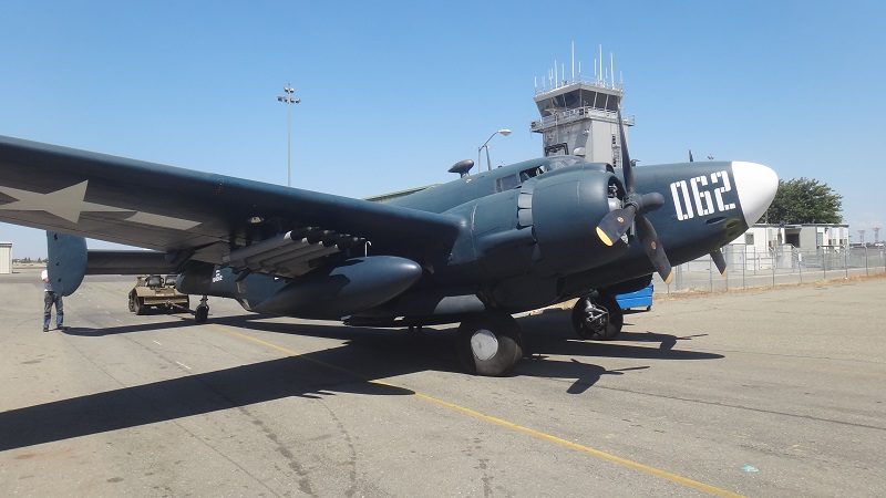

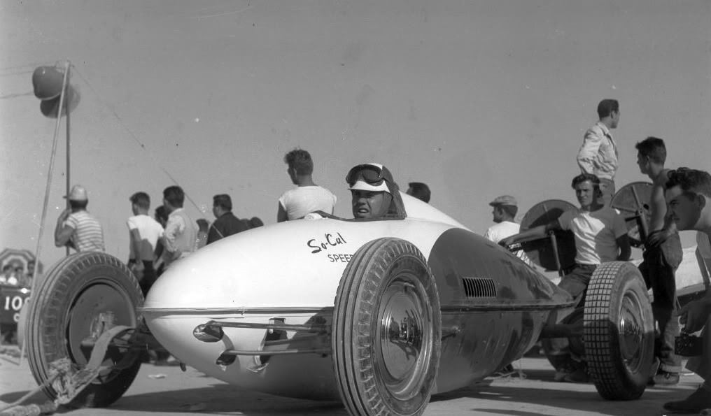

Taken from Taigh's thread...this is the "P-38" tank that is most desirable. Its really a Lockheed tank I believe and came is several sizes, bigger desirable one used on PV-2 and PBY aircraft most commonly. P-61 tank was similar if not identical.
The So-Cal Lakester is the most famous and iconic of the breed and was really something. What is important to remember is just prior to WWII the World Land Speed Record was attained by the Auto-Union and Mercedes Silver Arrow cars at a state sponsored cost of Millions of Reichmarks. Incidentally, that record, set by Rudolf Carriciola was 268mph over a flying kilometer. That record still stands as the highest speed ever attained on a public road. Ninety Minutes later, Bernd Rosemeyer was killed attempting to best that mark. Shortly after WWII, Southern California Hot Rodders attempted to recapture the land speed record using parts made by small cottage industry folks working with common and cheap passenger car engine and suspension parts. They went pretty darn fast for a lot less money. Pretty darn cool.
