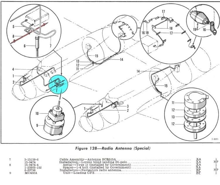

Is this little 'doohickey' still in there somewhere?
S.
PostPosted: Mon Sep 26, 2011 6:32 pm
Posts: 550
Location: Northants, UK
She has the usual "washing line" antenna that I'd coloured red in the first image (see upthread for a pic of the damaged aft support post), but doesn't have the rigid "towel rail" antenna from the other two.
We are unsure whether or not the original B-17G-35-BO 42-31983 "Mary Alice" had the rigid antenna as yet, mainly due to a lack of photo evidence from this area of the aircraft.
Hope that helps,
PB
