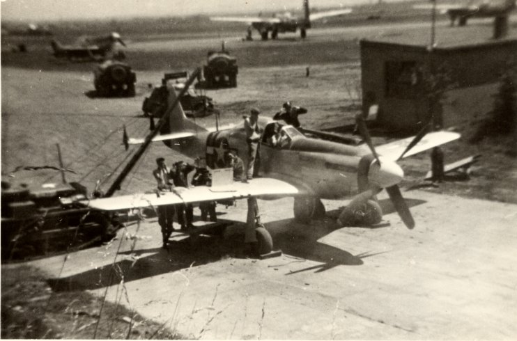

Like this.
The caption said to plug your ears.
I'm sure Jack can find a better one.
