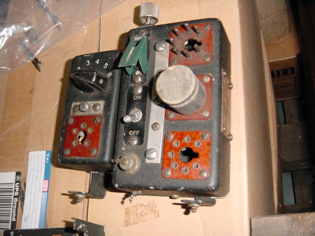

Here is a shot of the ABK-2 control head. The ABK set was nearly identical to the SCR-695 so the head is essentially the same.
I hope this helps,
Taigh
Thank you!
Taigh Ramey
http://www.twinbeech.com

Thank you Taigh! This is exactly what I need. Going by the old black and white picture, where some areas are unclear, I thought it to look quite a bit different than what it really does look like.

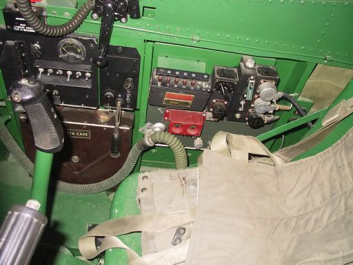

This is what P-51C Princess Elisabeth looks like on the inside.
We don't have that box but our current radio and transponder control heads occupy that spot.

Thank you Rich for the photos. The reason for this information actually is for the use in recreating a virtual P-51B/C, in particular Princess Elizabeth. Jim has actually sent me quite a few photos from PE's cockpit which has been and will be a huge help in modeling and texturing the cockpit.
