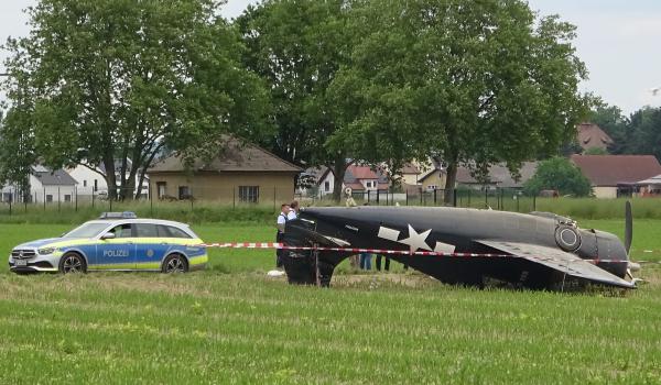

Saw this posted on the WIX FB group - I'm not sure which BuNo this is at the moment, looking for that info. Hope the pilot will be ok.
https://www.regiotrends.de/de/polizeibe ... 82599.html
Translation:
At around 12:15 p.m. on Wednesday afternoon, 01.06.22, the police were informed that a motorized aircraft had crashed near the local road between Schlatt and Bremgarten. The pilot probably attempted an emergency landing, but failed. He was seriously injured and had to be rescued by the fire department.
The injured person was transported to the hospital by rescue helicopter. The reasons for the accident are not yet clear and are still part of the investigation.

I guess that will be N909WJ

Gear still up? Grass? Little damage to the prop, so maybe an engine failure of some sort?
That doesn't look good.

The pics suggest a couple of possibilities. 1) the engine quit shortly after rotation and the pilot didn't have time to lower the gear back down. Or 2) total engine loss and he tried to glide to a suitable landing area and didn't want to add the drag of the gear and flaps. The prop blades are barely bent and suggest zero thrust and maybe even zero rotation. Whatever happened, he did a nice job of not stall/spinning and hopefully he and the airplane will fly another day.

Doesn't look that bad.
It's far more expensive -- maybe prohibitive -- if the gear is ripped off the spar or airframe. Everything twists.
Sheet-metal is cheap. And the engine obviously needed a rebuild anyway.
Glad to hear the people are OK.
