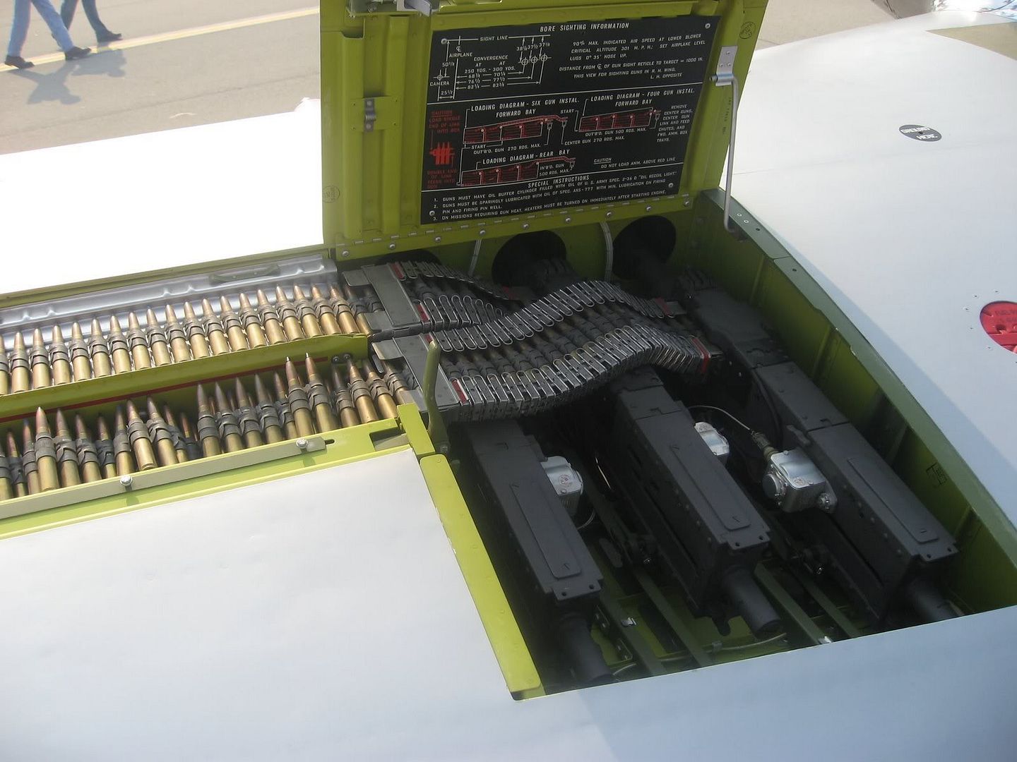

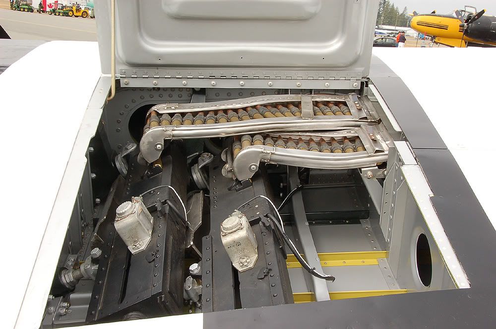

PostPosted: Mon Mar 09, 2015 8:15 am
shrike wrote:
When the six gun wing was designed the guns were set 'normal' to the wing - ie at 90deg to the dihedral angle. The four gun wing had the guns set vertical compared to the ground. This meant that there was more of an angle compared to the ammo feed on the four-gun, and the guns took up more 'vertical' space in the wing
P-51B/C
P-51D
PostPosted: Mon Mar 09, 2015 2:48 pm
Posts: 1185
Location: Chandler, AZ
Wow. Those are canted over even further than I was led to believe. No wonder they were prone to feed problems.
I wonder what idjit designed that set-up? (or to be fair, I wonder what other engineering criteria there were that led to such a sub-optimal installation)
