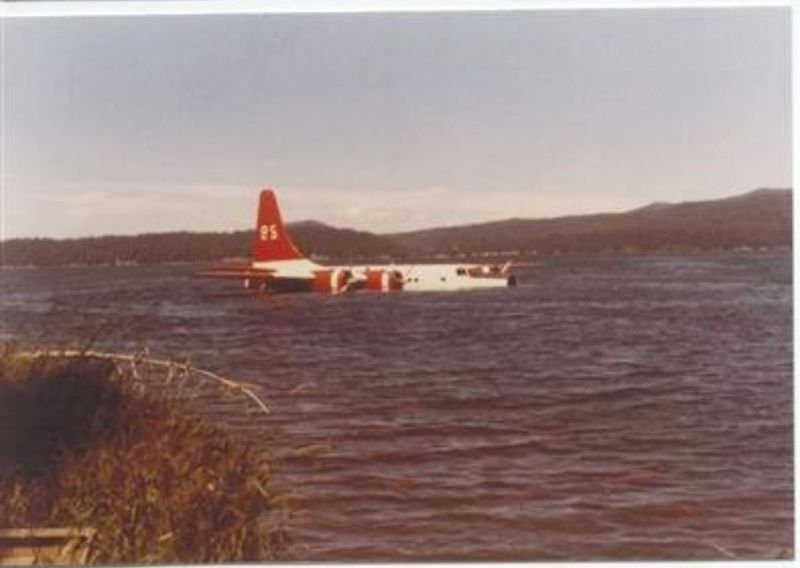

More research on Rosenbalm Aviation's PB4Y2 that ditched in Diamond Lake:
I finally reached someone who was on the salvage operation at Diamond Lake for the PB4Y-2 . It ditched in the shallow end of the lake. I am told that a picture still hangs in the lodge at Diamond Lake of the plane in the water. The crew from Rosenbalm Aviation floated the plane to shore and used a D-8 Cat to pull it out onto the parking lot. They then removed the engines, gauges and other usable parts. They left it on display for awhile and the public took souvenirs. They then demolished the remainder and hauled it away. They couldn't tow it out as two trees were in the way and they weren't allowed to cut them down.

Thanks for the info on Tanker 85 and Rosenbalm's bio. Here s/b a photo of the PB4Y in Diamond lake (scroll down).
http://www.butleraircraft.com/29B.html
If memory serves, they ran out of gas before ditching in Diamond Lk. Running out of gas lead to the loss of several PB4Ys. I wonder if they did not have gas gages?

I think they had gauges, a relative of Mr. Rosenbalm sent me this message:
"Chris Miller,
Regarding the PB4Y-2 that had to ditch into Diamond Lake when it ran out of gas July 27, 1970. It was removed from the lake. It landed in a shallow part of the lake and they floated it to shore with drums, etc. It was an expensive failure to fill gas tanks before another retardant drop on the part of the pilot !"

Air Classics or Warbirds Intl had great article written By Milo Peltzer (SP?)on the PBY's last spring.
Interesting note, the NTSB report claims the Aircaft did not have fuel gauges....
14 CFR Part 91 General Aviation
Event occurred Monday, July 27, 1970 in DIAMOND LAKE, OR
Aircraft: CONVAIR PB4Y-2, registration: N3191G
---------------------------------------------------------------------------------------------------------------------------- FILE DATE LOCATION AIRCRAFT DATA INJURIES FLIGHT PILOT DATA F S M/N PURPOSE----------------------------------------------------------------------------------------------------------------------------3-3094 70/7/27 DIAMOND LAKE,OREG CONVAIR PB4Y-2 CR- 0 0 2 COMMERCIAL COMMERCIAL, FL.INSTR., TIME - 1415 N3191G PX- 0 0 0 ASSOC FIRE CTL ACTIVITY AGE 53, 12707 TOTAL DAMAGE-SUBSTANTIAL OT- 0 0 0 HOURS, 14 IN TYPE, INSTRUMENT RATED. DEPARTURE POINT INTENDED DESTINATION MEDFORD,OREG MEDFORD,OREG TYPE OF ACCIDENT PHASE OF OPERATION ENGINE FAILURE OR MALFUNCTION IN FLIGHT: OTHER DITCHING LANDING: LEVEL OFF/TOUCHDOWN PROBABLE CAUSE(S) PILOT IN COMMAND - INADEQUATE PREFLIGHT PREPARATION AND/OR PLANNING PILOT IN COMMAND - MISMANAGEMENT OF FUEL MISCELLANEOUS ACTS,CONDITIONS - FUEL EXHAUSTION FACTOR(S) MISCELLANEOUS ACTS,CONDITIONS - JETTISONED LOAD MISCELLANEOUS ACTS,CONDITIONS - FAILURE OF TWO OR MORE ENGINES MISCELLANEOUS ACTS,CONDITIONS - AIRCRAFT CAME TO REST IN WATER COMPLETE POWER LOSS - COMPLETE ENGINE FAILURE/FLAMEOUT-3 ENGINES EMERGENCY CIRCUMSTANCES - FORCED LANDING OFF AIRPORT ON WATER REMARKS- WATER 8 FT DEEP. NO FUEL GAGES ON ACFT.

PostPosted: Sat Jun 25, 2016 10:36 pm
Posts: 1380
Was researching this PB4Y and located this old 2004 thread. Figured I'd update with a pic and current link to save someone else the search effort. The registry said it sank and nothing else.
http://www.butleraircraft.com/Tanker_Photos.html
PostPosted: Sun Jun 26, 2016 4:21 pm
Posts: 1028
Interesting that the airframe did not break in half, or at least it looks like it did not. I wonder if the retardant tank had anything to do with that?
