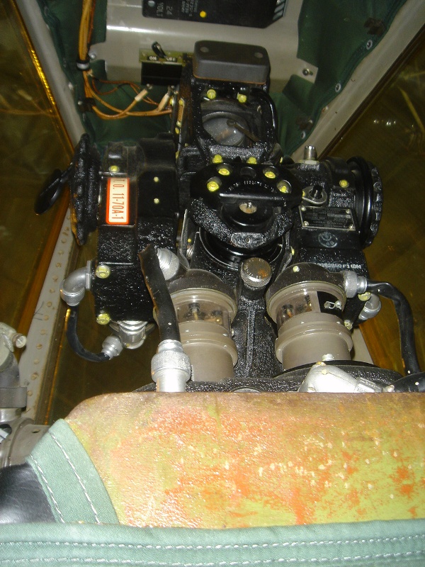

Here are some shots of the Enola Gay's tail turret. I think it is a great example of what they looked like as it is pretty much all original.
Sorry they are real close up as it was hard to get good wide shots with my camera while inside the tail gunners compartment.
This is the tail turret elevation drive motor looking aft. You can see the back plates for the two 50 cal guns just below the motor.

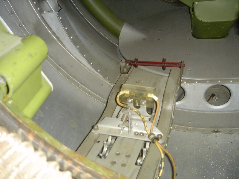

This is one of the two 50 cal ammunition feed mechanisms on the bottom of the turret aft of the armor/pressure bulkhead

The pedestal gun sight
The heated suit box mounted overhead of the gun sight

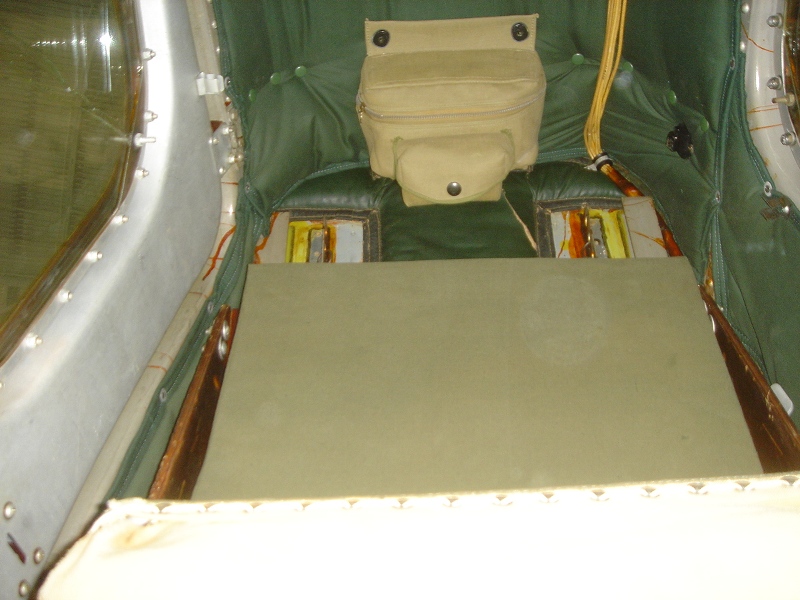

looking up and forward at the tail gunners seat. The first aid kit is mounted above the gunners head

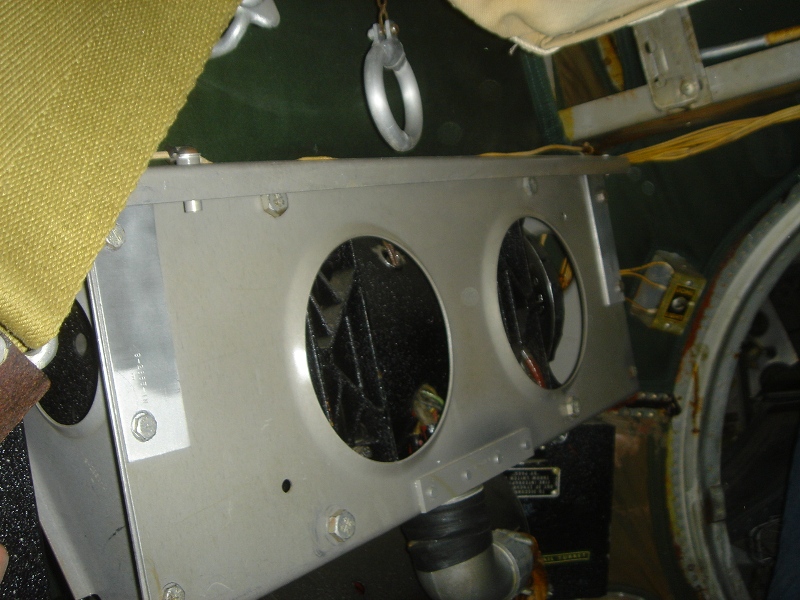

This is the tail gunners control box for the turret system mounted on the right side of the compartment or to the gunners left. The main oxygen hose along with the portable bottle recharge hose is also visible

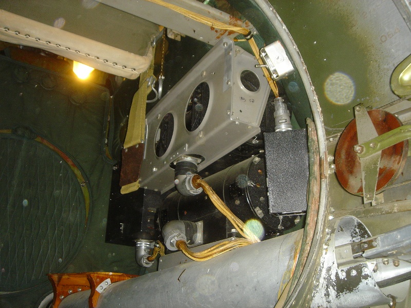

These are the amplidynes which are a part of the turret system. One for azimuth and one for elevation. These are on the aircraft's left side and this shot is looking forward. You can see the round opening for the pressure hatch. The canvas bottom of the gunners seat is also just visible along with part of the seat belt

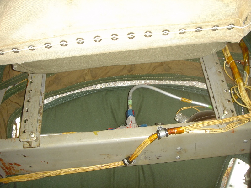

The canvas bottom of the gunners seat. You can also see the rails for adjusting the gunners seat up and down. On the right side of the frame is a warning horn
Here are the two amplidynes and a control box for the turret system. The tube at the bottom is for the ammunition to travel from the ammo box through the pressure compartment to the unpressurized tail turret. The round hatch with the diamond stitch insulation is a removable hatch that the gunner can open (if unpressurized) to get to the turret and guns for service if necessary
