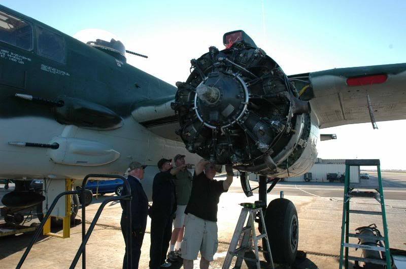

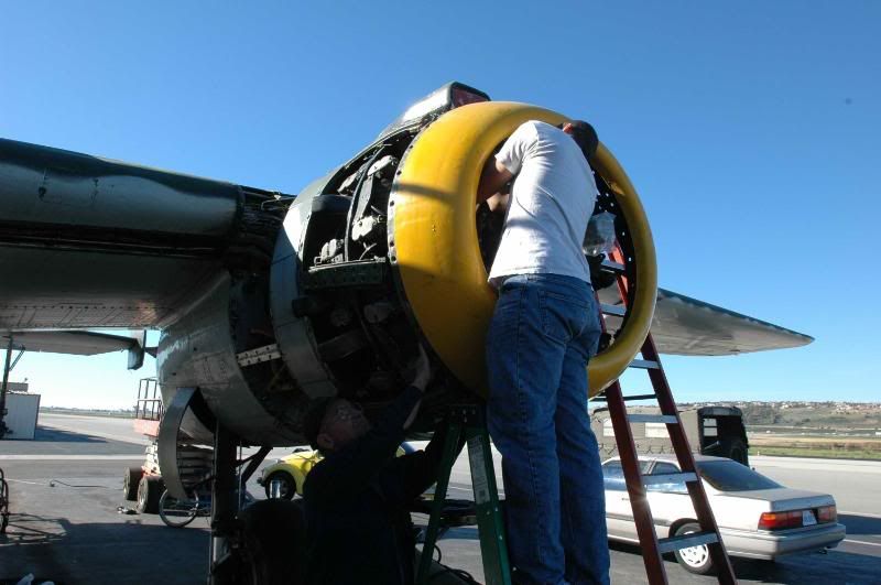

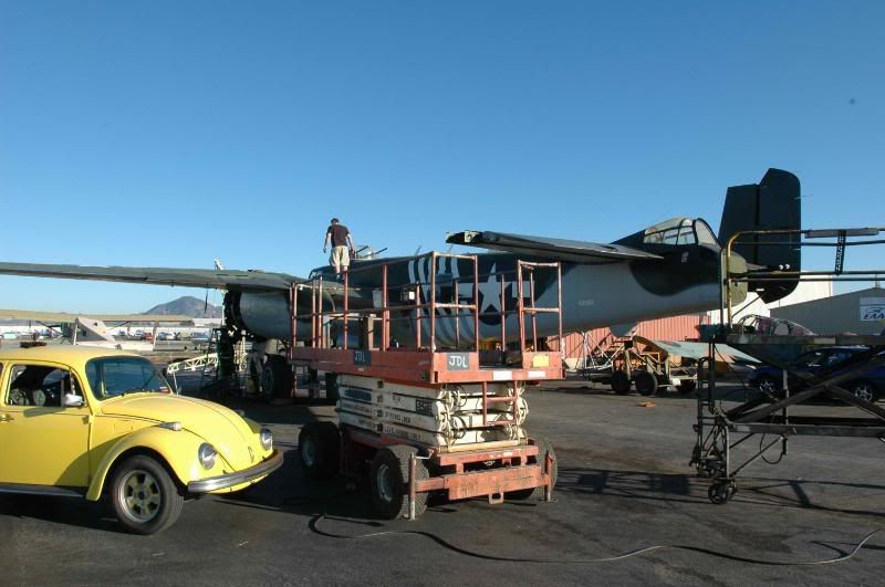

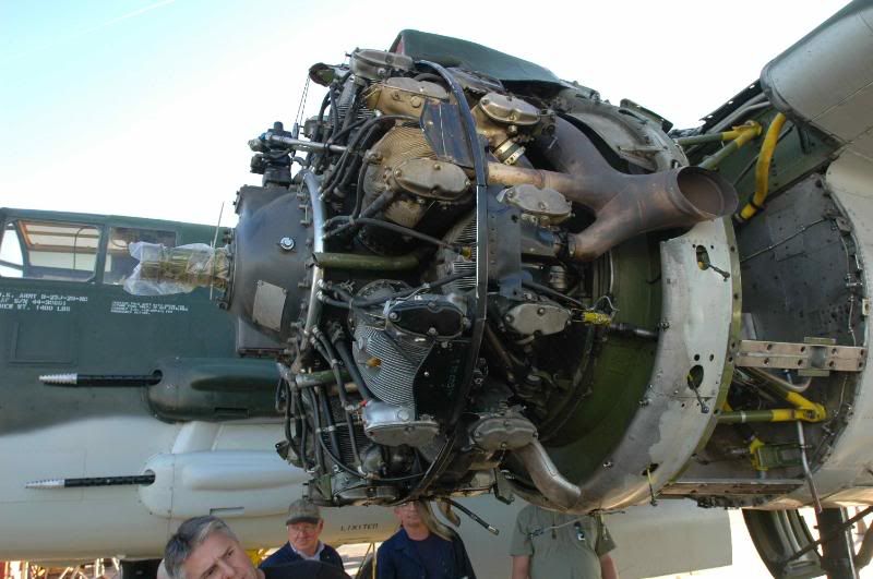

Hey folks , hows your annual going? Heres pics of ours.
Left engine removal for blower overhual
Left Prop Pull for AD
Left Vertical Stab for minor Corrosion pulled.
Right Prop to be pulled for AD
4 Cylinders on Right motor for warranty work
1 Cylinder on Left motor for no choke left.
Some odds and ends and all makes for great photos!

Fascinating images... thanks very much for posting. Looks like you have a lot of work ahead of you! What was the deal with the vertical stabilizers? I had no idea the top section was removable.

Yes and Bottom panels on Verticals are both removal for inspection purposes. Helps when your taking the rudder off too.
That's just a fairing nothing fancy. A couple years ago we had to replace the left verticle stab due to corrosion. I have it hanging in my garage now 8) It seems my idea of in the living room over the couch was not well received by wifey :roll: :roll: :wink:
How do you determine this without removing the cylinder?
The first 13 they pulled off were OK :idea: :roll: :roll: :roll: :wink:

the no choke issue was found after being pulled for not so great compression check. turned out after the pull for that, that we found that out.
