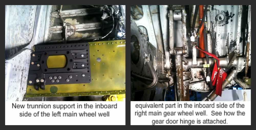

The new trunnion support is nearly installed in the left wheel well. For comparison, look at the existing one in the right wheel well. The right side is going to get a general cleanup, new paint in the well, and the gear will be overhauled as soon as we finish the left side. Outwardly, it doesn't appear that it will take near the effort the other side has. Famous last words, eh? :-) JR
