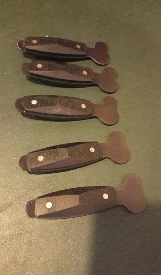

Ohhh look what I have...Official Dennison Enterprises Snoopy Tools. $22 plus shipping. Get you one! :drink3:
I just got two of these in the mail. They are works of art!! (Of course, I shouldn't be surprised, considering who's making them........)

PostPosted: Mon Dec 28, 2015 4:22 pm
Posts: 2151
Location: Utah
so for the mechanically disinclined . . what do you use a Snoopy tool for?
