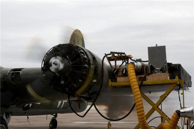

OKEY DOKEY. Engine #1 first start up and high speed run.
Much better methodolgy and Safety Procedures and general coordination this past weekend.
I will entertain you wonderful whacky WIXites first with photos.
(The video is capturing and will follow as the workload allows.)

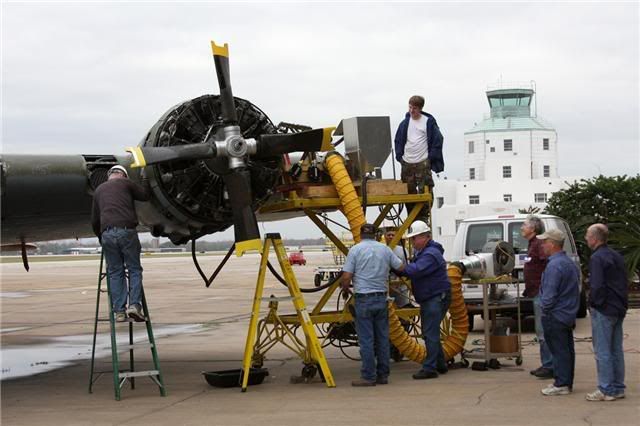

First off helmets were offered to all! Some like meself actually availed ourselves. I and some others had hearing protection, which proved adequate for the low speed runs but nowhere near up to the job for the high speed run. I am looking for my shooting muffs that can swivel so I can STILL wear the helmet. The potential prospect of hot oil or flying bits anywhere near my noggin makes me want the brain bucket.
The run itself... the engine took probably the longest to start BUT was the cleanest and smoothest run of the three.
Our stalwart cockpit crew for this run.
Actual first belching start-up. THIS is clean compared to engines 3 and 4.
