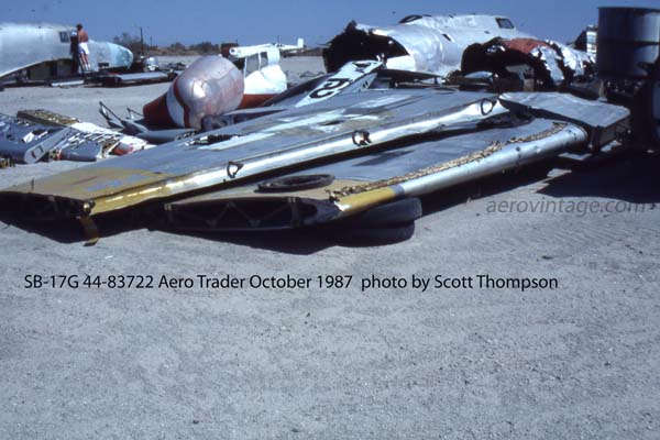

The outer wing panels from 44-83722 at the Aero Trader facility in 1987, still with Air-Sea Rescue markings.

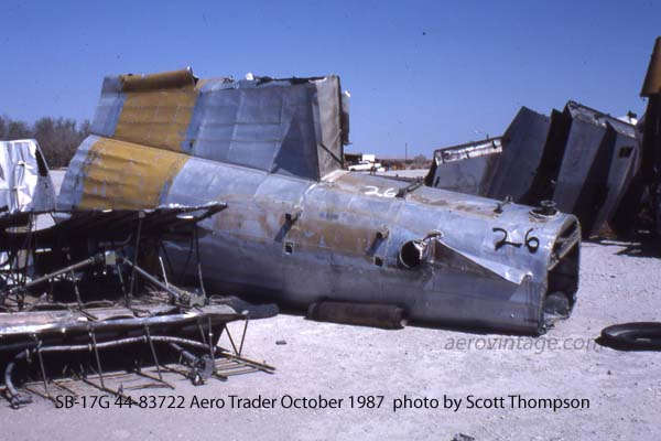

Part of the remaining tail section of 44-83722 and what I think is part of the center section wing structure in the left foreground.

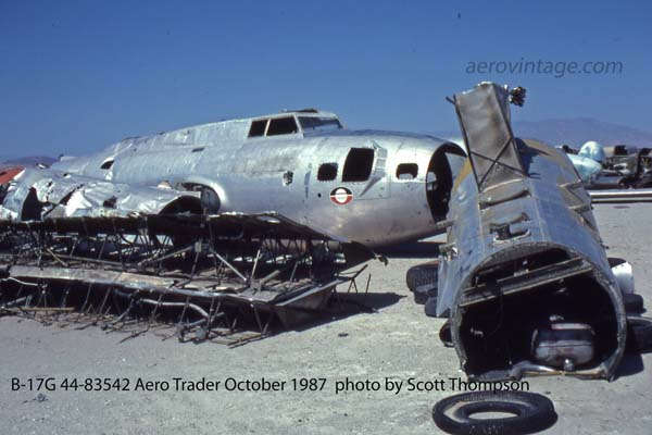

More of that wing structure, another view of the tail, and the remnants of N9324Z (now at Fantasy of Flight)

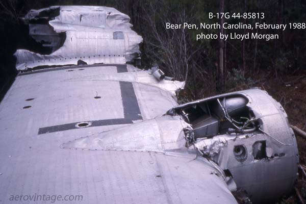

44-85813 at the crash site in 1988....showing much of wing structure intact. It would seem this is where the wing center sections are coming from.
