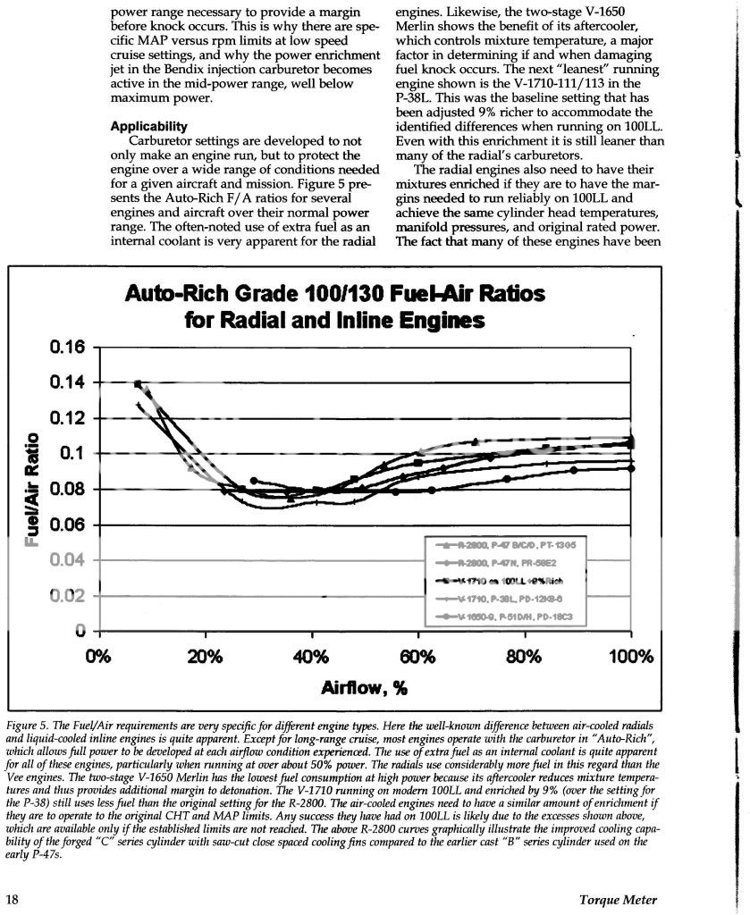

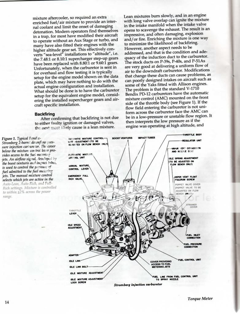

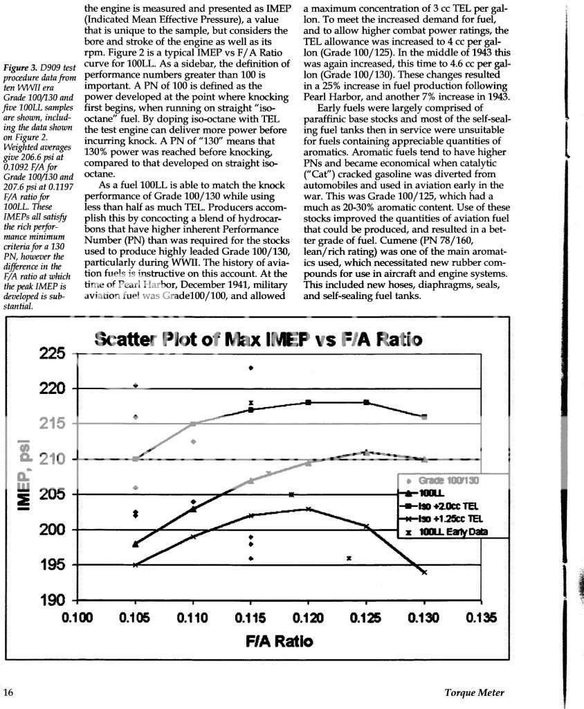

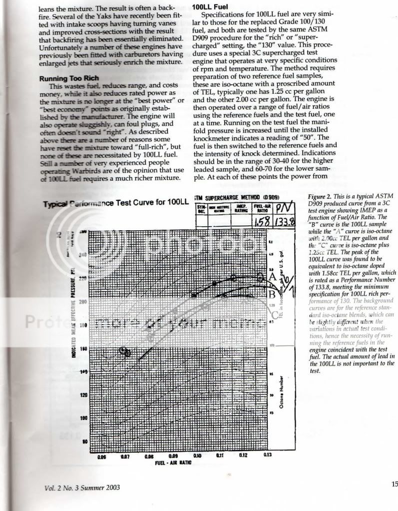

Here is the article about the use of 100LL in warbirds. It is taken from the Aircraft Engine Historical Society newsletter.

B-29, Very interesting, and somewhat complicated.
A quick scan brought out this phrase, "the two stage Merlins seem to be most tolerant of running on 100ll". It appears that much of the problems are with the Allison, not Merlins.
I did not realize that we had 100ll in 1970s , can that be true.? I do recall that when I started flying back in 1978 we had all 3 grades of fuel, reg, a med grade and 100 octane. Thus red was too low, green was good, blue was better, for normal airplanes, I did not start Merlins until 1983.
So there may be something to what all the experts are saying.
BUT A BIG HOWEVER: 1st. this article is really focusing on protecting engines at full power type use, not operating at low boost and low rpm economy cruise, say 1800 and 30 in my plane or perhaps 2000 rpm and 34 in in a P-51.
2nd. The "cure" in this paper ,is to set the carb perhaps 3% to 9% richer or at least make sure that it is set at the upper, (richer) end of the specified range. If this is the practice in the 1970s then perhaps my carb which was part of my Jack Hovey overhaul about 1990 is set to the proper range, and is not super lean.
To summarize my point, is slightly richer carbs for 100 ll, maybe and probably.
Running more rpm even in economy cruise: not proven and probably not needed.
Lastly, we might like to know if 100ll in 2009, is the same as the fuel of this article in the 70s?
Good info, here, anyway, and I am glad that Spitfires are automatic as to mixture and I don't have to fiddle or worry aboutit over the last 26 years. The only fiddling of this type I have done is to adjust the idle speed and mixture with the tow screws on the outside of the carb for ground running, to make it idle nice and slow and smooth.
3rd. Much of our discussion, has been not just mixture settings on 100ll. but the idea that this new fuel requires you to run rpm 50 to 100 rpm richer in LOW POWER CRUISE. This is not in this article and is the part of the new ideology that seems unproven at best to me. I don't see much risk of detonation at these low power settings on 100 ll.
