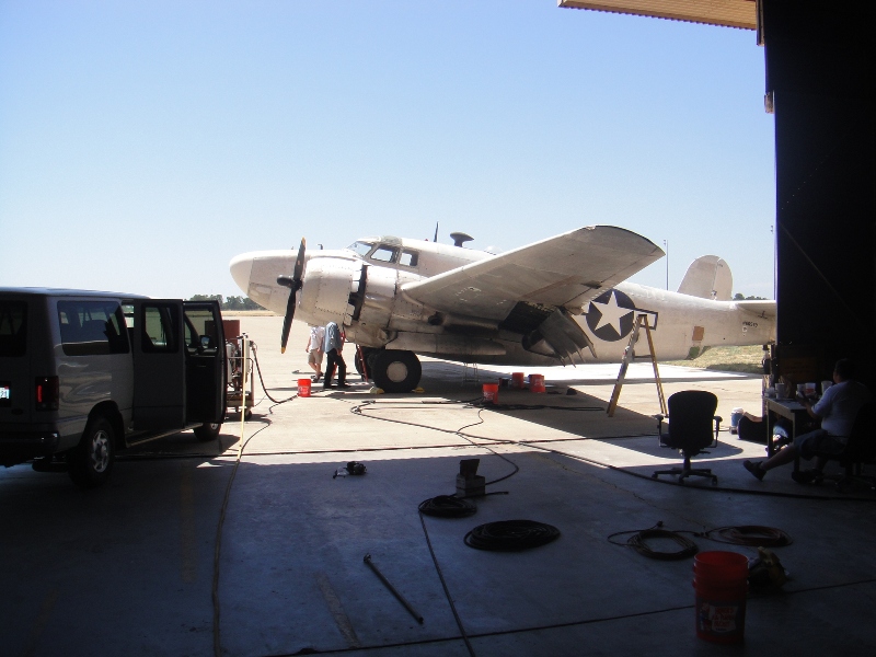

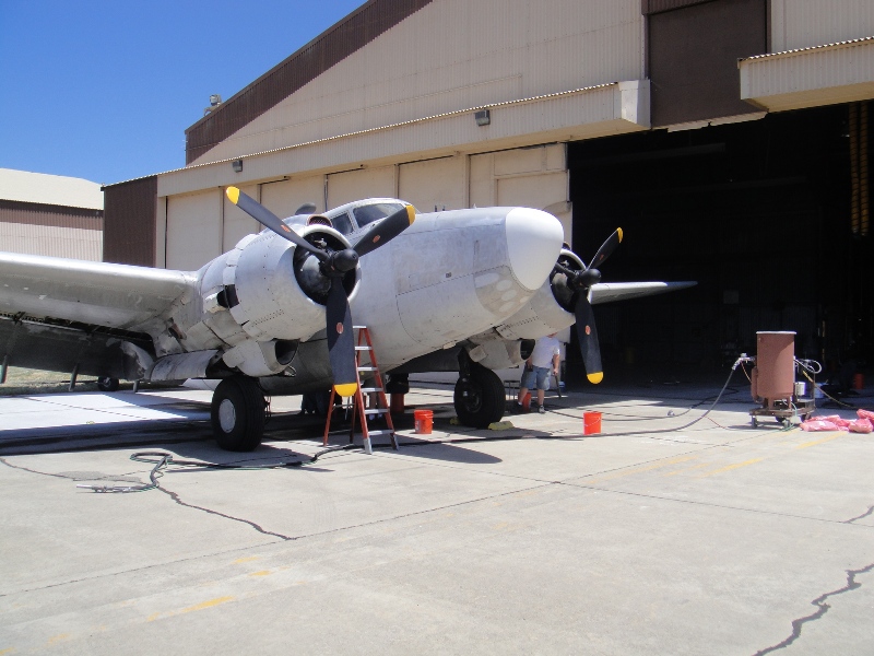

A small amount of progress was made on the old gal yesterday. We are starting the cleaning and prep process for getting her into her non specular sea blue fighting colors, or should I say color. Prep for paint is the longest and most labor intensive part of the painting process. The quality of the finish is directly proportional to quality of the prep work. Since our Harpoon will likely be living outside she needs a good protective finish.
Here is a shot in front of the hangar that we hoped would be available for us to use for the painting process but it was not to be. Oh well.

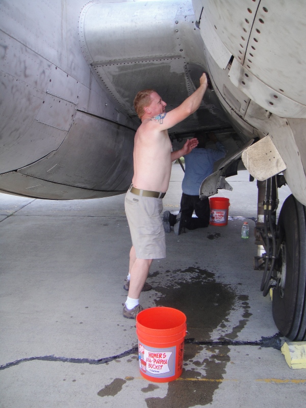

Scrubbing, scouring, soda blasting, cleaning was the order of the day. The soda works well on removing light surface corrosion found on some of the lower surfaces. It works infinitely better than scotch brite by cleaning out any pits. You just have to be sure to blow out and wash out the residue.
Ricky, Sydney and Scott are hard at it
Ken shows off his deep tan from years of working as a life guard at Venice beach... Cool tattoo. Hey Ken, when are you going to stop lurking and start posting?
