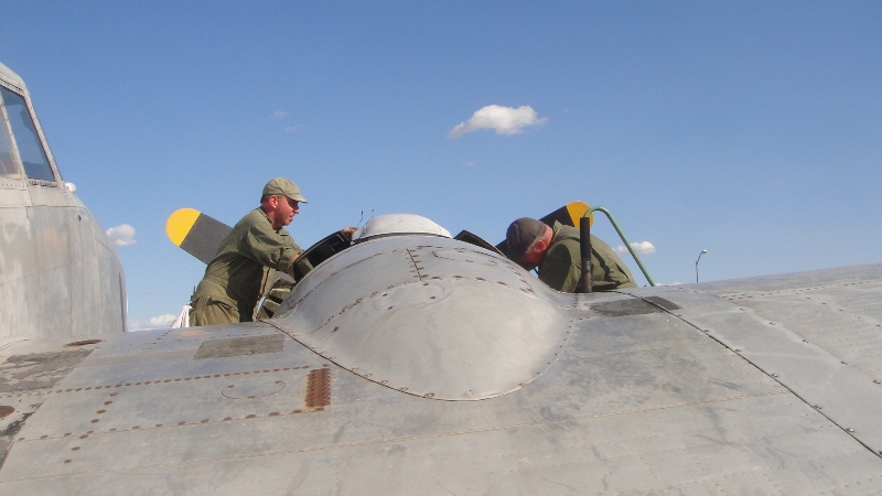

The boys from AZ took a liking to the Harpoon and since we had some time before camp started they put some hours in on the PV-2D. They tore into the right engine and pulled, checked, cleaned, gapped, tested and replaced the spark plugs on the right engine. The right had a slight shake to it and a little higher than normal mag drop indicating a likely plug issue and they fixed it right up. This isn't reenacting but it is the real deal. These guys are a true ground crew and it is a real honor to have them working on the Harpoon or any other project here. Thanks guys!
Here are Scott and Bill pulling plugs
After the new diaphragms in the carbs loosen up with fuel and exercise the mixtures will richen up and will need further adjustment. Ricky and Jimmy worked on adjusting the idle mixtures and they are working great. We took some of the Arizona Ground Crew up for a test hop to check everything out and it was a good flight.
Now both engines are smooth and don't load up while idling.
Thanks guys for the hard work on 062. I think she appreciates it!

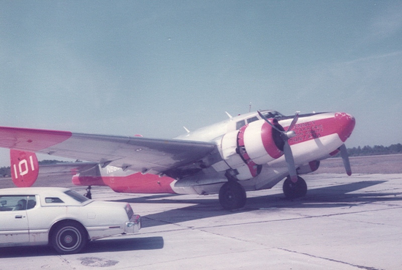

I recently received some photos of tanker 101 in service from 1985. These great photos came from Ken Cabe who worked with the South Carolina Forestry Commission where these pictures came from. Thanks Ken for sending over the photos!
Thank you!
Taigh Ramey
http://www.twinbeech.com
