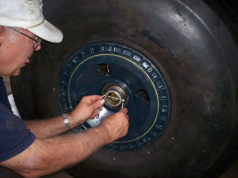

PostPosted: Mon May 25, 2009 11:24 am
Posts: 500
Location: Central Indiana
Here are the two pictures that show the completion of the tire being installed back onto the Harpoon:
