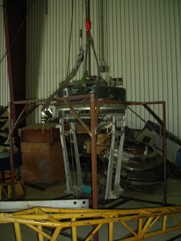

For you turret guys... I will take better pictures later, but this is what I have to offer up. We put the side stanchions on the pedestal and placed the top mechanisim in our handy assembly frame. The sides caused quite a debate, because all of the pictures and manuals we were finding showed the round pipe stanchions. We even visited LSFM and Thunderbird has the pipe style holder uppers. THEN finally I saw a Picture in B17s IN COMBAT that showed our style of turret being set in a shiny new B17G. Good enough for me!
Se we feel confident that we have the right stuff for a G-model top turret.

Joe,
We need some of the details about the closing panels for the sides of our top turret and I am sure there are other details T-squared could use.
Dig out the appropriate manual and PM me about getting together.
If West Houston Airport is easier maybe we can connect up there, OR come see the bomber on Saturdays.
SPANNER
