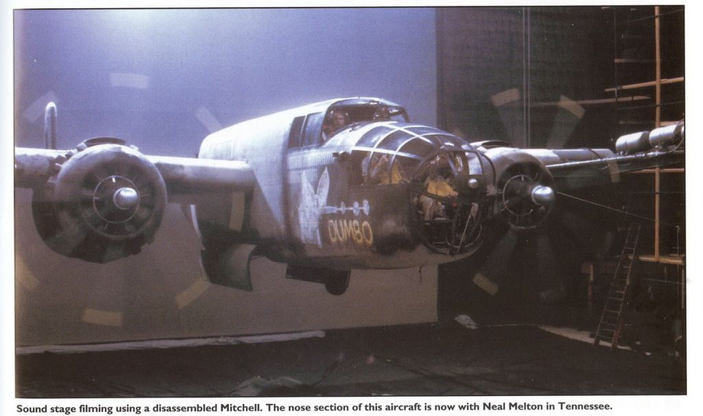

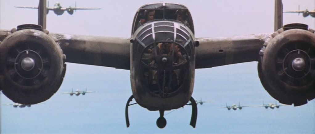

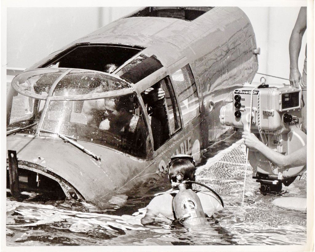

There is a very comprehensive article in Warbirds International, Vol.27/No.4 (Maj/June 2008) about the Mitchells used during the filming of "Catch 22". One of the photos published shows IMHO the same nose section as the one questioned.
The photo copied from the magazine was made during the filming of the bombing raid over the sea with Alan Arkin as Yossarian in the bombardier’s compartment, thus the "Dumbo" nose art.

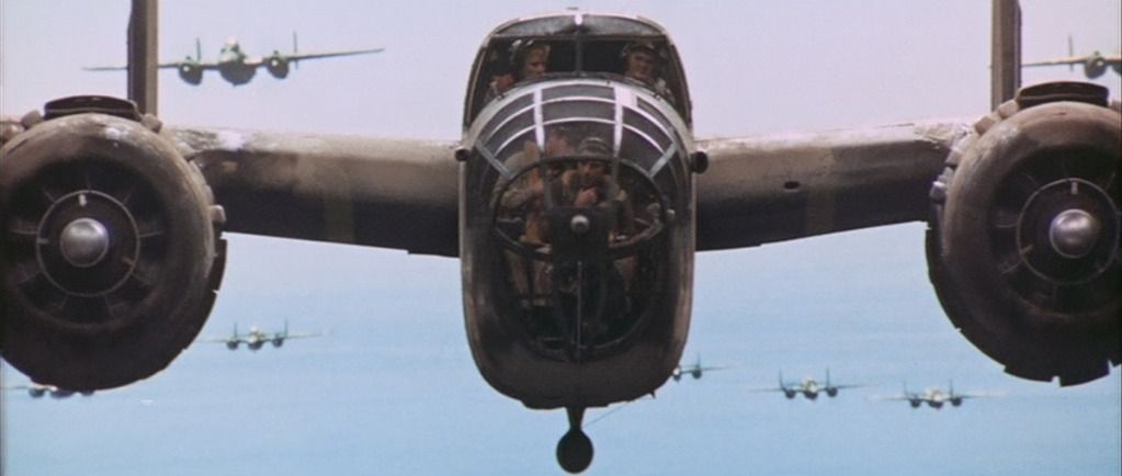

Below are 2 screenshots from my DVD-copy of the movie, showing the same nose section with closed and opened bomb bay doors.
I think this is not the same nose section as in the photos from the Tennessee museum shown in previous posts, nor is it the one mentioned here and here.
As you see the nose section has no top turret, but "football" antenna on the underside of fuselage, the engines (fake or real) have the wide scoops for the Holley carburetors and all Clayton stacks are there. There is no navigator's window too. I think the nose has no real glazing (probably for the filming purposes), but some transparent plastic foil or similar material. There is a visible center frame for the front roof window (as stated in a post earlier).

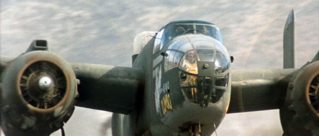

The real "Dumbo" in the movie is a different a/c - see another screenshot below:
Note the high airscoops fot the Bendix carburetors and the second opening for a nose gun in the bombardiers section. The roof window is one piece with no center frame. Based on several sources "Dumbo" has the original s/n 44-30493, registration N9451Z and was coded 6V in the movie. BTW this was one of the few odd "movie mods" with the dorsal turret mounted behind the wing.

Gary, this was exactly my point - the nose is not from the "Dumbo" in the movie, but the same as in the sinking scene. If you check carefully, even the "Dumbo" lettering on the original a/c slightly differs from the one on the nose section.
Jerry O'Neill wrote:
That studio shot does look a bit like the same cockpit, especially with the wiper location.
Jerry I'm positive this is the same part and it has nothing to do with the filming in Mexico and the Mitchells there. I went through the director's commentary of the movie yesterday and Mike Nichols speaks of the "full frontal scene" during the bombing raid and how he did it in the studio for the very first time, but there are no details about those shots made in the Paramount studios.

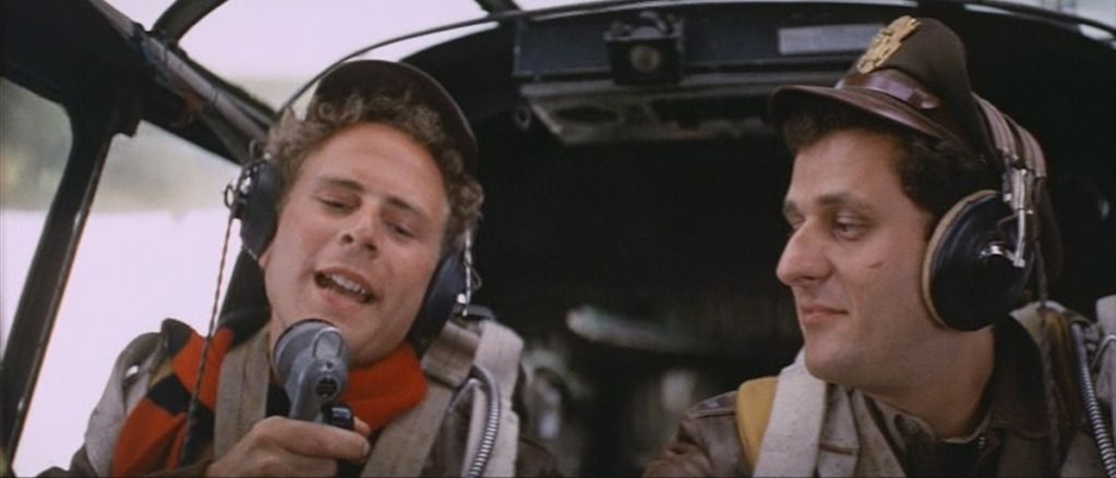

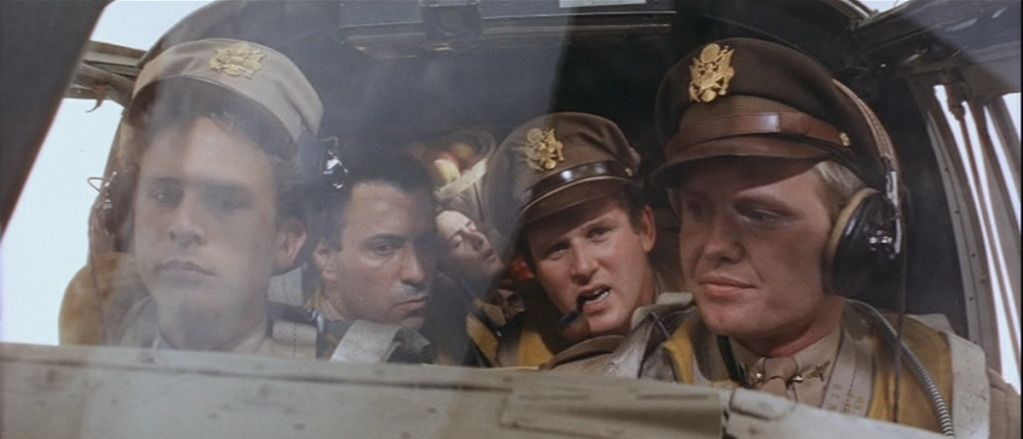

There are several more cockpit shots in the movie and IMHO they were done with a different nose section, eventually the one in the Tennessee museum, being also a part of an earlier B-25 type (C/D). Take a look at the overhead glazing in this 2 screen shots:

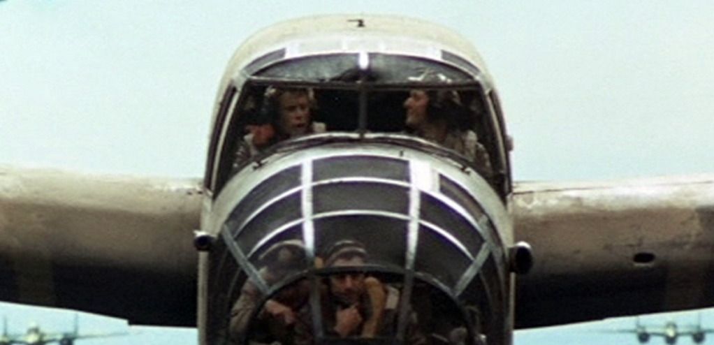

There are clear parts over the rear windows and behind the escape hatch. These parts are solid by the B-25J models:
They are also solid on the nose section used for the bombing raid and in the ditching scene.
Where is this second nose (from a B-25J) today is a good question. :roll:
