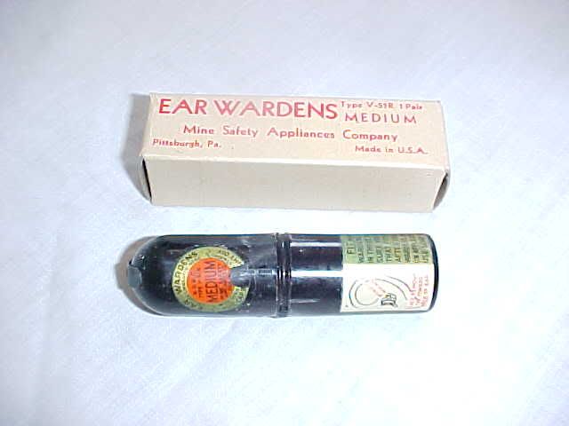

Actually Ob the issue earpugs are simular to the ones issued in the 80's ans STILL issued today!
Scott
http://i16.photobucket.com/albums/b12/c ... 0PLUGS.jpg

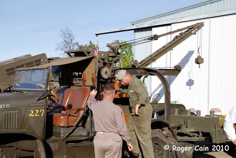

adding a few more pictures, hopefully photobucket is kind to their quality.

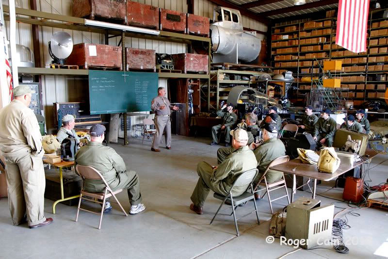

Ground School
Sleeping quarters (don't ask about the nylons)
Bomb handling trucks
Preflight Safety briefing
Fun time

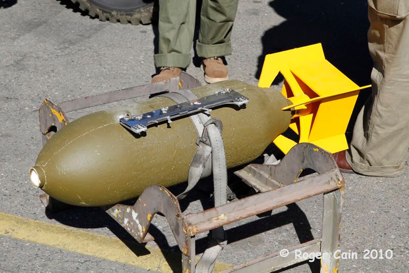

The Ballistic tables came from eBay (god I love eBay!!) in one lot that had books for all of the WWII air drop ordnance. We made a casting of a real 250 LB GP bomb and made wood fins as close to the original as possible but I am sure the ballistics are not perfect for our concrete replicas.
