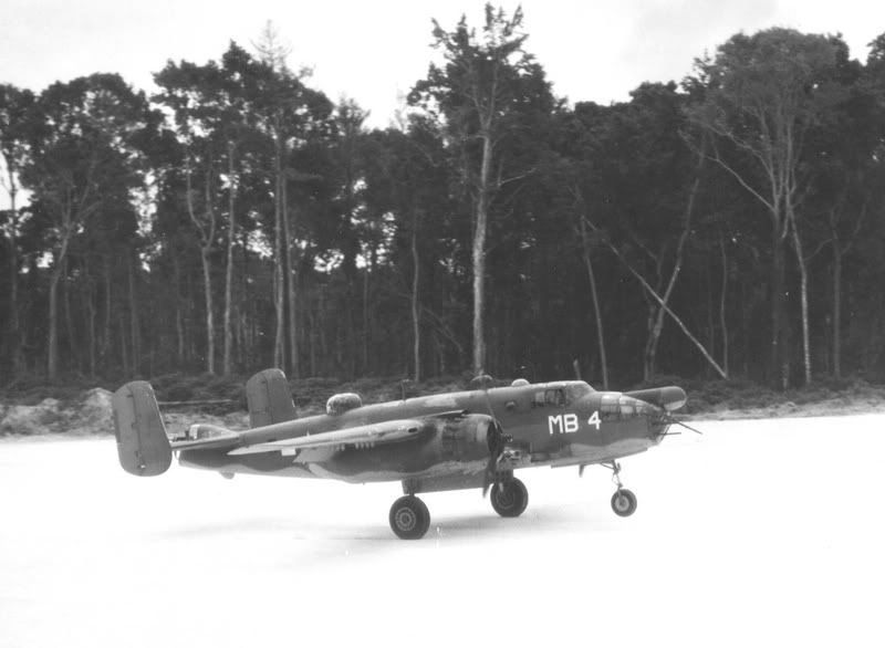

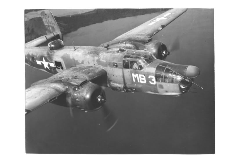

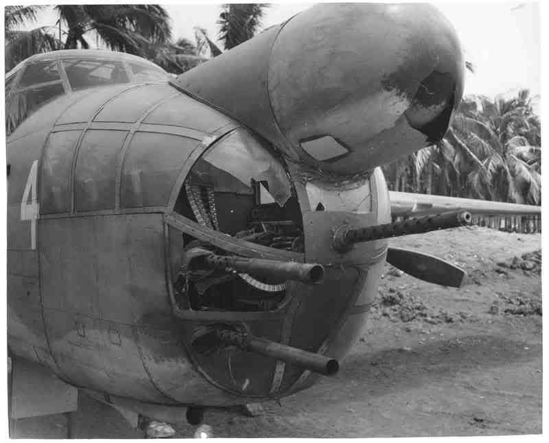

VMB-611's PBJ-1D models had solid dual mounted .50s in the nose, as well as two .50 package guns on both sides, giving them seven .50s forward that they did use successfully in low-level strafing attacks. Also notice the waist gunports on MB 3...not common on the "D", but VMB-611's PBJs were modified to add the waist guns, as well as 5in rocket "hard-points" being added, as on MB 4.

Notice that none of those pictures with the stacked nose guns have the bombardiers floor window.
