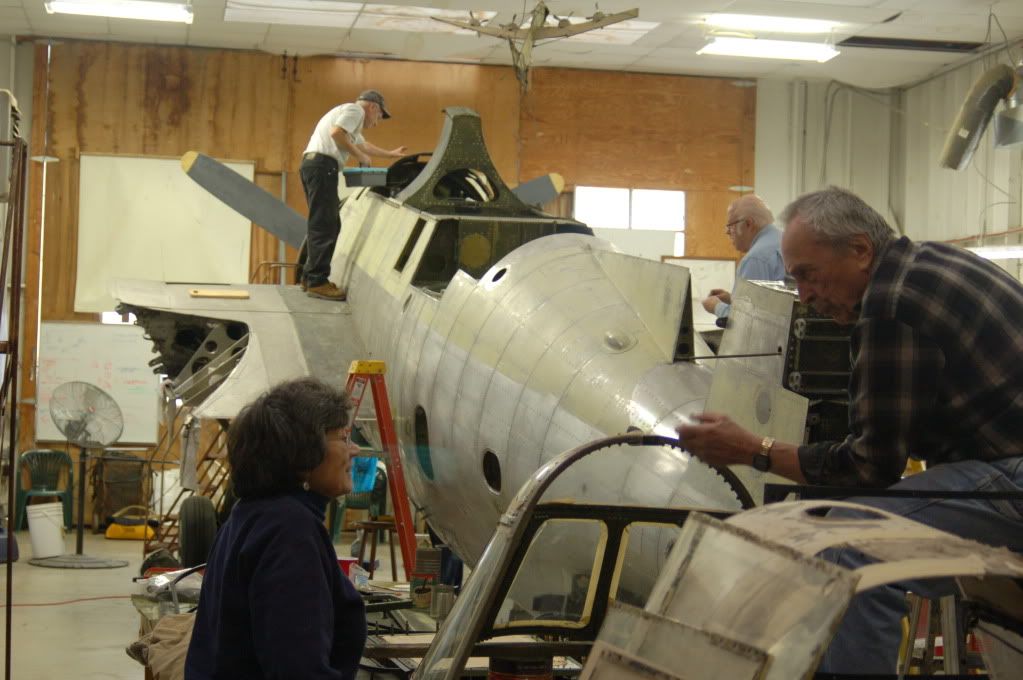

Hey Gang,

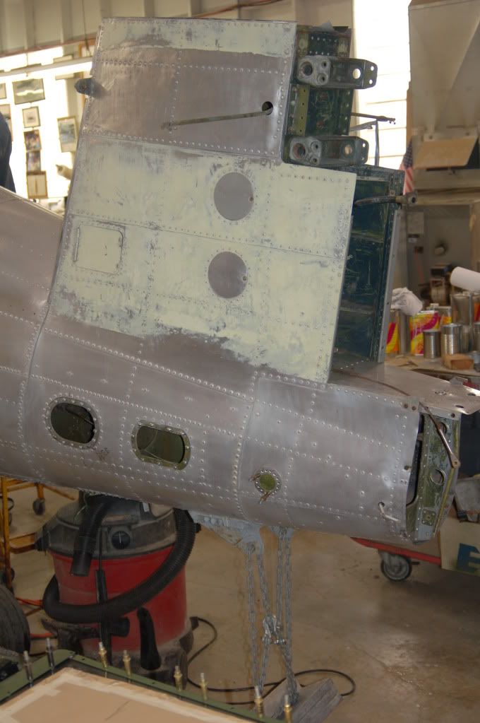

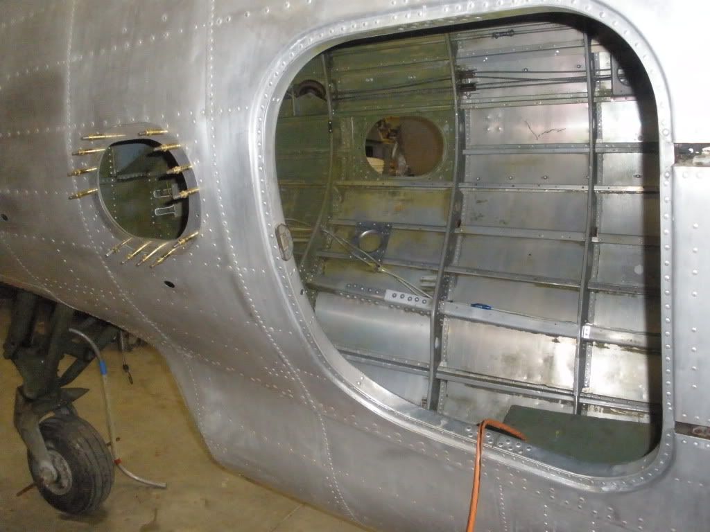

There has been a lot of progress lately. We will try to keep the photos coming. Bomb Bay and Radio Operator / Bombardier's Compartment should be painted by the time we get the next photos up. Then all new Hoses and wiring will be installed through out the aircraft. Several thousands of dollars has been spent on new cockpit instrumentation which will be sent out for the appropriate silk screening. We did find a CDIA clock and replacement fuel gauge. Thanks Richard!

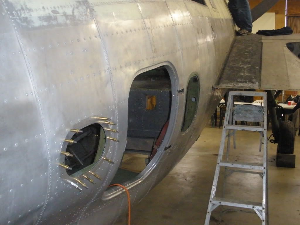

All of the radio operator's compartment windows were covered over by
the Canadian Navy when they did the conversion to a AS-3M. Here we are putting those windows back into place.

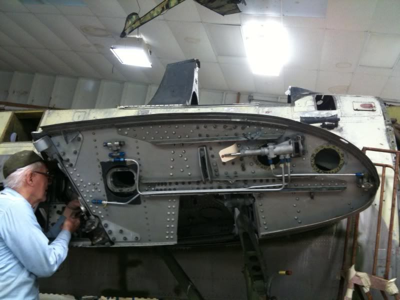

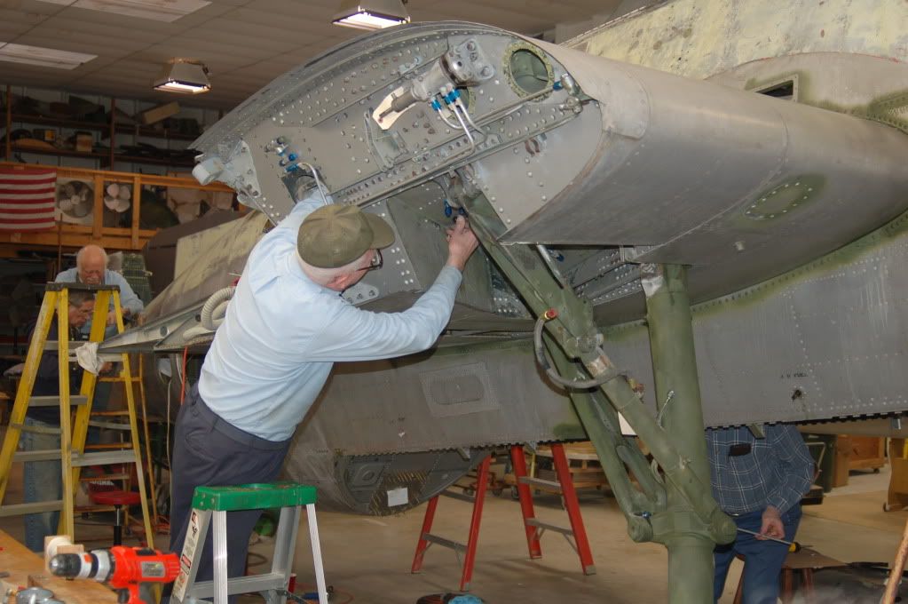

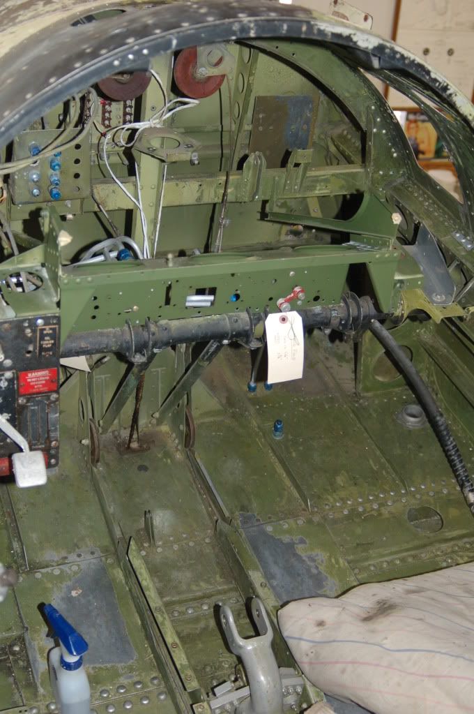

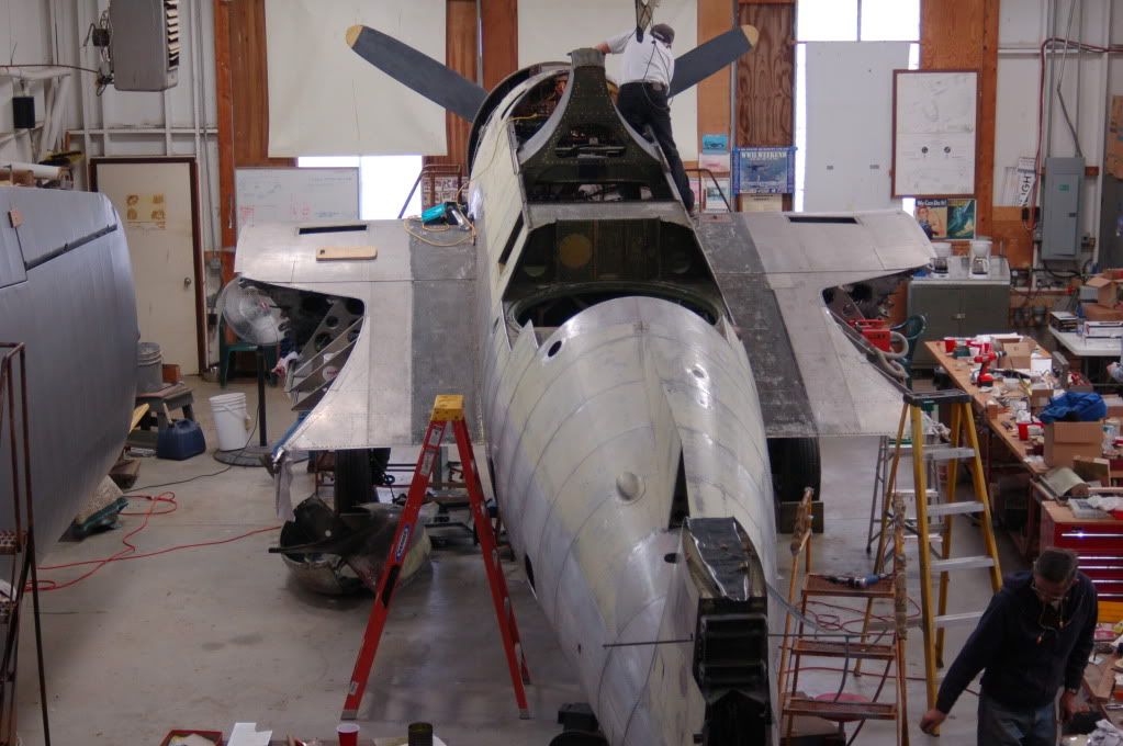

Fuselage with the Canopy removed for repair and restoration Dec 2009
Wing Fold Hydraulic Lines being installed Dec 2009
Fuselage repair
Overall view Dec 2009

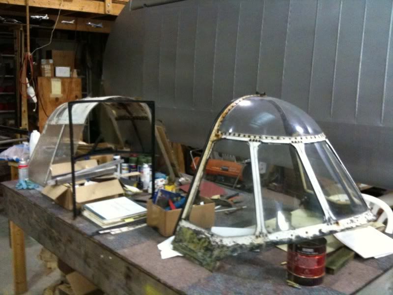

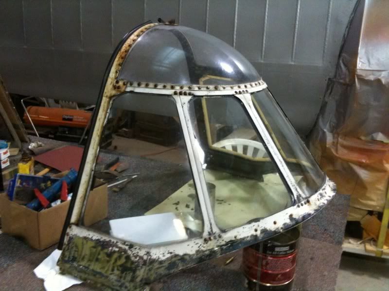

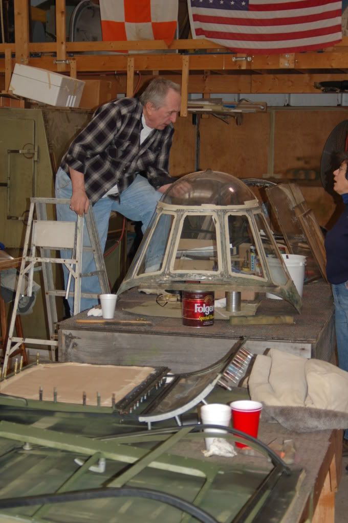

Dec 2009 Front Windscreen
Dec 2009 Canopy rebuild

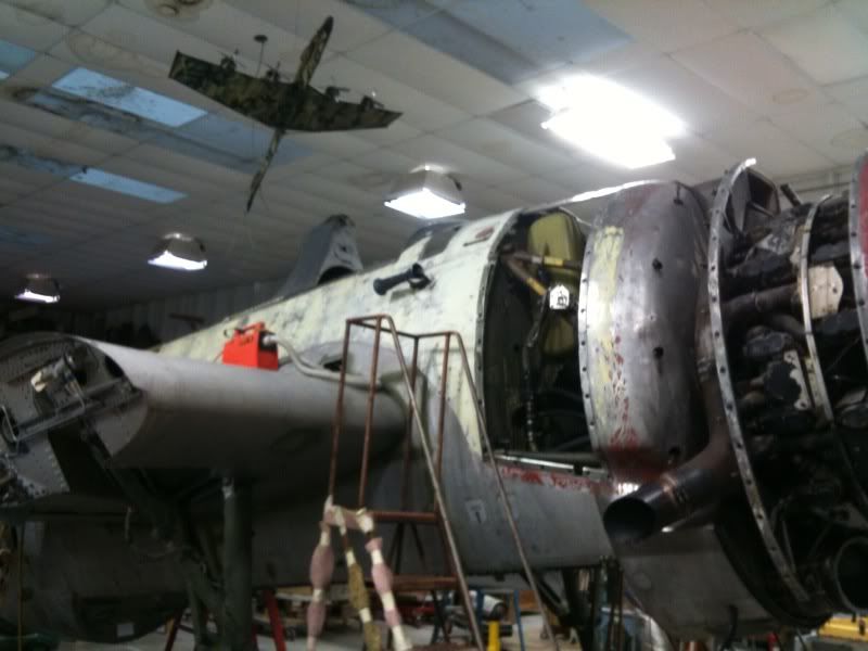

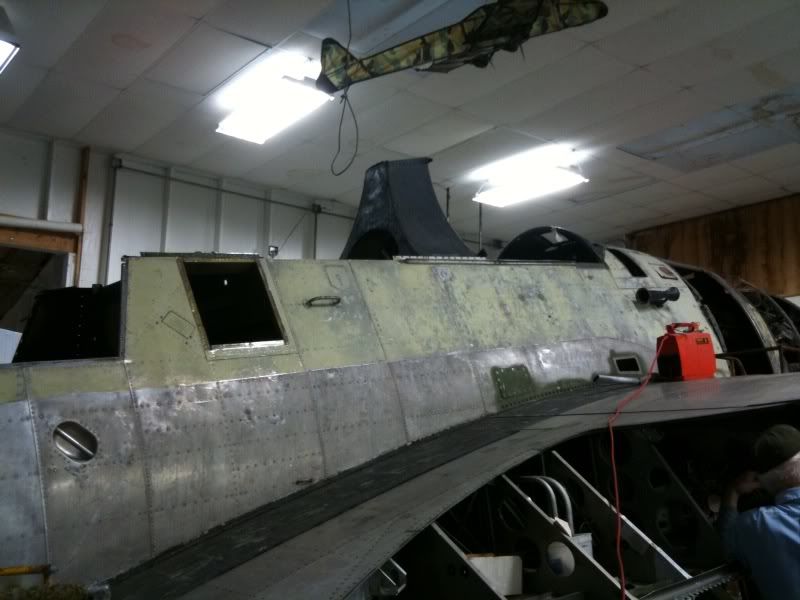

Dec 2009 Port Side Without Canopy
Dec 2009 Center Green House rebuild

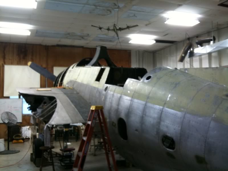

Updated January 2010 Photos-- Getting ready for some primer in many locations.
All new cockpit instruments delivered for new instrument panel build up.

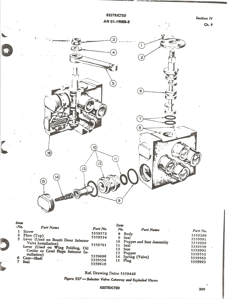

NEED WING FOLD HYDRAULIC SEQUENCING VALVE!! HELP!!
pn 5359446
ALSO LIFE RAFT DOORS AND A REAR SEAT
PLEASE PM ME WITH ANY ASSISTANCE!!!!
PostPosted: Thu Feb 04, 2010 8:50 pm
Joined: Tue Nov 08, 2005 9:22 pm
Posts: 83
Location: Northern Virginia, USA
NEED THE FOLLOWING HYDRAULIC VALVE;
IT IS A DELCO PN 5359446 USED FOR THE COWL FLAPS, OIL COOLER DOOR, BOMB BAY DOOR AND WING FOLD ON THE TBM.
ALSO NEED A REAR SEAT FOR THE TBM
HELP!!! JOHNRFUENTES@AOL.COM
