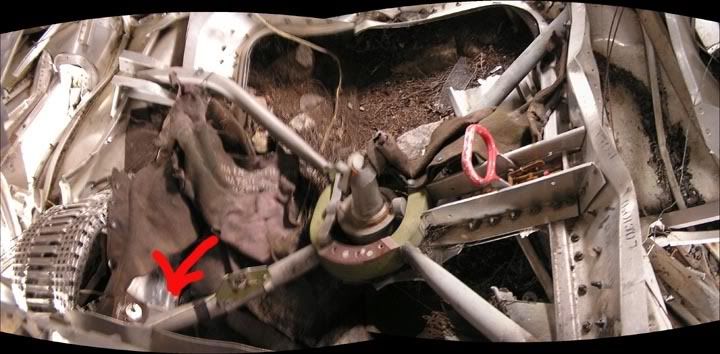

http://www.nps.gov/archive/yuch/Expanded/b24/b24_graphics/august_2004_pics/Panarama_Main_Entry_Hatch_large.jpg
Gary;
The wire is running along the front support tube to a bracket. just to the right of the ammo feed belt. I hope the link works.
Scott.....

To whom ever;
Thank you for putting the arrow in the photograph. I can work on 20 million dollar airplanes, but I am still an bonehead when it comes to working on the confuser and photoshop.
Scott.......
PostPosted: Sat Dec 30, 2006 11:03 pm
Posts: 5627
RNDMTRS4EVR wrote:
To whom ever;
Scott.......
My pleasure. :)
