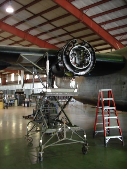

This is a very useful stand, it allows you to place the engine into a position vertical or horizontal. It is a wonderful piece of equipment while removing jugs.

Hi Jason and welcome aboard! What's the latest on the engine? When do you expect Ole 927 to be back in one piece again?
Thanks for all your hard work!
If all goes well we should have her ready by the end of May. The #3 Engine should be here by the second week of May.

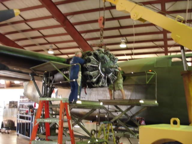

T-6G Pilot wrote:
A little bird tells me the engine is done and on its way to Midland. Any truth to the rumor?????

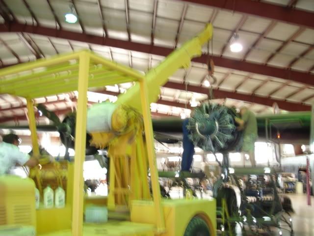

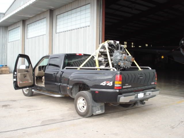

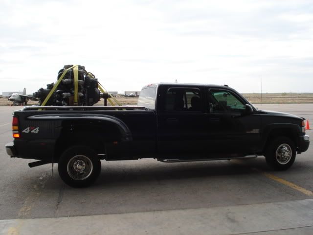

The engine is here and we are in the process of hanging it today.
It is going to be a very busy week, but I will try and get pictures up and fill you all in on the details.

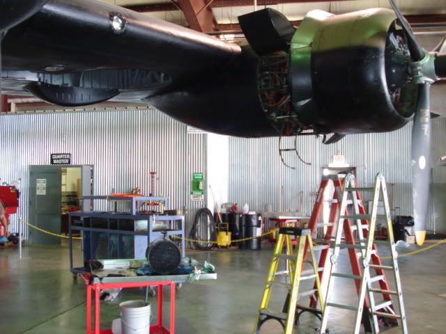

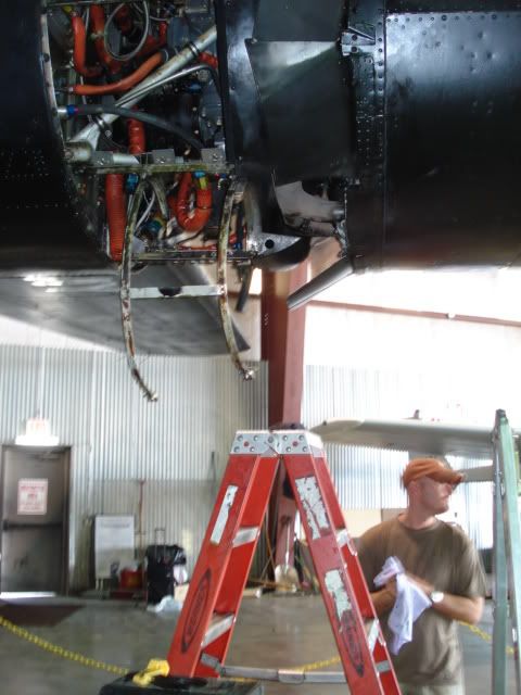

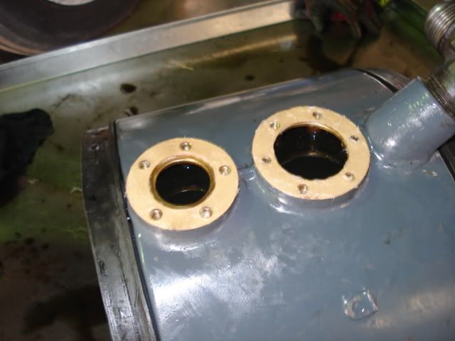

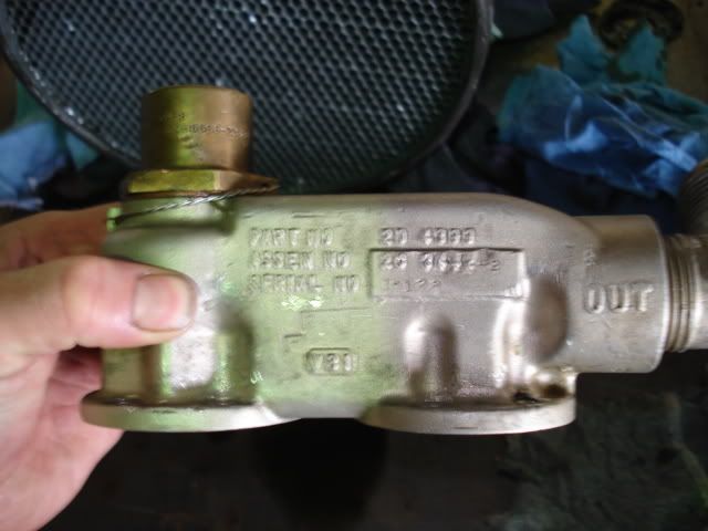

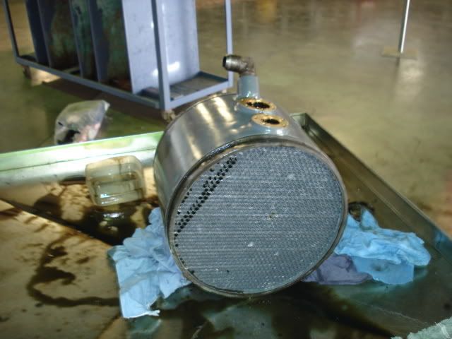

My brother Jarod and I managed to get the oil cooler gasket changed on Engine #1.
He brought Engine #3 in and decided to stay for a few days and give me a hand so I got him covered in oil the first day with the cooler. I have to admit I was laughing to myself over that.
We had a fight on our hands with the hanging of the cooler after replacing the gaskets under the valve assy.
Sorry there aren't more pictures, but its hard to hold up a cooler and take pictures at the same time.

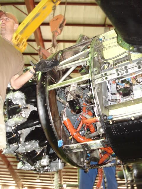

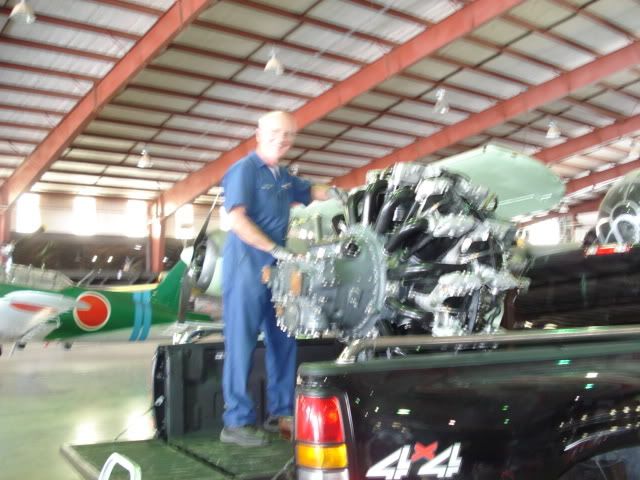

Jarod got the engine here safe and sound.
John is back in town give us a hand (Thank You!)
Sorry, I meant to get pictures of the installation of the accessories, but I was busy and didn't get any. I will check if John took any pictures and post them.
I took a few blurry photos... sorry everyone.

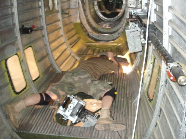

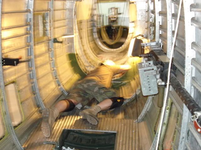

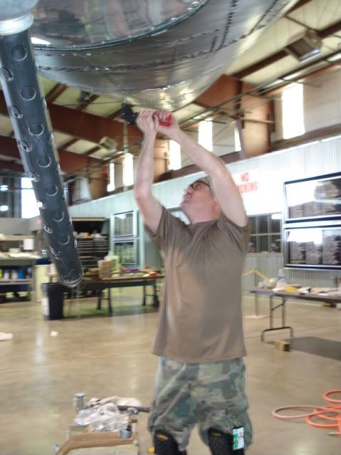

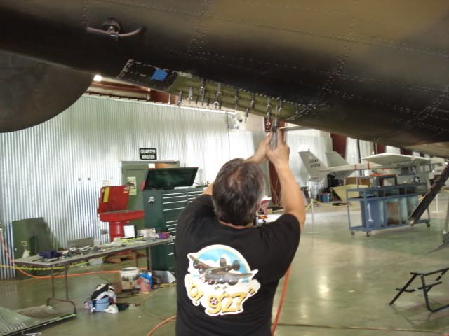

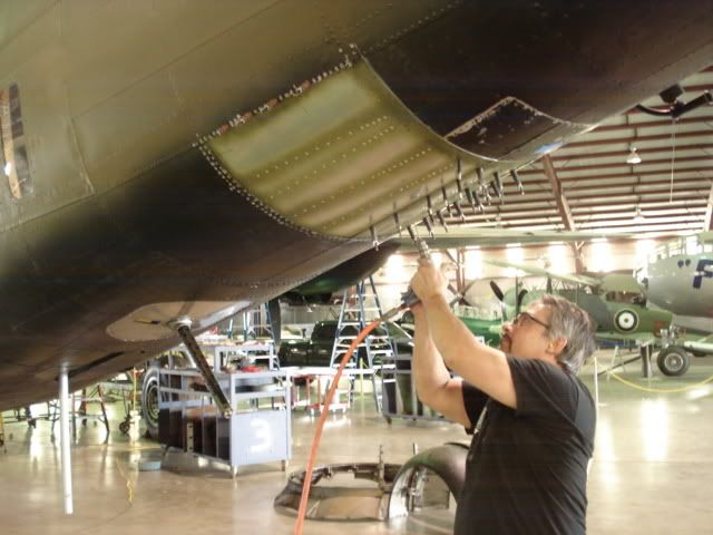

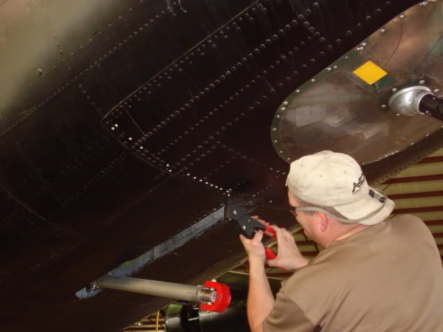

Daniel made it and the riveting has begun!
The other side of the rivet process.
Skeeter wanted nothing to do with the riveting, but a nap was just fine on Gray's desk.
This was my work station for most of the day.

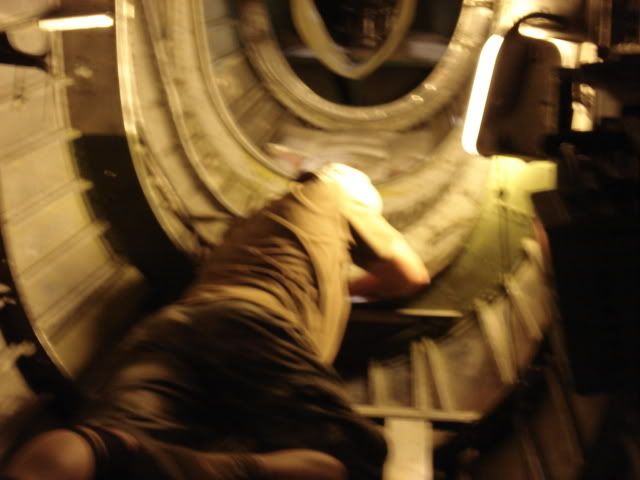

I was sore the next two days for sure after rolling around in the tail for the backside of the rivet process.
Hand riveting locations we couldn't reach
Cats have had a hard day?!

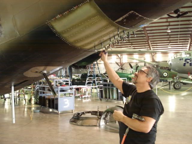

PostPosted: Thu May 15, 2008 10:33 am
I like Gary's fancy new office! :)
Where did Daniel get that shirt? 8)
PostPosted: Thu May 15, 2008 10:43 am
Posts: 4468
Thanks. I like it too.......when I'm leaving.
I had them made last winter, along with some that have the Squadron logo on them. Since I had to pay for them out of my pocket, I only had a few made and only the frequent workers (all 5 of them :roll: ) got shirts.
