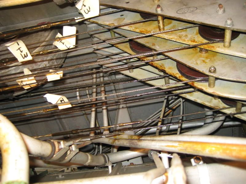

Well, we worked on the B-17 a little this weekend. Very little, as it turned out. Most of the crew ended up reorganizing some space in the other hangar to make room in the main museum hangar. I crawled under the cockpit aft floor in order to start working on the engine control cables. Here is a shot of one side, the other looks much the same. All the masking tape is my farmboy labeling system. :roll:

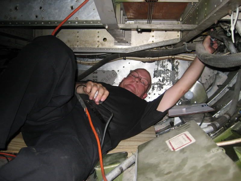

And here is the less-than-comfortable workspace I'll be in for a number of hours tweaking turnbuckles. By the way, it was around 100 degrees already when Ellen took this photo, on the way to 105:

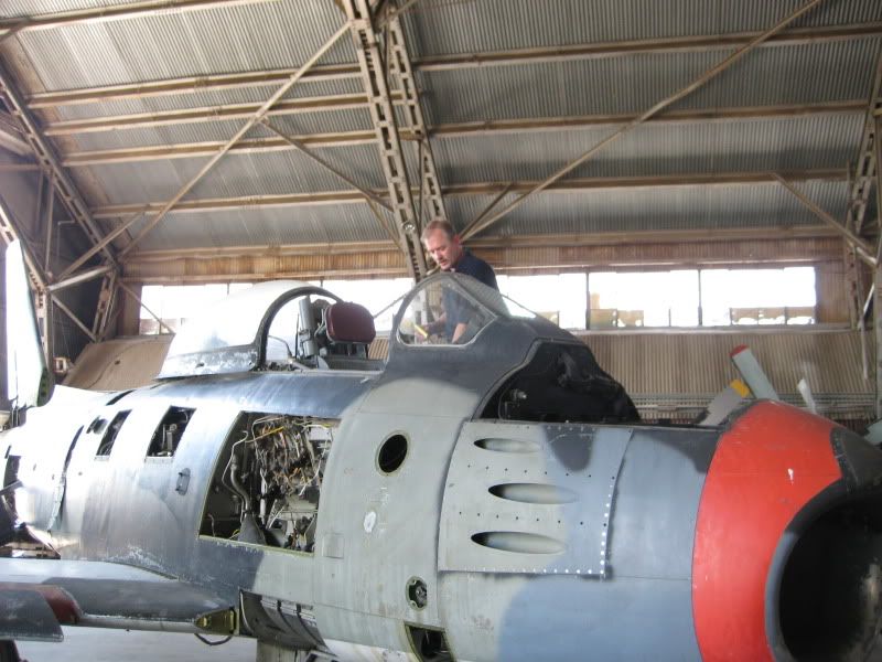

We had fellow WIXer, Sabremech, come by to look over our F-86F. I really, really appreciate having him spend a good part of Saturday giving the little jet a good looking over for us. His inspection and opinion of the airframe was good news and bad news.....it looks like the Sabre is a good candidate for restoration to airworthiness. That's the good news--the bad news is that now I have to start raising money and finding benefactors to make it happen. It'll be a long term project, but I'm hopeful we can put together the financial backing that will get the jet back in the air sometime in the future. Thanks again, David, I'm in your debt.

Thank you for the hospitality and for letting me drool on your Sabre. As I said when I was there, what a time capsule. This will make an excellent airworthy Sabre. Let me know what I can do to help you guys reach your goal. Sorry I didn't have the time to make it to the North hangar. I'll be back for a week the first part of November and will stop by and spend some more time around the VFM birds.

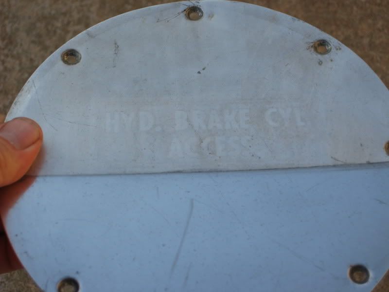

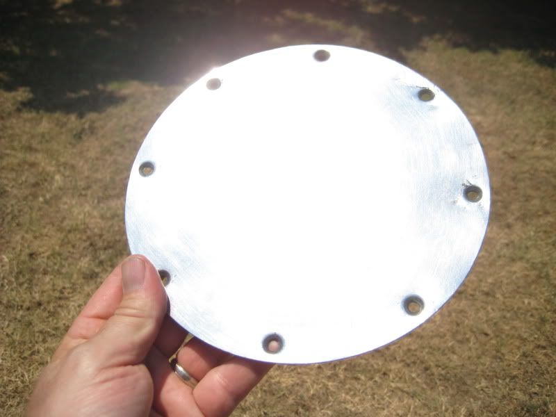

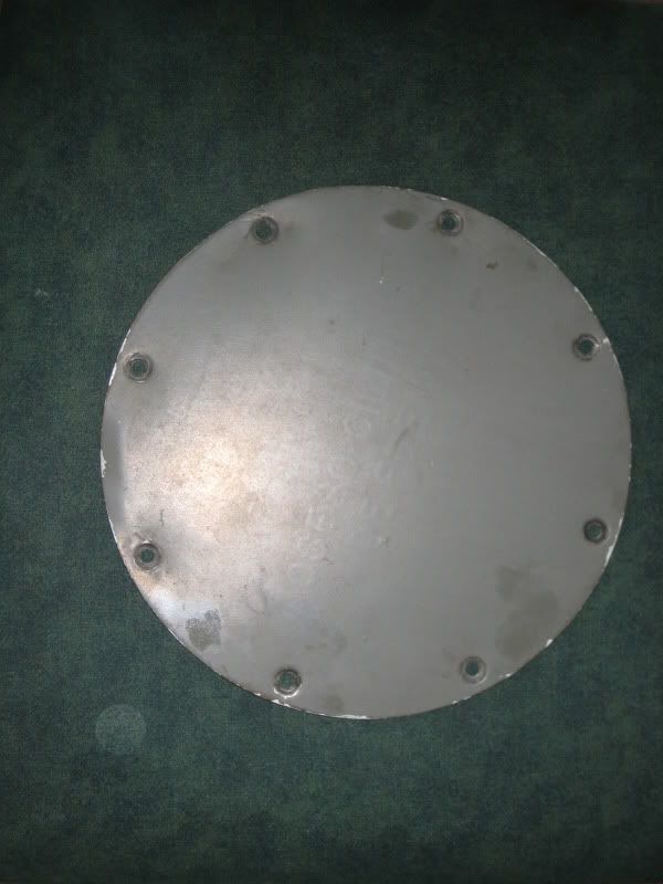

We talked a little about whether we should strip and polish the airplane. Here is the first result of my effort to find out if it is feasible. I decided to pull an access panel that got plenty of use/abuse during her service life so I could evaluate the surface. This is the brake cylinder access panel that lives on the side of the fuselage.
As found, with four layers of paint:
When I stripped the paint off I was able to find two camouflage colors, a heavy silver coat, and that odd gold tint/primer coat on top of the Alclad. Each coat of paint was very professionally applied, and I was really relieved to find that the base metal hadn't been etched or sanded before the gold tint and silver went on. I also found a stencil on the second green coat that read "Accesso Cilindro De Freno". You can make out the lettering if you look carefully.
Here is the stripped panel with the original North American-applied "Hyd. Brake Cyl. Access" lettering. I started to polish the lower part of the panel out of sheer impatience before I found my camera:
And here are two photos of the final product:
It didn't polish up too badly even though there are numerous scratches and screwdriver marks on it. It took me a couple of hours to strip and polish this little 9-inch plate, so you have some idea of the magnitude of stripping the entire ship, not to mention the environmental B.S. I'm sure will go along with the process. If I get enough enthusiastic volunteers I suppose we could strip it, but I'm afraid the enthusiasm will drop off pretty rapidly when we start stripping the undersides of things....... :Hangman:
