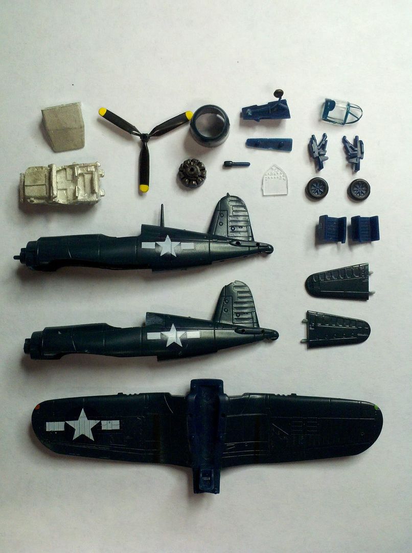

PostPosted: Tue Mar 08, 2011 10:53 am
Posts: 5221
Scott,
Okay I finally got a pic of all the parts that come with the Bandai Corsair, with the addition of a second modified fuselage. I also threw in a N Scale 4x4 Jeep which I was also hoping to resin cast. Love to hear your opinion on the matter of casting all these parts. In reality we could omit some of the smaller parts that you wouldn't necessarily see when doing a large scale diorama.
Parts:
1x Set of Wings (One solid molded piece)
2x Fuselages (1 Original F4U-1D and 1 modified to F4U-1A "Birdcage")
1x Propeller
1x R-2800
1x Cowling
1x Prop Hub & Shaft (hehe.......shaft)
1x Instrument Panel
1x Tail Gear
1x Tail Gear Doors (Closed)
1x Canopy
2x Landing Gear Struts (L&R)
2x Gear Doors (L&R)
2x Wheels
2x Horizontal Stabilizers (L&R)
Bonus:
1x N Scale Willys 4x4 Jeep w. Canvas Cover
Let me know what you think.
