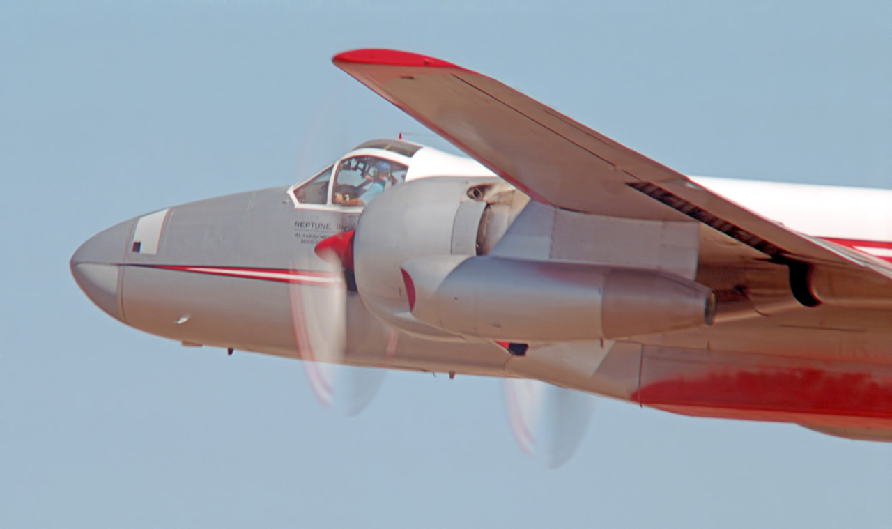

Great photos!
Got me thinking about the jet-pak on the C-119's. Seems the entire pylon and J-34 was taken from the P2V and put atop the C-111 spine.
What all was to the Jet-pak? Structural reinforcement to the fuselage? Fuel lines running from a certain tank? Booster pump required, or a pressurized fuel system? Any issues with running the engine "upside down"?
 Post subject: Re: Greybull
PostPosted: Fri Dec 04, 2020 11:01 am
Posts: 11336
The engine was likely not run upside down. Besides the reinforcements, fuel and electrical systems you mention, extensive flight testing was probably also required.
PostPosted: Fri Dec 04, 2020 10:00 pm
Posts: 262
The P2 pylon is switched from the top of the P2 nacelle to the bottom of the C-119 nacelle and modified to fit the top of the fuselage instead of the bottom of the wing
