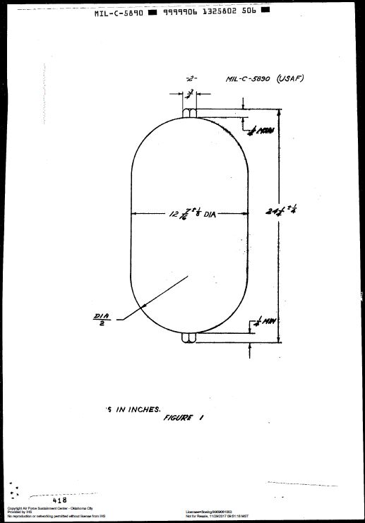

Anyone have any specs, documents or anything else that gives dimensions for the various sized O2 bottles used in the war? The AT uses 3 of the G-1 cylinders, which are about 13" in diameter and 24" in length, and 1 F-1 cylinder, along with 3 portable units. So far, I've struck out on finding dimensions or even a photo of an F-1 cylinder. Anyone have anything that gives the info or even a photo? The portable info will have to wait until I can get into the drawings and see if they are specified there.

You mean these?????
File comment: MIL-C-5888 Type F-1
File comment: MIL-C-5890 Type G-1

Thanks Brandon. That helps a bunch. I see that MIL-C-5888 has been superseded by MIL-DTL-5886, so I was able to find some of the other data that I needed. Quick question....does your copy of 5888 show that it superseded a previous spec? The info that I could find shows that 5888 came about in 1951 and it's linage might show the Air Corp spec from WW2. I know a bunch of my electrical parts call outs reference Air Corp Specs in a 94-xxxxx series, which I haven't been able to find a source for, along with some early AN30xx specs.
