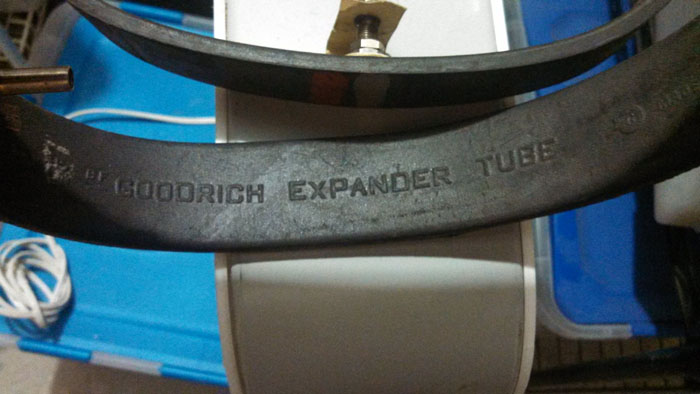

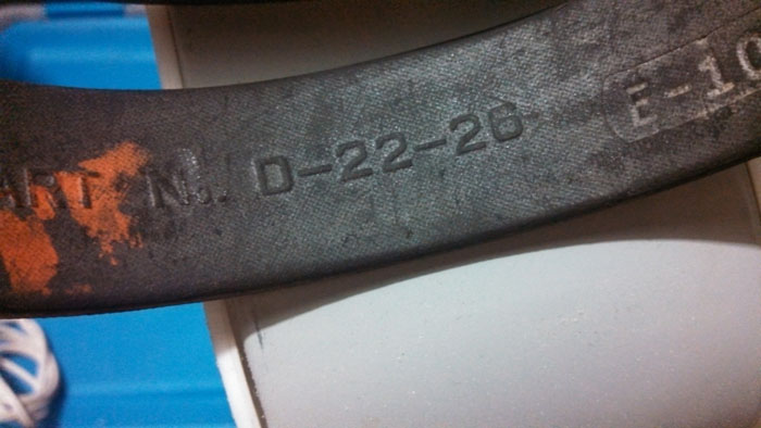

PostPosted: Fri Jun 16, 2017 10:49 am
Posts: 3236
Two.

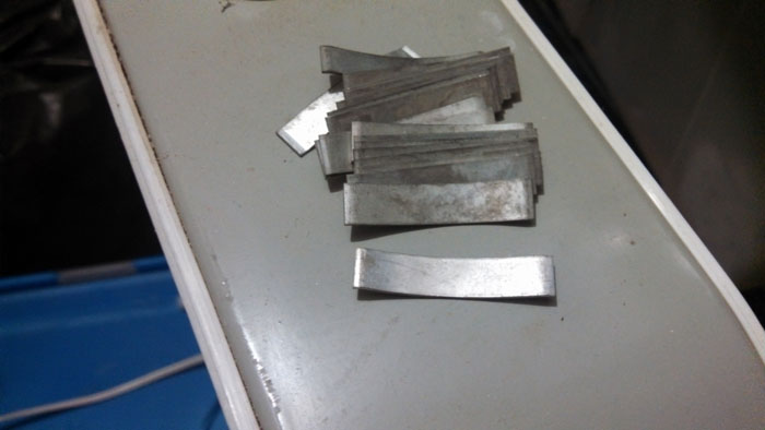

PostPosted: Fri Jun 16, 2017 10:50 am
Posts: 3236
Three.

PostPosted: Wed Oct 25, 2017 1:02 pm
Posts: 3236
Hi, Steve.
I have the brake pads (18 of them, I believe) as well as a similar number of the metallic spring thingies.
No expander tubes left, though.
