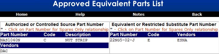

Part number 22NG5-02 was made by ESNA, or the Elastic Stop Nut of America company. According to the attachment .jpg, this is an NAS1040N.
Here is the current ESNA catalog (http://spstech.com/web/user_content/sps ... atalog.pdf), although that part number has undoubtedly changed over the years. You might want to contact them and see if they can give you a copy of the old ESNA drawing.
File comment: Approved Equivalent Parts List for ESNA 22NG5-02
