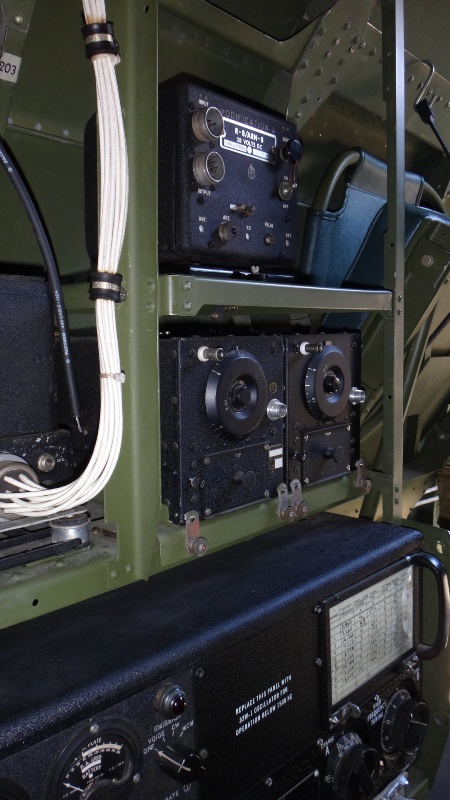

Sometimes I come across a new part that is better that what we may have for the PV-2 which is the case for our ARN-8 Marker Beacon set. The ARN-8 is a simple beacon receiver that is used for navigation especially for instrument landing procedures. A beacon is set up on the ground and sends a radio signal straight up in a fan shaped pattern. They are typically placed along the approach path to the runway. As the aircraft flies over it the signal becomes stronger and it will trip a relay to turn on a light on the pilots panel indicating he is over the beacon and at a specific point near the runway. There is also an audio tone and Morse code signal associated with the different markers on the approach path namely the outer, middle and inner markers.
Even though this system was being put into use through WWII the same system is in use today using the same frequencies and tones.
The ARN-8 that we had in the PV-2 was robbed from one of the Navy Beech 18's we have here until a better one could be found. Mr. Donzelli heard we were looking for a nice one and he offered us one at a decent price. As you can see it looks a lot better than the old one.
Now all we need to do is wire it up, fabricate the wire antenna and hook it up and see if it works. We are almost IFR certified!

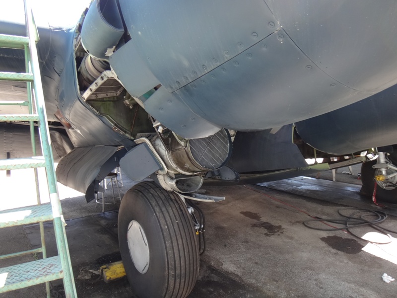

At Reno last year we had a problem with the guys towing the Harpoon into the NAHI event and 062 was damaged when a tow bar was bent, came off and their tug became a wheel chock, or should I say an oil cooler chock, for the Harpoon. It took a while for us to get a new oil cooler scoop and to get it fixed up as a replacement.
Here is Kenny working on removing the bent oil cooler scoop assembly. You can see the dent from where the Harpoon parked on the hood of the tug.
I don't have any photos of the fixed oil cooler scoop going back on as I think I was out of town when the guys installed it. Here is Jordan painting the nose and some other touch up work. Goofy guy!

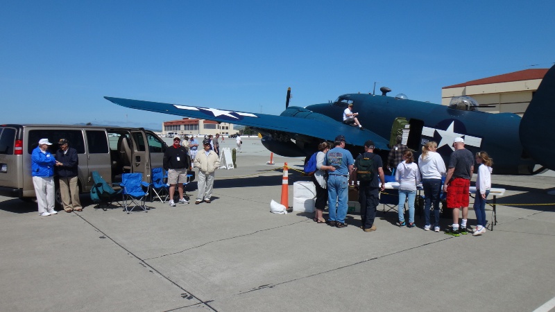

At the show our three WWII vets hung out and talked to the crowd and shared their stories. Their family came along and also enjoyed the show. What a treat to have them with us. This is what it is all about.
After working hard on the Harpoon for quite a while Ricky manned the table to help hock our wares to try and raise some much needed money for the Harpoon.
It was a great show for the PV-2 and our WWII vets.

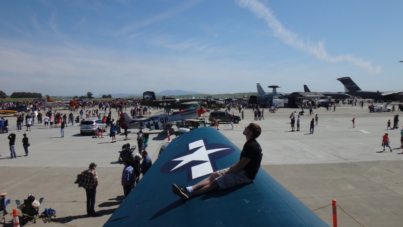

Robin has been working hard on the Harpoon and was able to enjoy the fruits of his labor. His first air show I believe.
