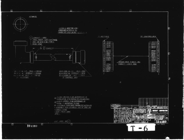

Ricky has been plumbing the auxiliary hydraulic pump so we can cycle the hydraulics without setting up the external pump or mule.
Mark has been wiring up the AIA-2A interphone system. Lots of harnessed to build for that system. Some have 35 pin connectors and can be quite tedious to wire up. Could be worse; it could be the radar system. Speaking of that...
Jon has been getting up to speed on the APS-3 radar system. We are in need of any and all technical manuals and information. Anyone have AN/APS-3 TO's or information or know anyone who might?
I have been assembling the parts list for the connectors we need to make up the harnesses for the radar set. Once we can locate and procure the parts we will start building them.

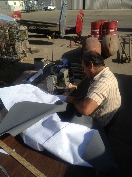

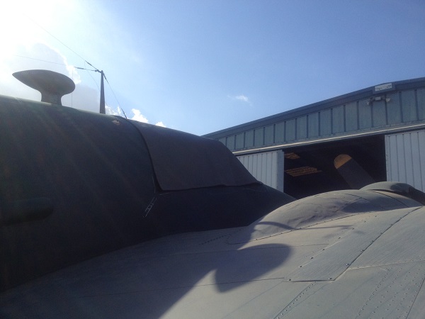

A local upholstery company named Fran's Creative Upholstery was kind enough to come over and make some custom covers to protect the PV-2. They made a cockpit, astrodome and a top turret cover.

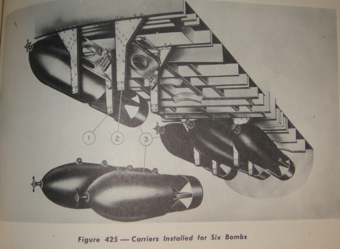

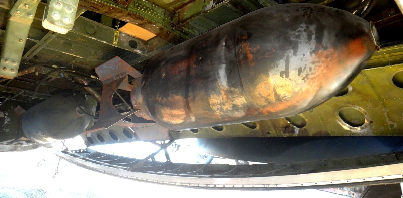

They worked on one of our major projects which is the bomb bay. The bomb bay is pretty much untouched and is in need of a lot of work. We will need to clean up everything, repair some mods and dings to the bomb bay doors, fix up the bomb racks and bombs for display.
We have two 1000 pound GP style bombs in the left stations that were in the middle of getting reworked when we had to throw them in for OSH. We didn't even have time to prime or paint the fins we had made.
The bomb bay can hold six 500 hundred pound or smaller bombs or four 1000 pound bombs.
It can also carry one Mk13 torpedo or two big Tiny Tim rockets. I think a pair of Tiny Tim's would be great for the ultimate lawn dart game! It will be a while before we can get the bomb bay to look like this once again. Man does that look good!

The one project in need of money is for the radar wiring harnesses. We have found a good source of cannon plugs to build the harnesses and each plug will be about $50 each. Here is a typical drawing for one of the harnesses.
At last count we will need about 30 cannon plugs and a lot of the shielded conduit. One quote for the conduit came in at about $5000 so needless to say we are looking for more cost effective options.

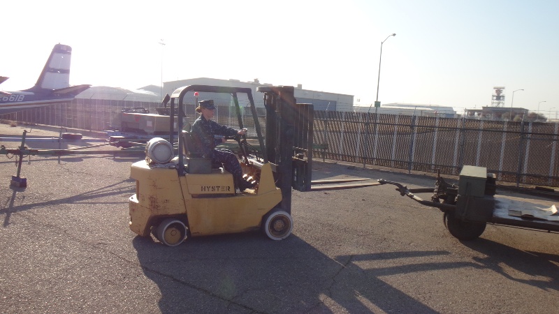

Before Christmas we had a nice visit from the Sea Scouts. These kids are great and they pitched in to help out cleaning up around and on the Harpoon. I sure wish we could get her indoors but that isn't in the cards for the foreseeable future.
Thank you all for your hard work!
Two cadets received their first fork lift lessons.

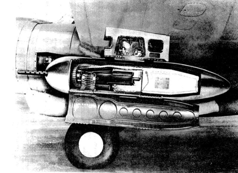

Twin 50 gun pods bringing the 50 cal count to 14 forward firing 50's! Not sure how often it was done as I haven't seen too many photos of them installed but they certainly had the capability.
Thought you all might like this information on the gun pods.
http://www.scribd.com/doc/180556378/Dou ... al-gun-pod
http://www.scribd.com/doc/191570148/Dou ... un-Package

I found a few weeks ago those and they are full of great information. Now I need to find the pods themselves. Anyone have any leads on a set or single pods?
Since the pilot could jettison them if needed not to sure if many of these are about. The Greeks used them in their Civil war after WWII was over on the SB2C. Maybe some of them still floating about over there? Also it looks like the DGP-1 may have been tried out again in the 60's based off of the manual cover picture I posted.
Or something very much like it?
I don't have that manual the link I found it on is posted below.
http://www.machinegunboards.com/forums/ ... opic=12895
