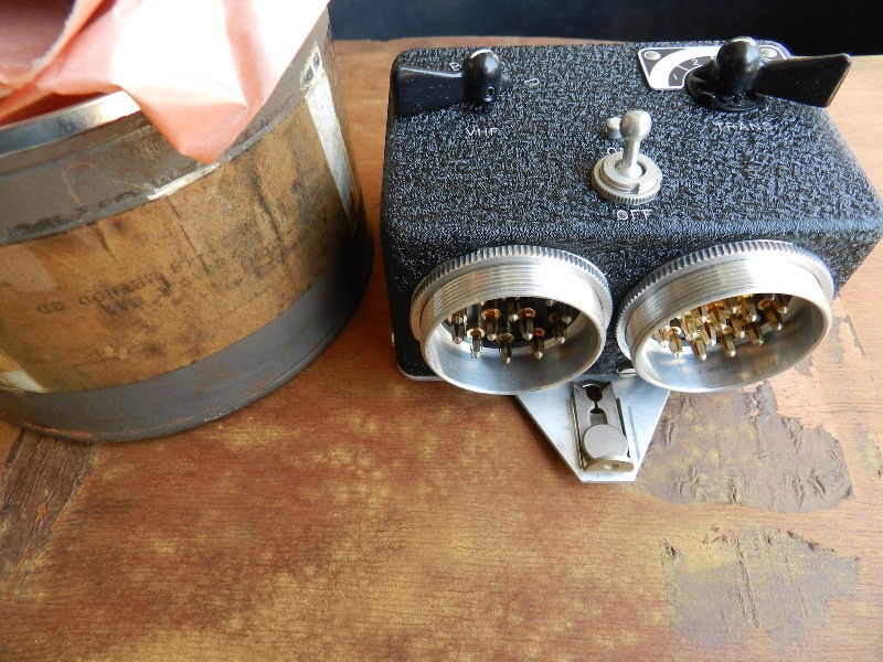

I found another one of the missing control boxes for the Harpoon namely the C-30A/ARC-5 on eBay over the weekend. The seller was kind enough to set up a buy it now for us to get it at a greatly reduced price. It is amazing how much some of this gear is going for between collectors and restorers. This one was real nice since it was still sealed in the can and is in near perfect shape. It is the box that mounts over the copilots head and controls the transmitters of the ARC-5 command set. What makes this one special is that it controlled the VHF transmitter and by default the VHF receiver too. This control could switch between the four crystal controlled VHF channels.
The old style C-30 was a push button style box that was replaced later in the War with the more reliable rotary switch C-30A control which is also appropriate for our PV-2D. While the C-30 is more common and Jay Wisler has them new in the box, the C-30A's are a bit hard to find so we are lucky to have found such a beautiful example. Great thanks also go to the seller for his generosity especially when he could have sold this for a lot more. Like three times more :shock:
Gotta love black wrinkle finish especially 60+ year old black wrinkle finish!

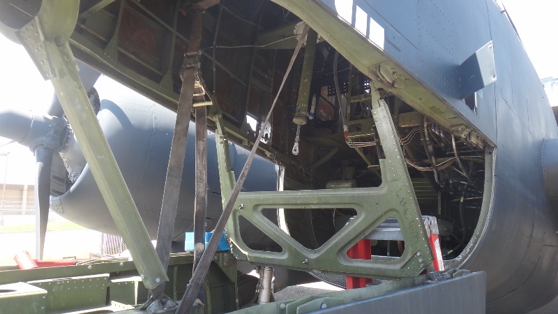

We happen to have two extra retract cylinders from a D model gun nose PV-2 so Ricky and Andrew opened one up and replaced the O rings inside with fresh parts. Here is Andrew removing the cap from the cylinder that was put there in 1947 according to the tag.
The old cylinder is removed and Andrew learns about cotter pins and castle nuts and box-open end wrenches.
The nose is supported so the cylinder can come out
Yes, it is that much fun to work on 062!

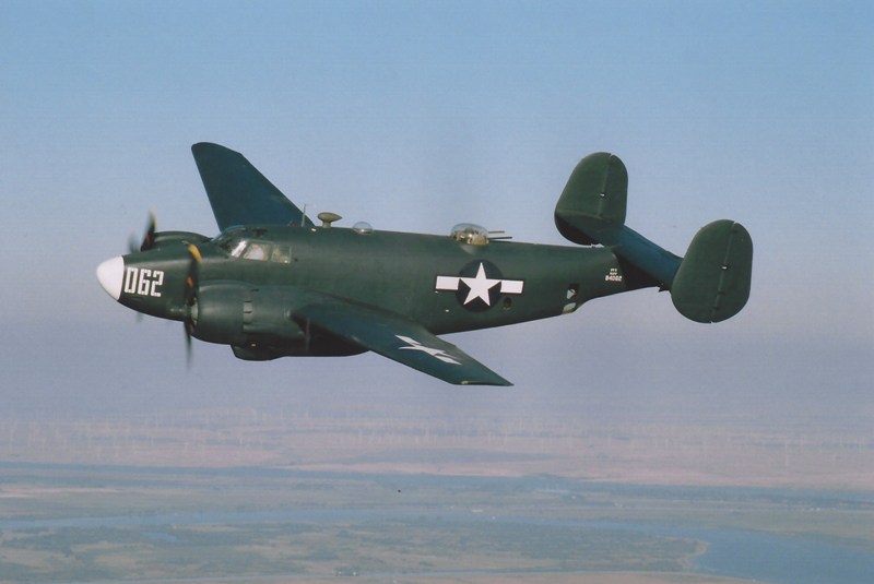

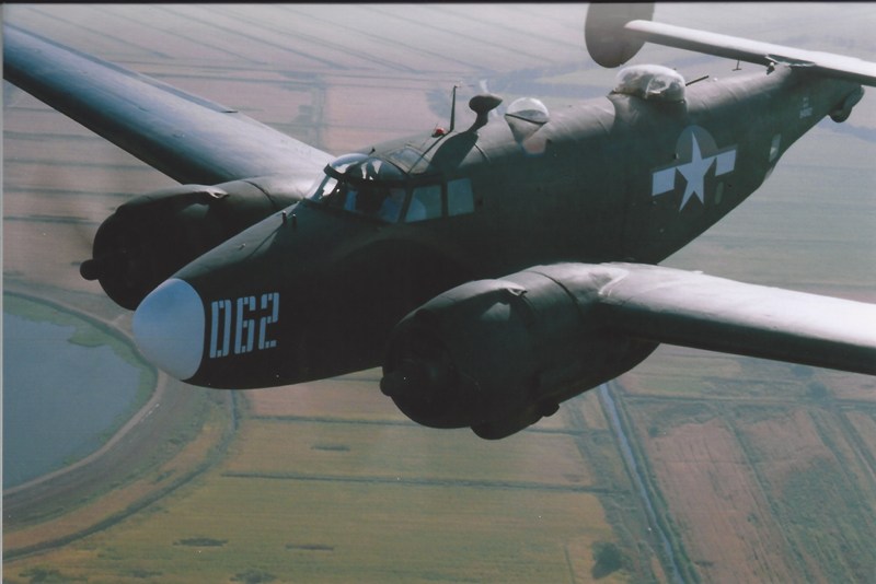

Here are some photos taken on the way to the Nut Tree show last year. You can see our tail wheel that was a little too shy to be fully tucked away up in its well. Maybe it was just not used to the dark?
These great shots were taken by Eric Preston. Thanks for the prints Eric. These shots also show what the trip will be like on the way to OSH. Let's go!

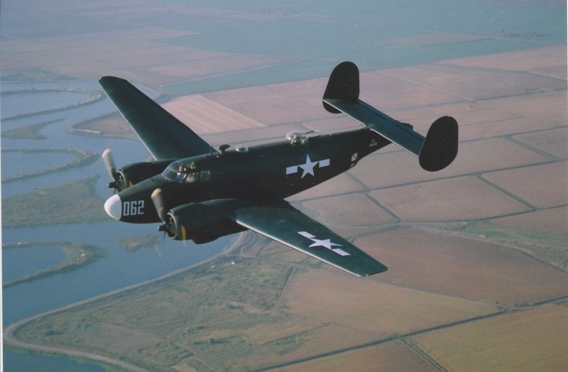

We painted the Harpoon in accordance with the period specs from the Navy SR-2 which called for the horizontal surfaces of the wings and horizontal stabilizer to be painted semi gloss and the other surfaces to be painted lusterless or flat. This shot shows that we achieved the specified finish. Check out the slight semi gloss sheen on the wings and horizontal and yet the fuselage and nacelles are nice and flat. Pretty cool!

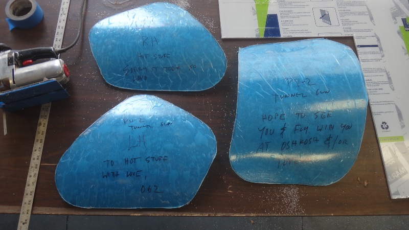

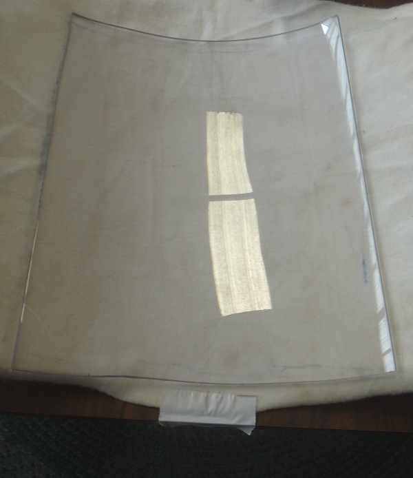

To our Friends of the Hot Stuff crew. I am so sorry it took so long for me to crank this stuff out for you but I am almost there. I made the three of the four tunnel gun glass that you asked for. I ran out of polycarbonate and TAP plastics is closed on Sundays. Ill pick up some more tomorrow and make the last pane.
Just for proof here is a shot of the three I just finished.
Made with the royal blue tint just as you ordered!
My plexiglas disclaimer: The mold was made to the glass that came from our PV-2 and it fit our bird well. It should be the same as yours but will likely need some trimming to fit your frames. There also may be curvature issues that should not be a problem but if it is let me know and I will make it right. I held them up to the glass on our tunner gun area and the contours seem right so I will keep my fingers crossed.
Once again I am sorry this has taken so long to make this for you. I have not been able to work on our Harpoon for a long time due to pressing business crud so it was very nice to have a Harpoon weekend. It was long overdue.

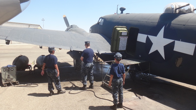

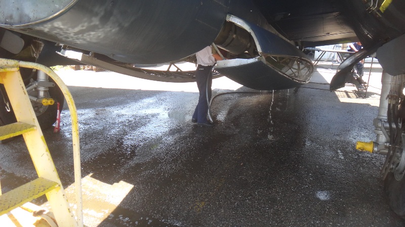

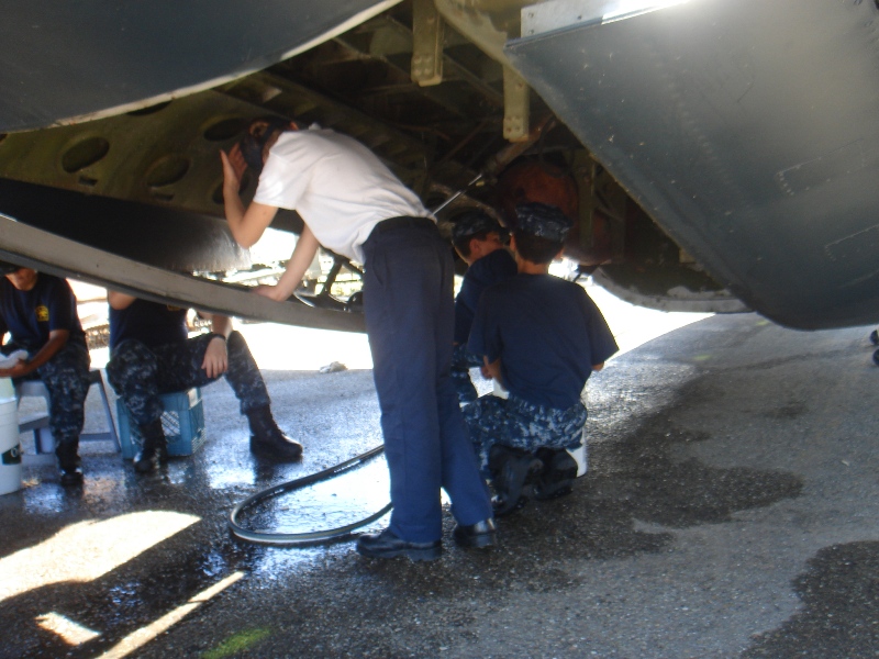

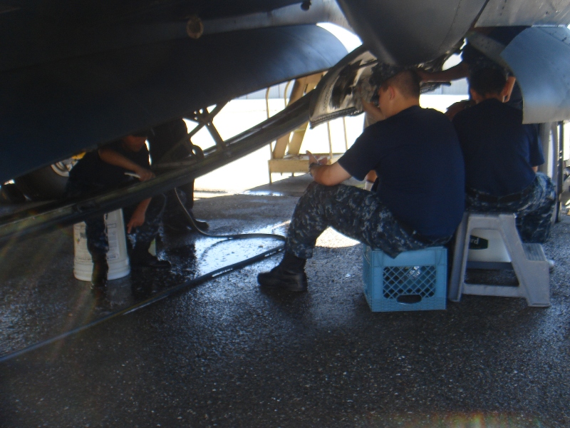

The Sea Scouts showed up in force and helped to clean the landing gear wells and bomb bay.
Thanks guys and gal for helping to fix up 062. You all did a great job.

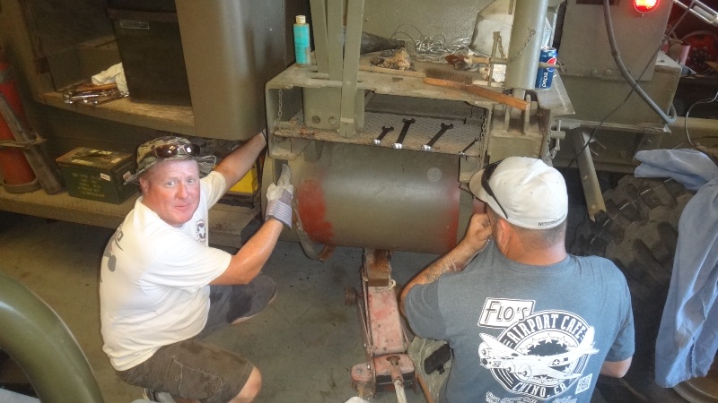

Ken shows up with a relative named Danny. Danny is a diesel machanic and although he was there to work on the PV-2 he gravitated toward the AAF C-2 Wrecker truck.

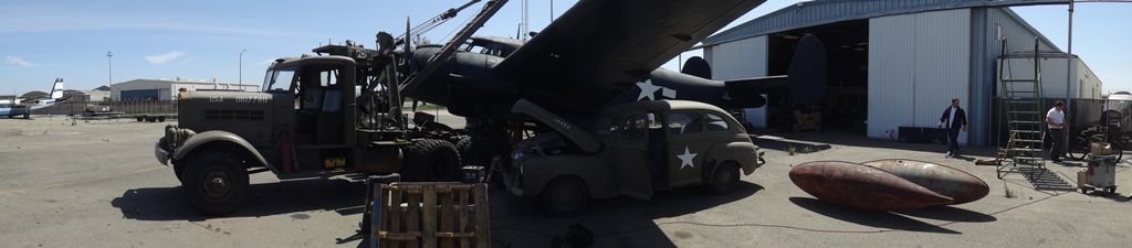

The wrecker truck has been a bit sickly lately like it was starving for fuel. I cleaned the carb bowl and fuel strainer and saw some strange looking fibers. I checked the fuel tank (one of two 50 gallon tanks!) and I found something in the bottom of the tank. It turns out that a long time ago someone had dropped a rubber radiator like hose in the tank and it was all swollen up and falling apart. When I tried to remove it it just disintegrated so the tank needed to come out to turn it over and flush it out. Danny did just that and got her all fixed up.
Here is Ken and Danny fixing the tank which is important because we are going to need to use the wrecker truck to lift the tail of the Harpoon. Well done guys!

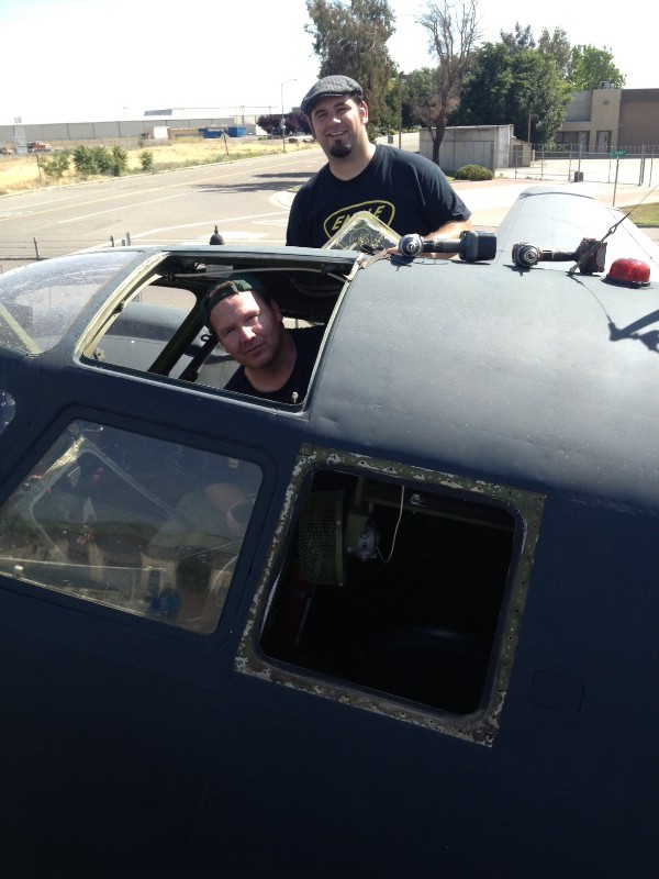

Then Matthew and Roland came by again. Now we certainly like volunteers but we especially like volunteers that keep coming back!
Matt and Roland started up where they left off by working on the fixed glass on the sides of the cockpit/radio room. They removed the old glass and frames then cleaned and primed the inside of the frames and wells. I made new glass for them and we installed the left side glass. Hopefully my daughter and I will finish the right side tonight.

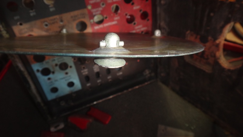

On Sunday I was here alone tinkering on the Harpoon. It was one of those rare days where I am not running around providing tech support and help to the masses working. Nice and quiet, enjoying another great episode of Car Talk, and working on whatever comes to mind. One of the projects of the day was to replace the worn out Airloc fasteners found on the oil cap covers and other access panels. Lots of Dzus fasteners all over this Lockheed and a bunch of Airloc too.

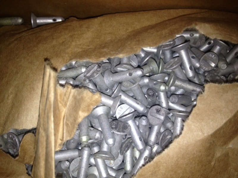

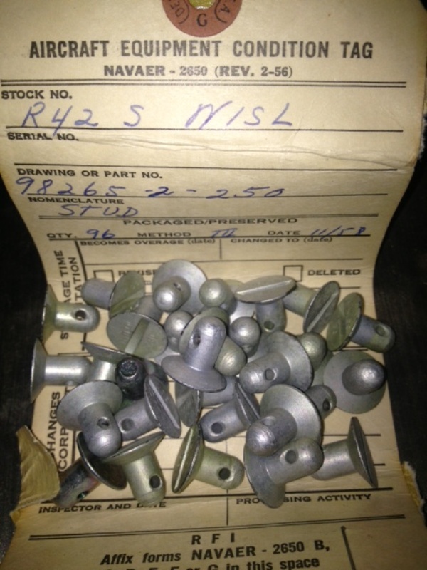

I was lucky as I found a cool stash of Airloc fasteners of all of the sizes I needed for an awesome price. Pins too! AC Spruce sells the pins (milspec made) for almost a buck a piece! The studs are 4 to $7 each too but are new production stainless steel.
The fasteners I found are actually Lockheed surplus dated 1958 (the same year our Harpoon was sold as surplus) from an old Navy contract. too cool finding new old stock hardware, made for Lockheed and at a great price. Your donation money is being well spent!
Here is one access panel with the new fasteners installed

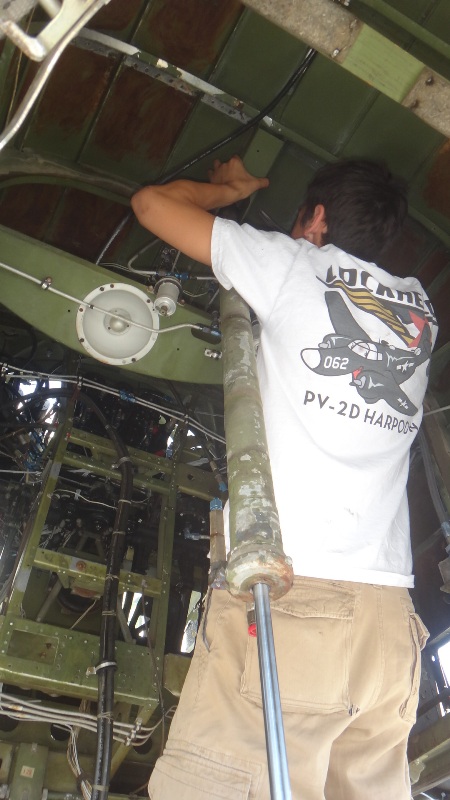

Speaking of volunteers coming back guess who just walked in the door? Dick, our newest bestest electrical guy! Outstanding as this means we didn't chase him off last saturday!

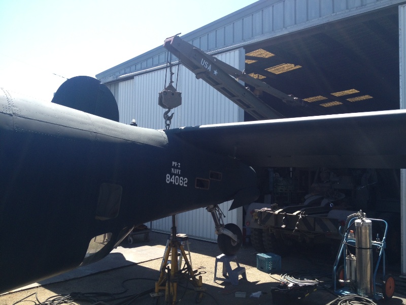

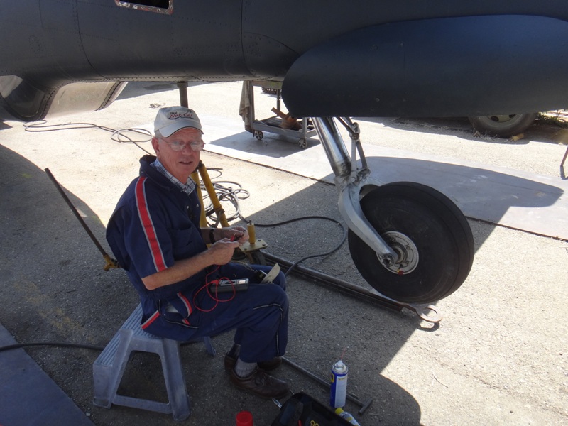

Dick got back to work on the tail gear limit switch and selsyn troubleshooting. last Saturday he replaced a bad up indicator switch and today it looks like the down limit switch is working but the selsyn appears to be inop.
The gear and flap indicator system uses a selsyn to indicate the sweep or actual position of each landing gear and the flaps while they are in transit. For the gear system when the main or tail gear are in the up or down and locked position a microswitch is depressed and the indicator in the instrument moves to the extreme position indication either fully up or down. The tail gear up and down switches work but the position in between is not working. A new selsyn was ordered and will be here tomorrow.
Here is a shot (without Dick) of the tail hoisted up by the wrecker truck and with a tripod jack in place for safety.
Dick is also coming back on Wednesday. I am giddy about having a regular electrical guy around. Any regular help is wonderous!

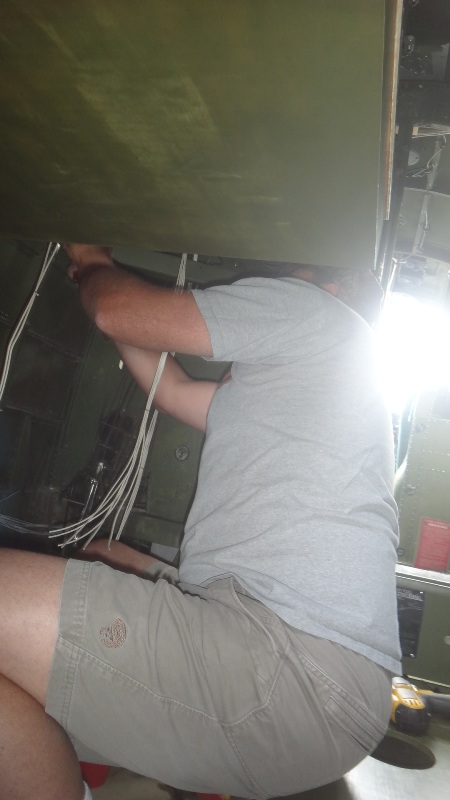

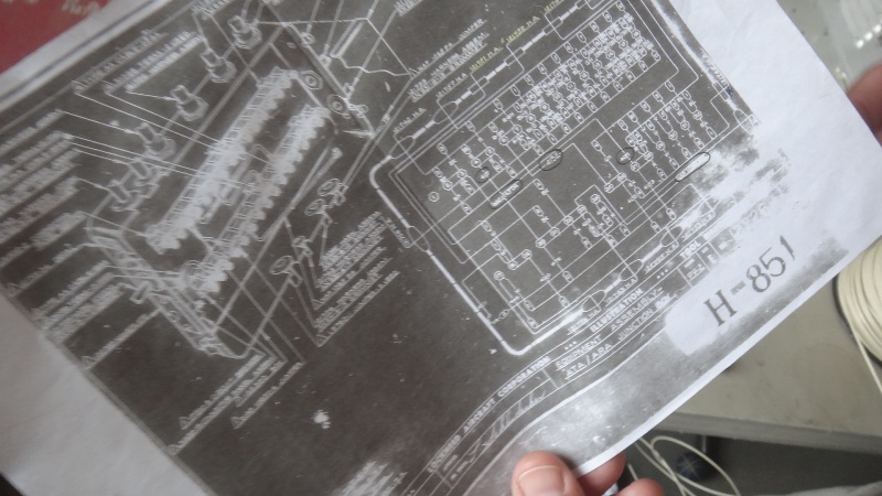

Radio Mark has been wiring up the ARC-5 set. Lots of wiring and fabrication of the junction boxes. Here he is under the nav station where the ARC-5 main J box resides
The drawing of the J box and the wiring needed to make it work
Here is Dick finishing up the tail gear position and limit switch rework. We had a bad position transmitter and switch so we found replacements and Dick fixed it right up. It works beautifully now.

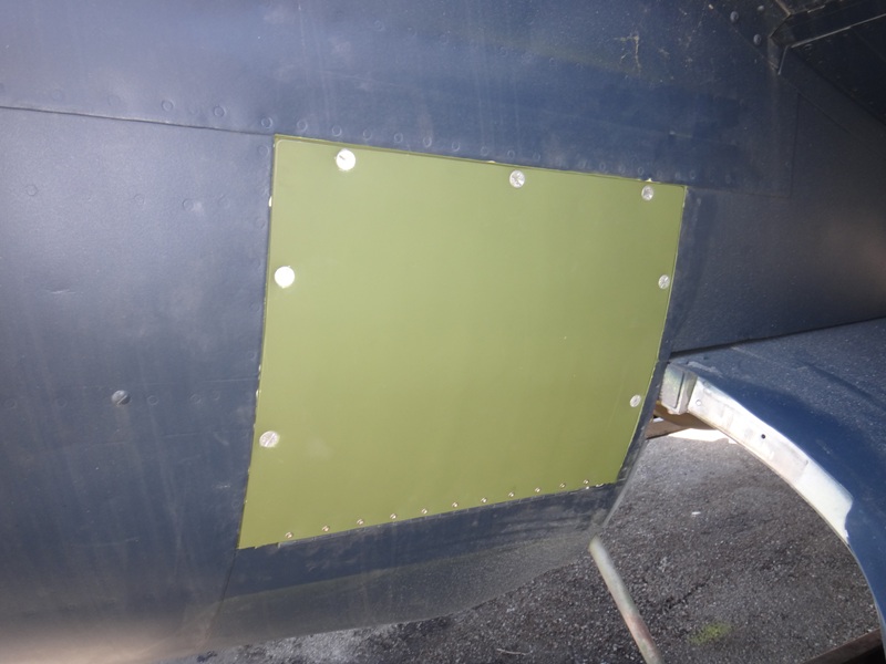

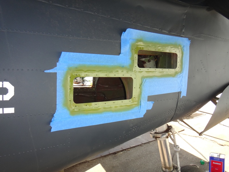

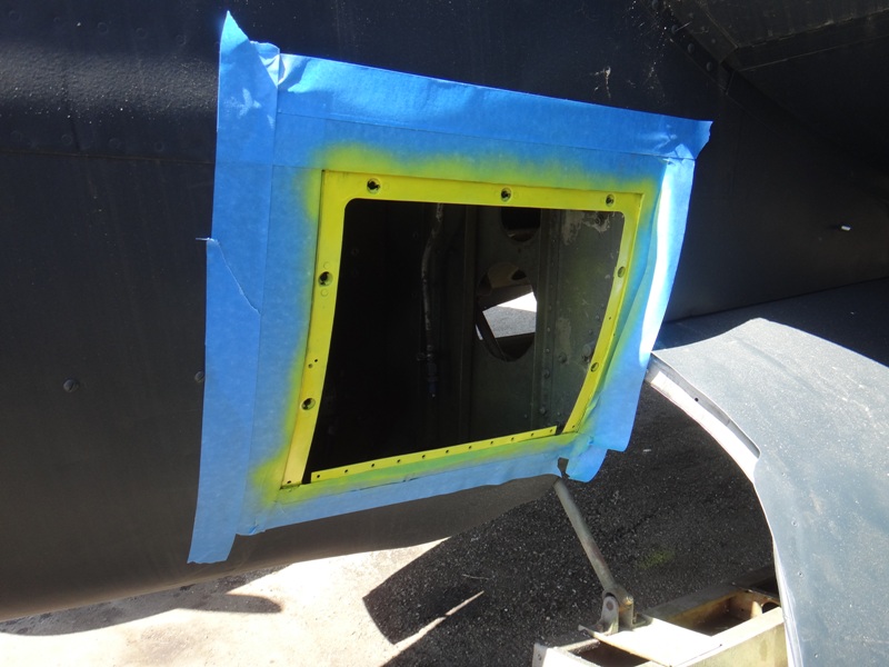

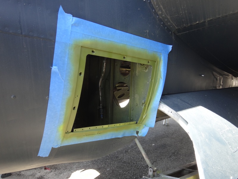

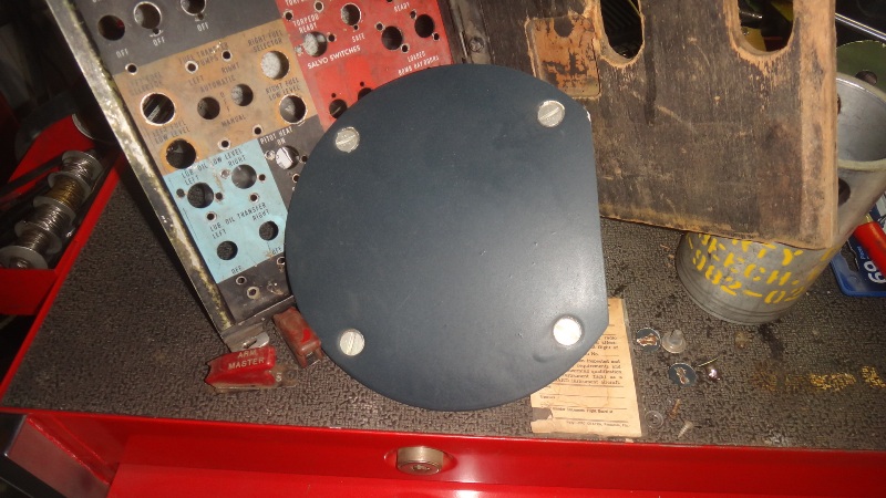

There is an inspection door on the left side of the nose under the cockpit that had been modified back in the early tanker days. The first retardant tank installed had cut across this panel and they installed a hinge in the middle so they could get to the accumulators. I made a new panel for it when I was replacing the Airloc fasteners and cleaned and painted the wells. We should have cleaned all of the areas under all of the inspection panels before we painted the aircraft but time constraints didn't allow for the perfect painting scenario. As with the rest of the project as the need arises the various areas receive the attention.

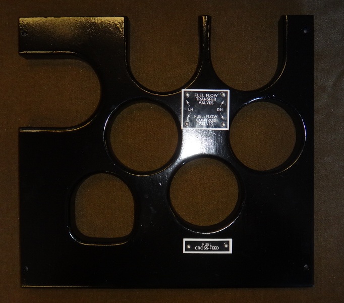

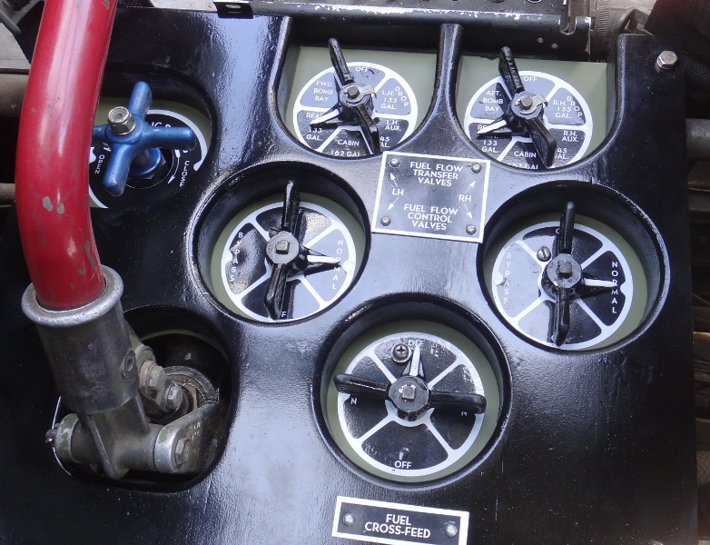

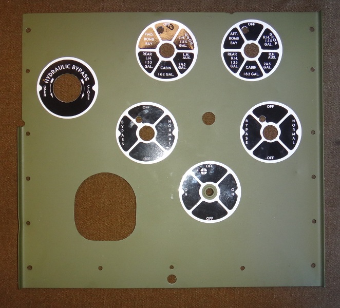

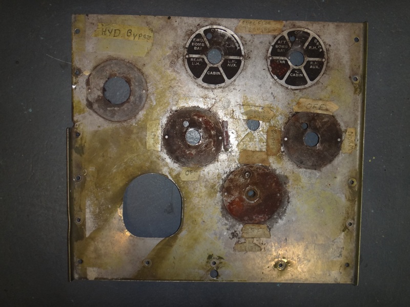

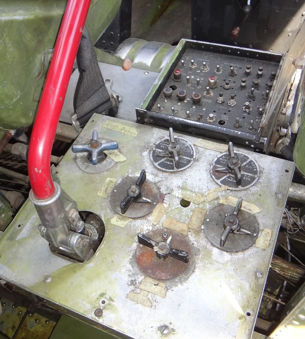

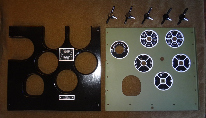

Next was the fuel control panel. The placards are long gone and as you can see the whole thing needed a serious makeover.
My wonderfully talented daughter Maggie does the artwork and can take any placard and put it in the computer. Once the artwork and separations are done we have a few choices for reproduction. The originals are chemically etched metal placards and we will do that someday when I can justify the expenditure. For now we will have to do with a decal. It gets the job done anyway.
As you can see I altered the placards to include the fuel quantities. The blueprints showed the quantities which I liked even though our original placards didn't have them. Another gross deviation!
A few more clips are needed for the fuel valve handles as a few were broken.
As our motto goes: You should have seen it before we started...

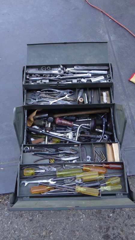

The Arizona gang wanted to pitch in on the Harpoon so they did just that. Here are Scott and Mark (fellow WIXer's) who are fixing up the tail gear. They have taken apart the collar where the upper fork attaches and they replaced the bushing and adjusted it. They also fixed the tail wheel lock mechanism so it works great. Well done guys!
Check out Scott's awesome tool box. It is a work of art in my book
Then we did a full gear swing to be sure the tail gear worked with the rest of the system and it did.

I didn't get any good shots of the flight or the Harpoon out on the ramp looking good. Oh well, next time.
